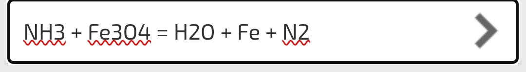

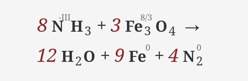

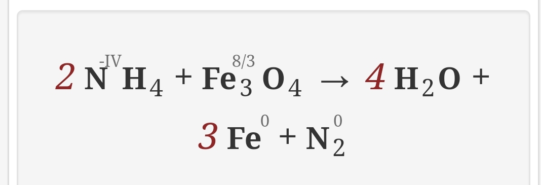

This is an oxidation-reduction (redox) reaction:
View attachment 425083 View attachment 425084 View attachment 425085
There is also a second component, the sodium petroleum salt of sulfonic acid (a strong acid, like sulfuric acid) + its dissociation. I noticed the formation of free iron ions recovered from rust; it is easier to react with them than with a monolithic iron alloy. Interesting reactions occur in this compote, but the school chemistry course ended too long ago.And what happens to the phosphate ions? In the water, the phosphate ions are effectively forming phosphoric acid. I would expect that they would react with the surface of the steel to form an insoluble layer of metal phosphate.
