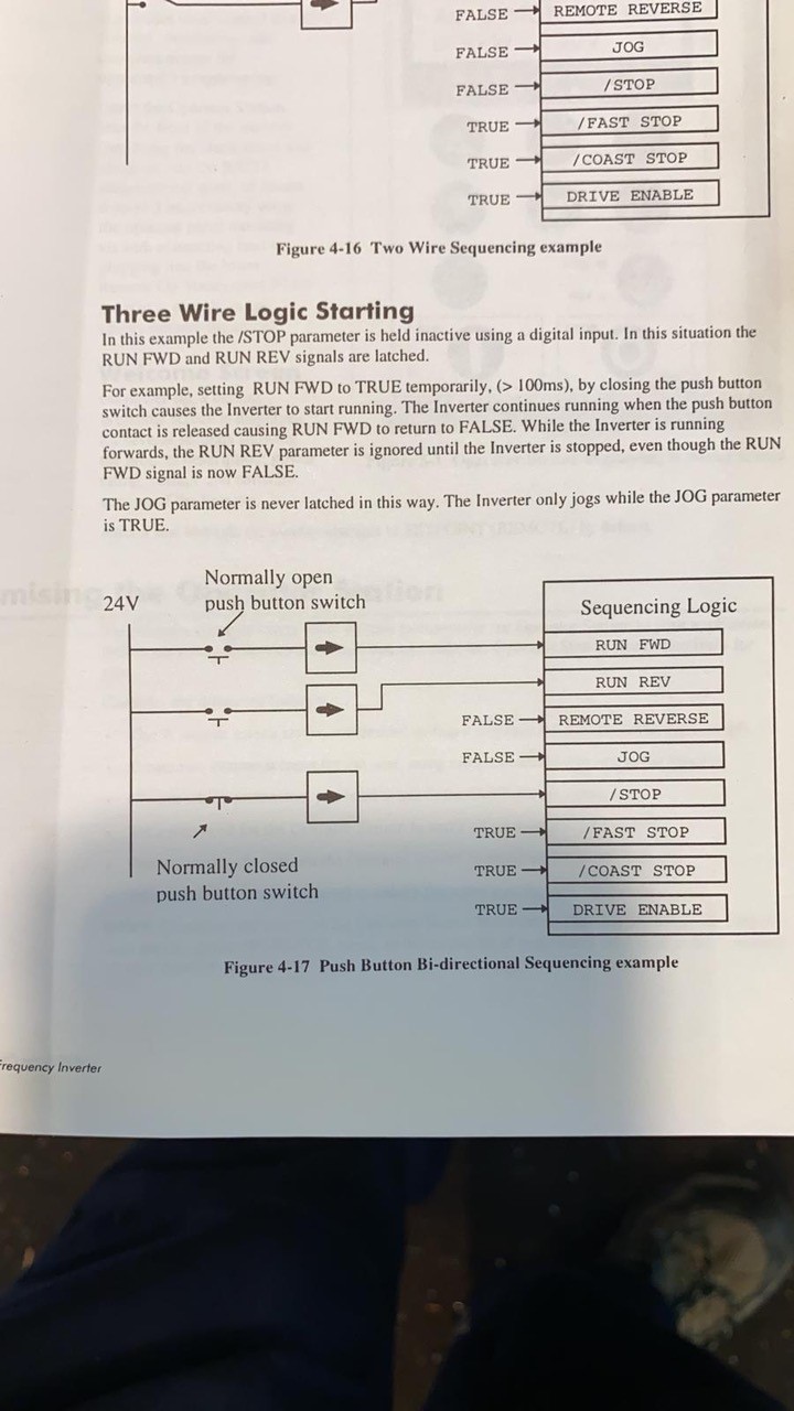

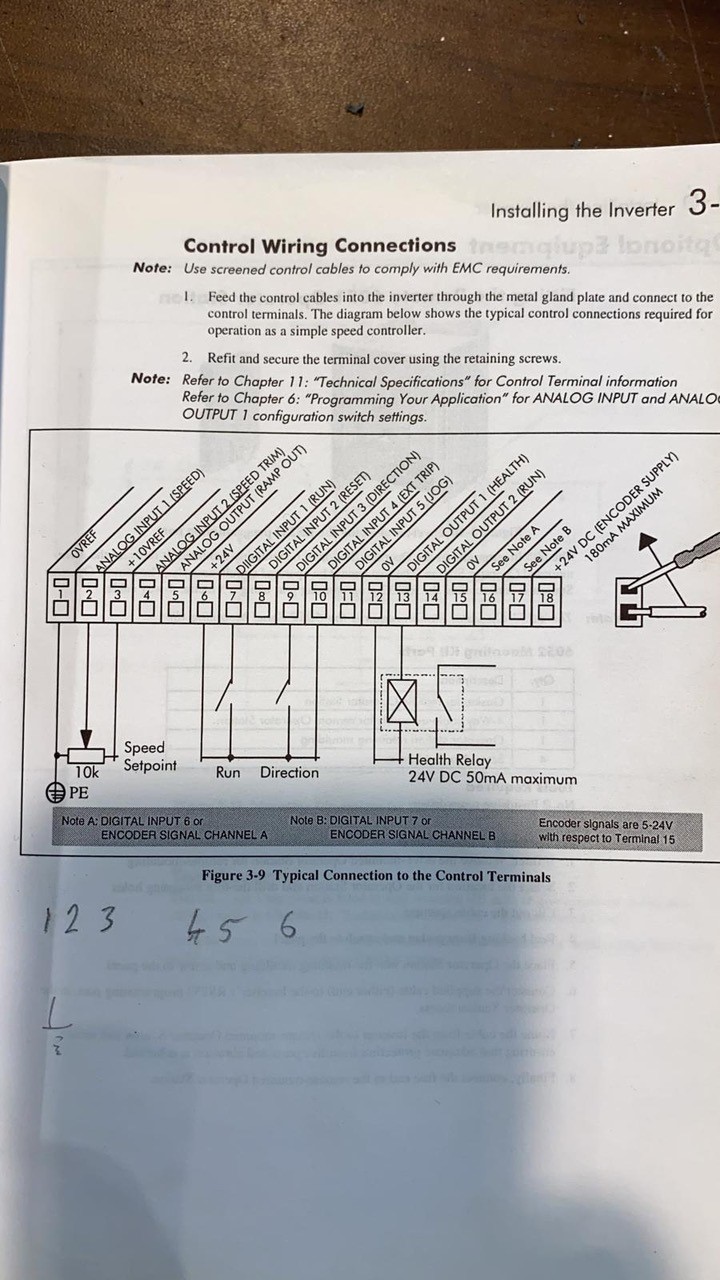

Has anyone here any experience with a Eurotherm 605 inverter?
I got one with my mill and it was setup to use the original swith on the mill, which wasn't done that well.
So I've sorted a little push button station for it, when I changed the settings for it to accept a pulsed input rather than a latched input as it was previously then I can't work out how to stop it. There is a vaque suggestion in the manual that its possible but it doesn't give any clue about which digital input the stop button should be on.
I thought it would be the external trip on pin 10 but that doesn't seem to make any difference.
I've tried contacting Eurotherm, they no longer support it, I've tried contacting a couple of UK distributors for Parker who took over Eurotherm, they can't help either.
Any ideas?
