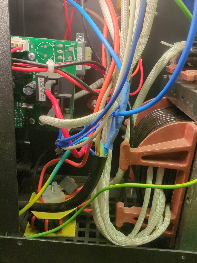

Any one no how to wire the gas solenoid valve got earth to earth blue go to neutral brown ???

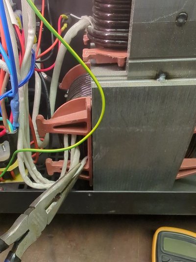

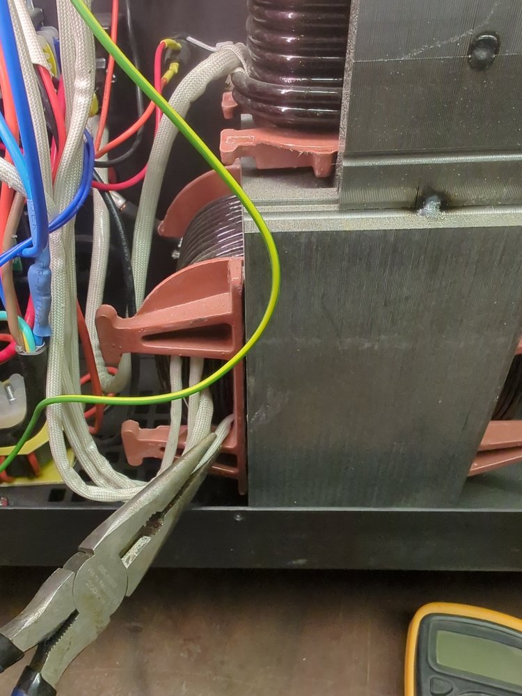

Hi it's a sealey supermig 150.one guy said to me to take the switch wire from the heat shield wire coming from PCB board that goes to the picture with the long nose pliersHello and welcome to the Forum.
It sounds like you are trying to add a mains-powered gas solenoid?
( Other solenoid voltages are available, such as 12v, 24v, and DC as well as AC ).
You have connected E and N and need to know where to get the active L power from?
Basically, that will come from the same place as the main welding transformer gets it's power, when enabled by pressing the torch trigger switch. However, to state an exact location, we need to know the make and model of your ( 150 Amp ? ) MIG welder, then we can hopefully find a circuit diagram for it.

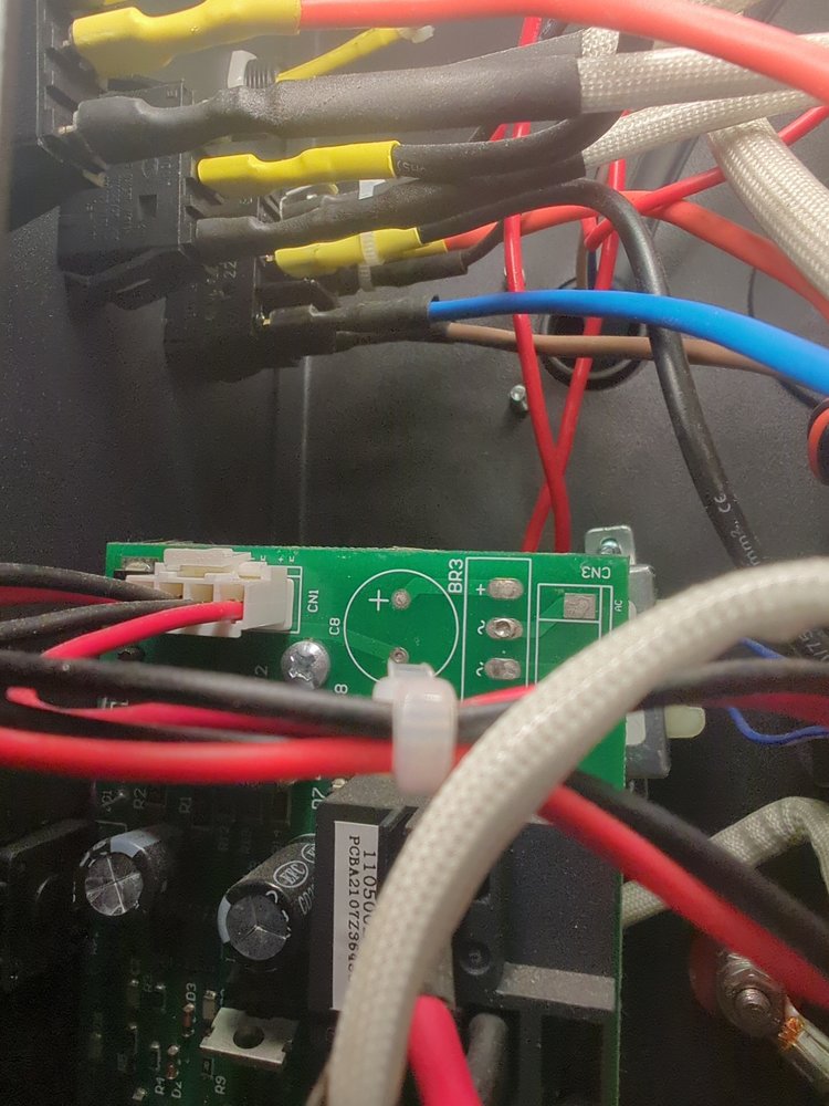

I brought a whole euro torch conversion and was supplied a 240v valve it did come with instructions but for the V2 version mine is a V3 modelThis is the inside of my welder
View attachment 424684 View attachment 424685 View attachment 424686 View attachment 424687 View attachment 424688 View attachment 424735
Yes, I think that is the correct wire.This is the inside of my welder
