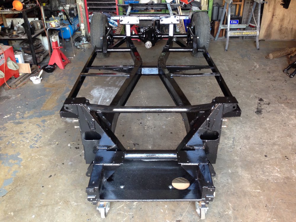

Evening all
I'm planning on painting the galvanised chassis I have just bought for my Land Rover. The plan at the moment is to use Mordant solution over the galv, then Jotamastic 90 epoxy primer , then stone chip over that. However, I'm wondering if I should use etch primer between the mordant and the Jotamastic. If so, does anyone have any recommendations?
Thanks
Andrew
