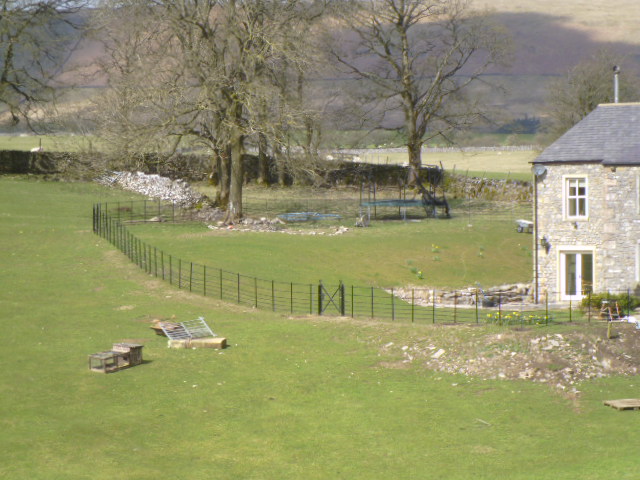

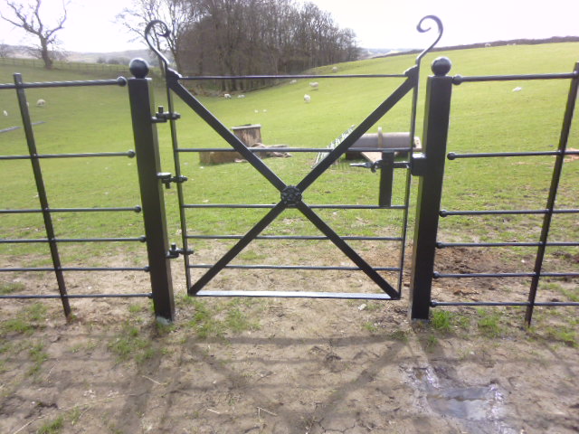

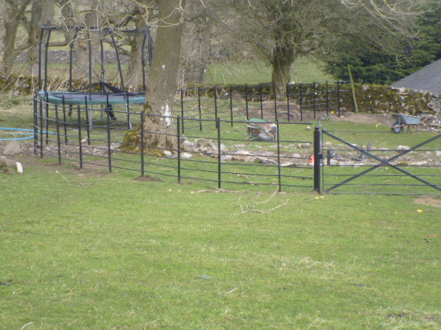

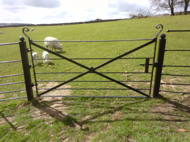

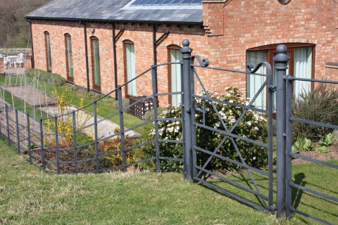

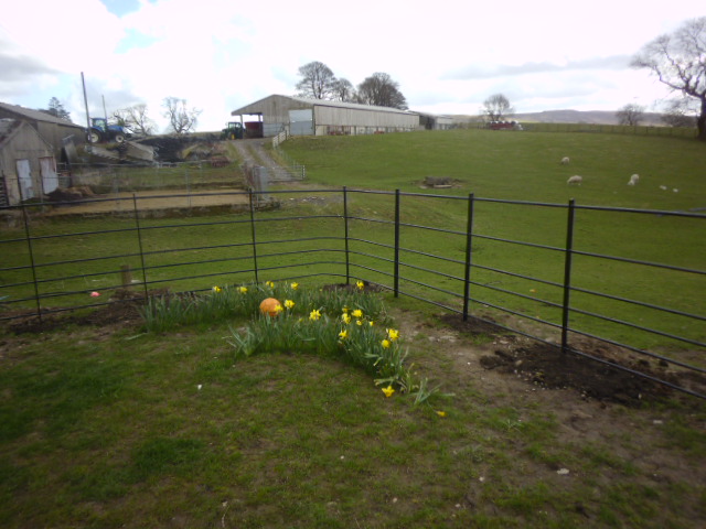

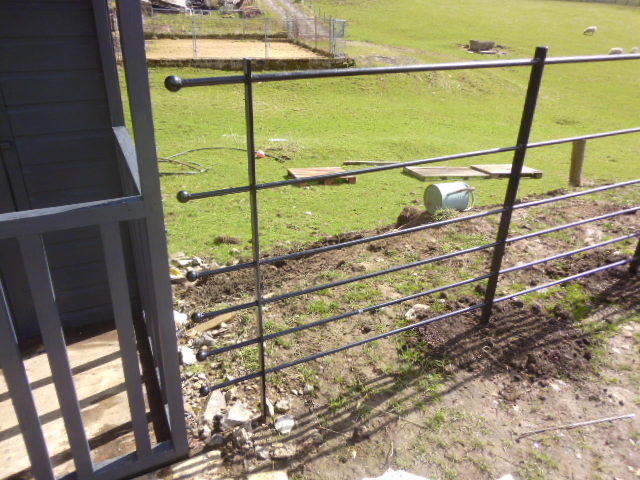

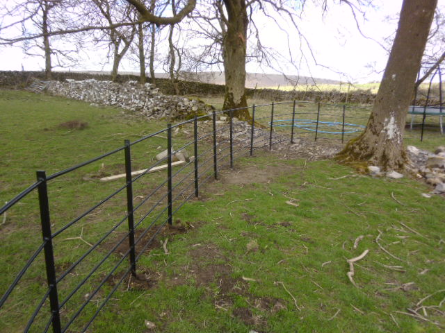

A few estate railings i have made have been plasma cut for 25x5 flat to run through.
I had to start with a drilled pilot hole then a little jig to run the torch around in....the uprights were 50x10.

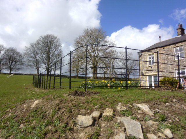

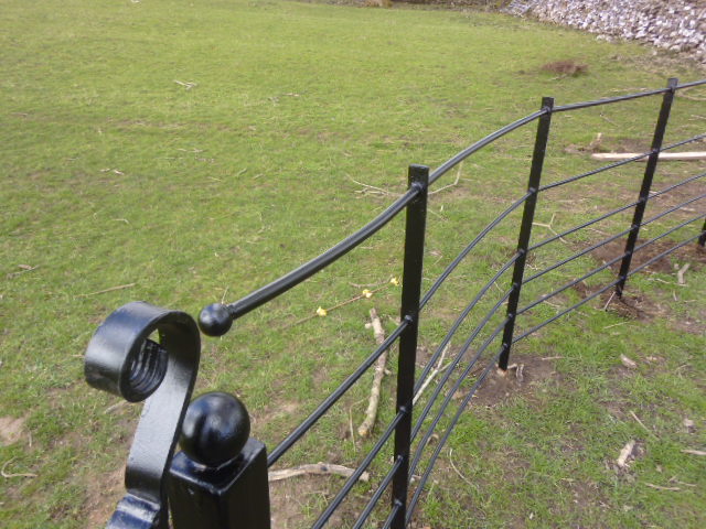

I'd always taken "Cheshire Rails" to be curved backwards at the top - there's a few properties around here that still have them against the road, and they seem to be that shape, kind of an inverted J-shape to the posts.
