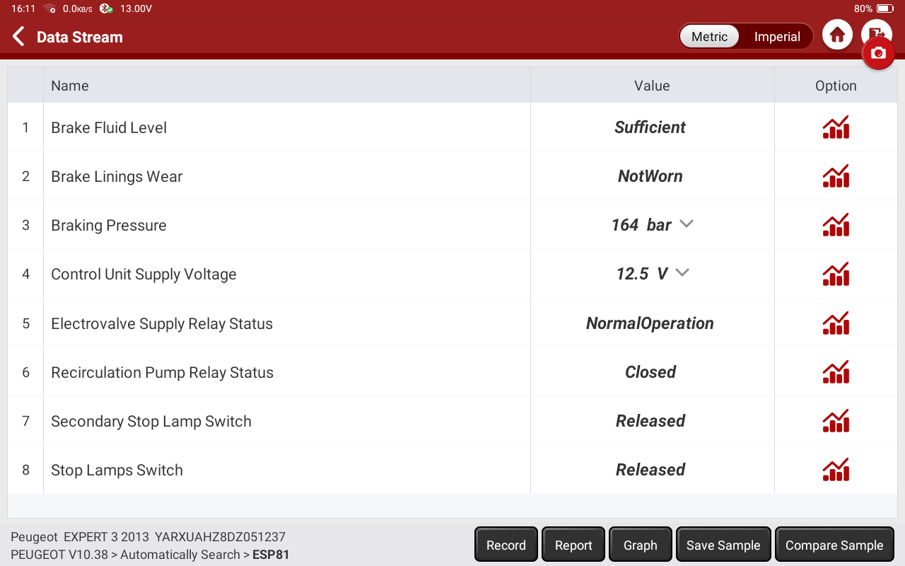

does say at the bottem it should be 0 at start but not clear where is the switch on the pedel or the abs unit that starts at 0I don't think so (but could be wrong). Have a look here, might give you somewhere to start.
Fault code C1301 on Peugeot and Citroën: Coherence between brake pedal switch and pressure sensor - ACTRONICS LTD
Trouble with the fault code C1301? Would you like to know more about this fault code? Read more>www.actronics.co.uk
