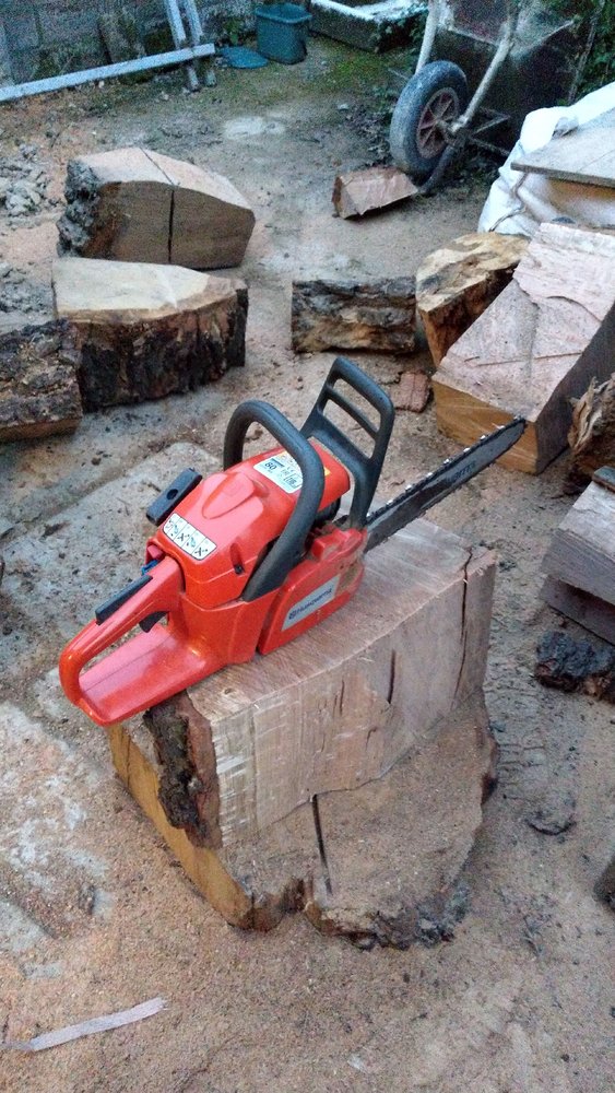

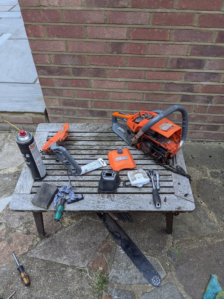

Nope I've never heard of them either but I've been given one to get running for some scrub/small tree removal work at the weekend, rather knacker this than the Husqvarna's cutting at low level.
No before pictures as I couldn't resist ripping into it

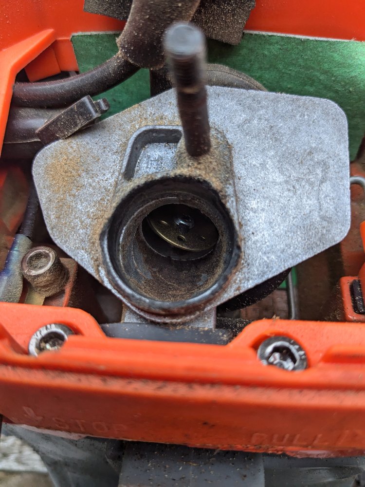

The exhaust was missing a nut and it was very noisy, the air filter seems to have done nothing and lots of screws and bolts were loose, it's not done much work either!

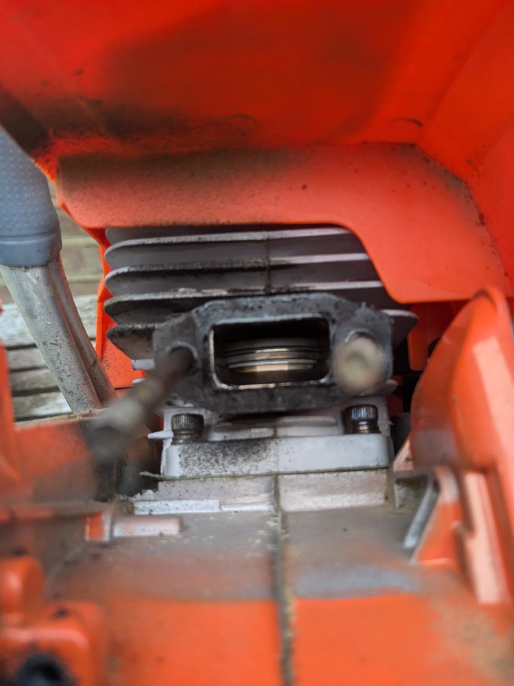

The piston looks good but the exhaust gasket had a lump missing so I had a look through my stash of spares and found an old Stihl saw gasket that fitted straight on, hmmm I wonder what saw they copied???
I cleaned the filter as best I could and added an O ring to the stub to try to seal it better.

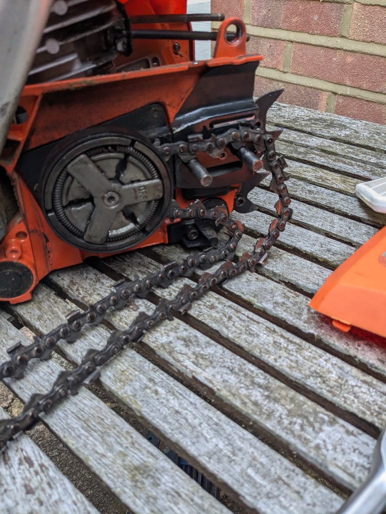

The bar was badly gunked up and the chain was bone dry, so I cleaned that all out and reassembled.
It fired up easily and ran ok but no oil came through to the chain so I'm not sure what's wrong here but it's too late to keep playing apparently
The chain is knackered but I'll give it a lick with the files and see how it goes.
