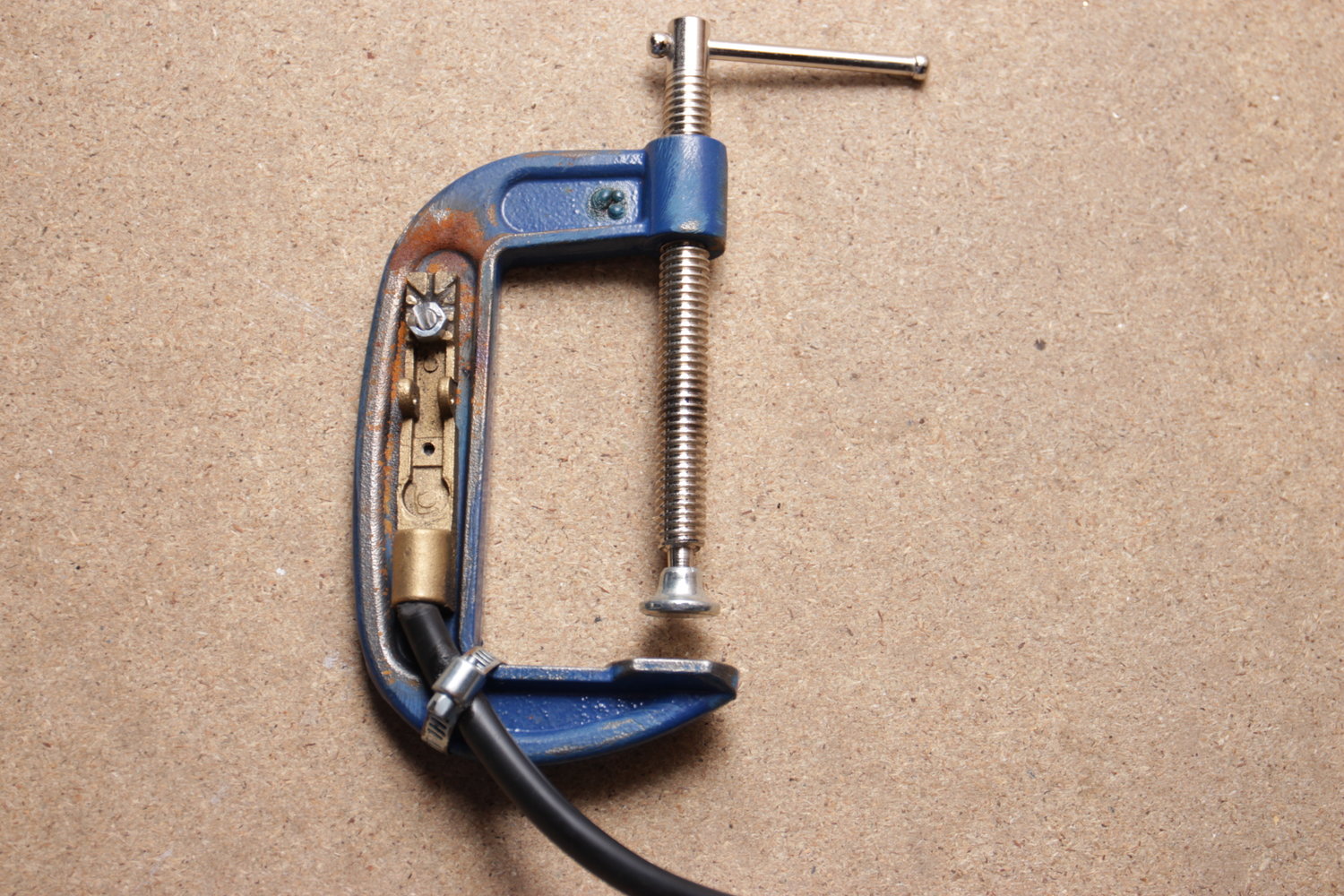

Before buying a brass clamp off eBay for about £20 like this...
(really like it - seems solid to me)

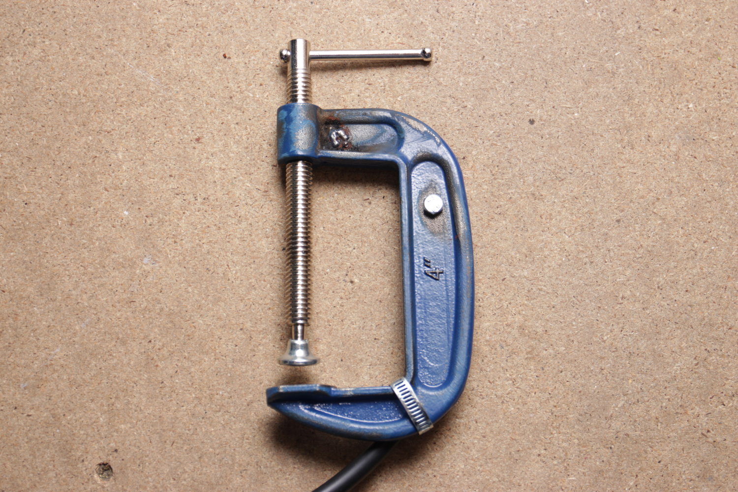

I made my own. Works quite well surprisingly...
I just tapped a hole in a cheap 4" G clamp and used part of an electrode holder (one of those dirty cheap/always included in Chinese stick welders) that I had lying around. Jubilee clip is my strain relief
