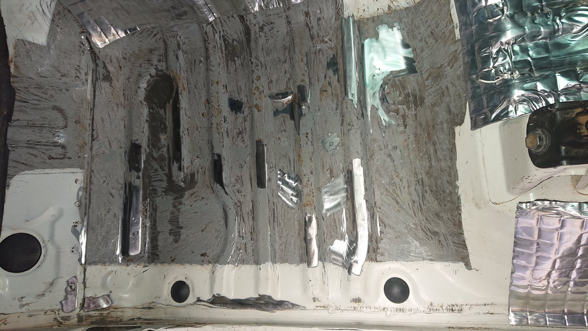

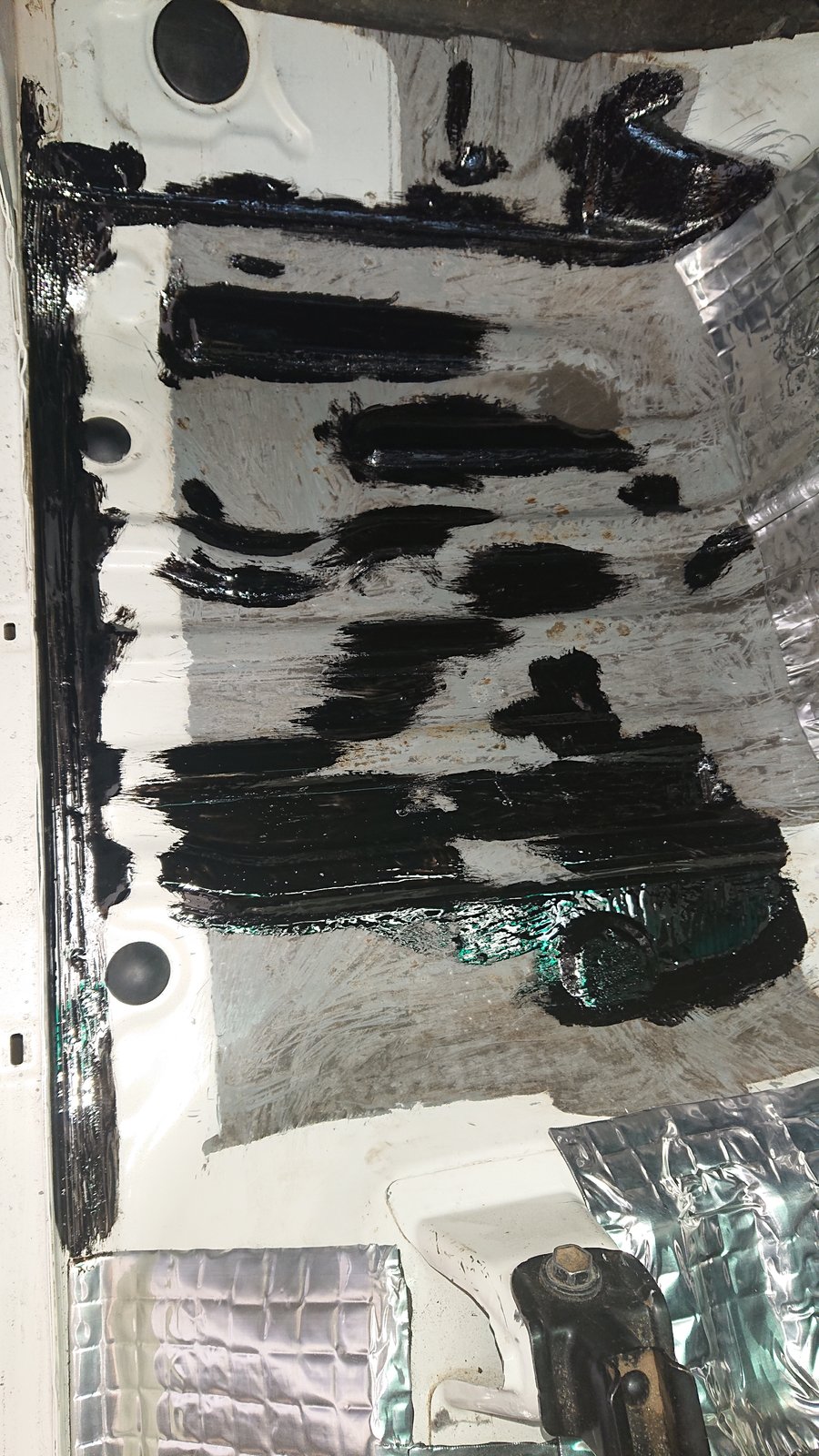

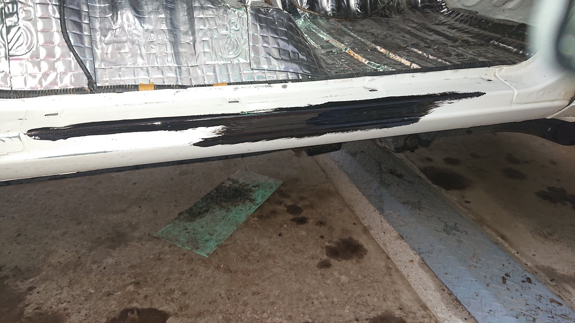

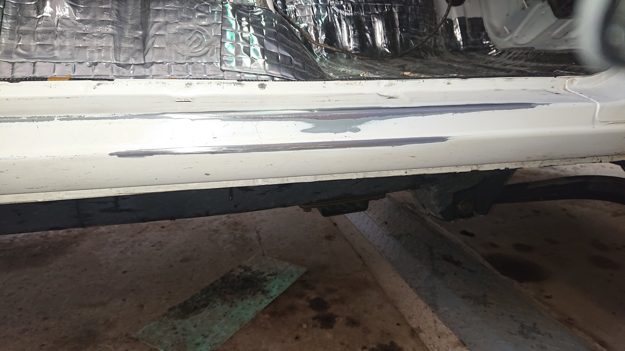

I do wire wheel...then 1pack converter (dinitrol) which stays on....then epoxy.
But that's the whole job...I don't know about patch repairs unless you know it's already epoxy on there.
Dinitrol do a chassis/arch wax which is quite good... not a mess....solvents will get it off when time comes (it's not like waxoyl)
Bare steel epoxy...you'll need a very good key otherwise it'll stick like POR15!
