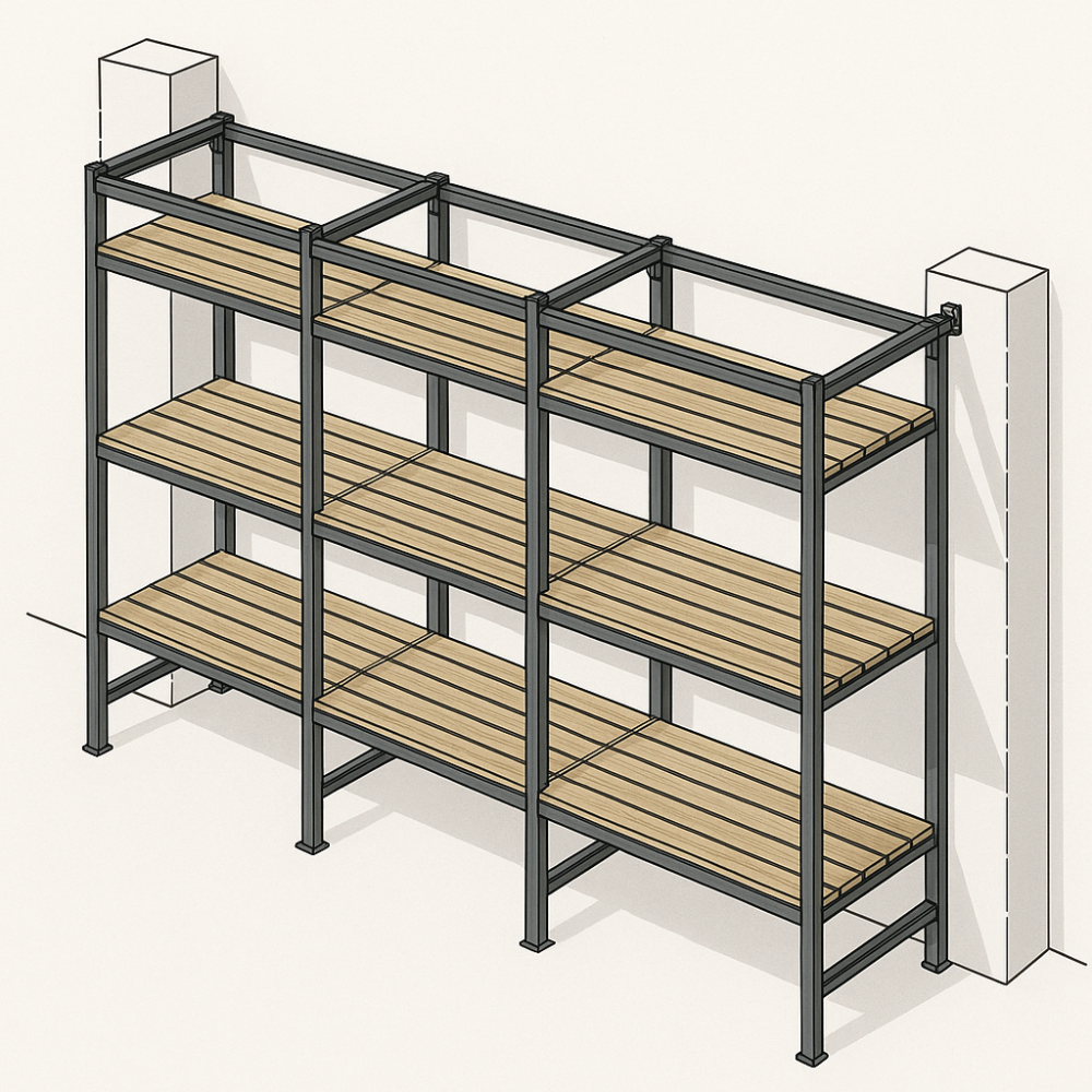

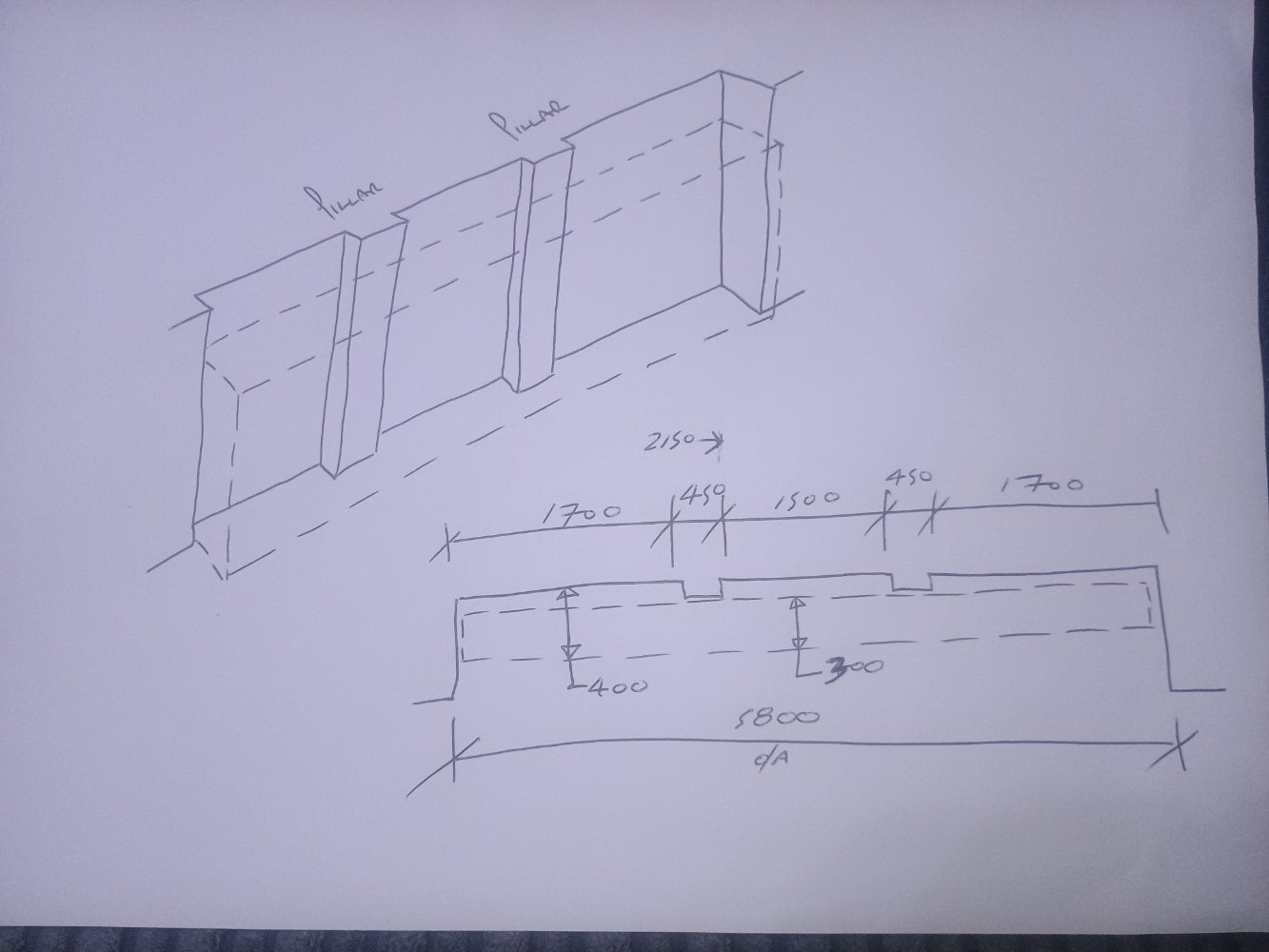

Would deffo stitch the crossmembers, might even need to be three deep, depending on how much weight is going on the shelves.Thinking to shelve one wall of the garage. Basically 5800 between the end columns with two buttresses sticking out.
Can only stick out 400mm so 300mm at the buttresses.
I've lots of 25mm box section...
Maybe stitch some cross members to make them 50mm deep?
It would mean actual welding...
Scary really!
