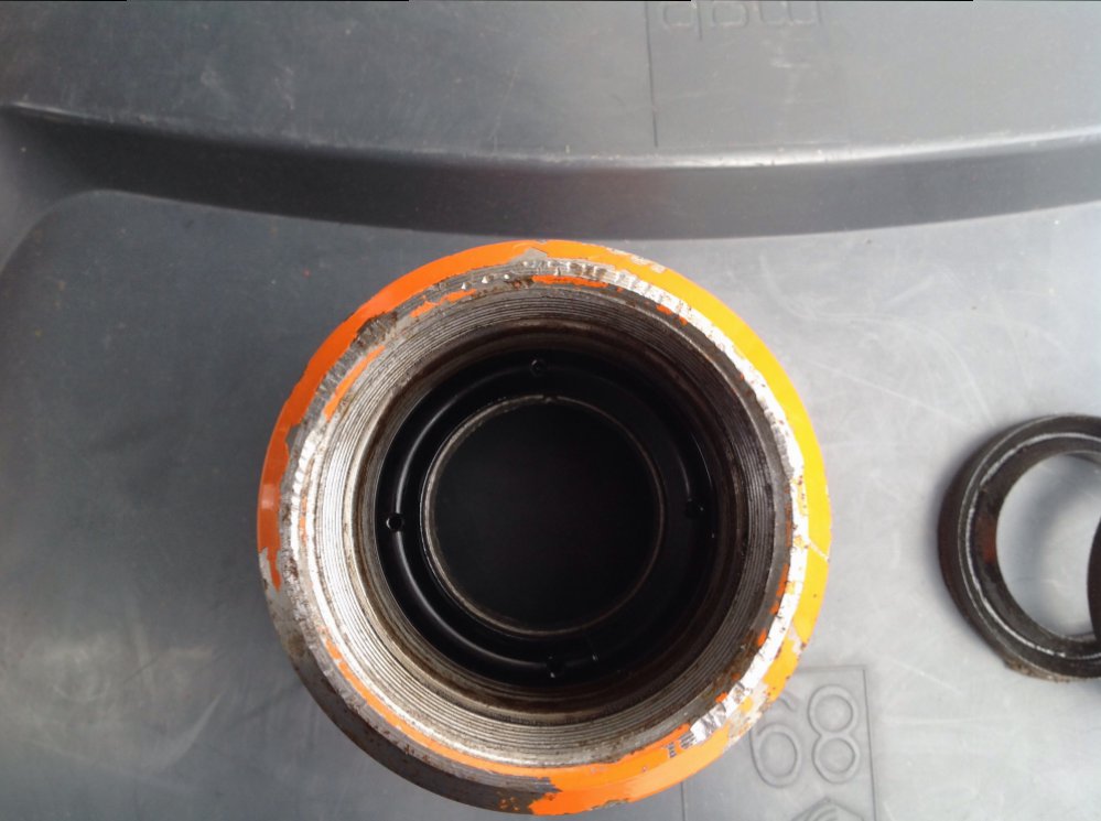

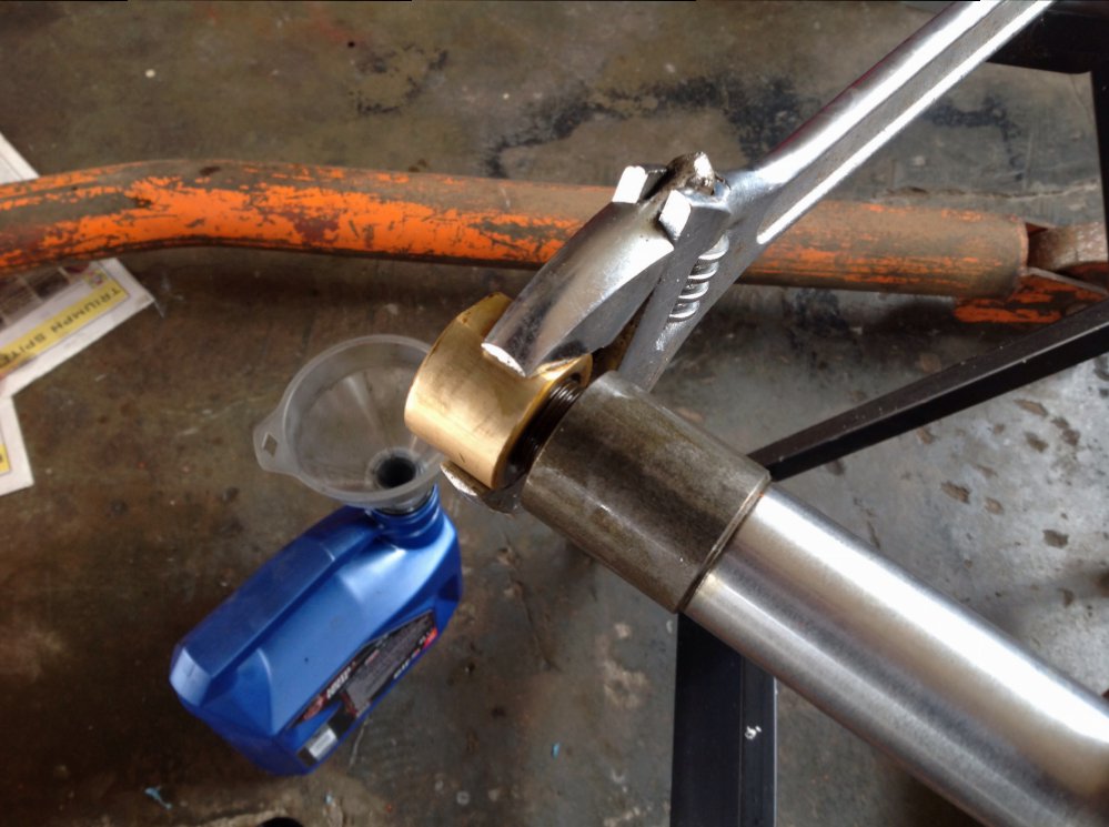

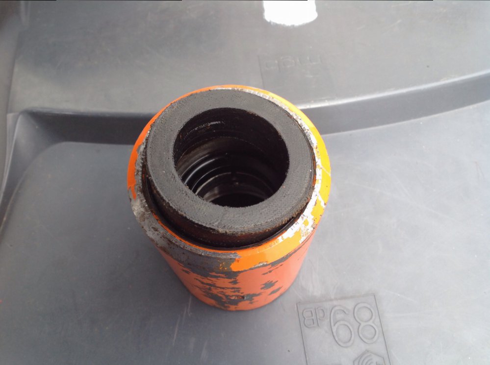

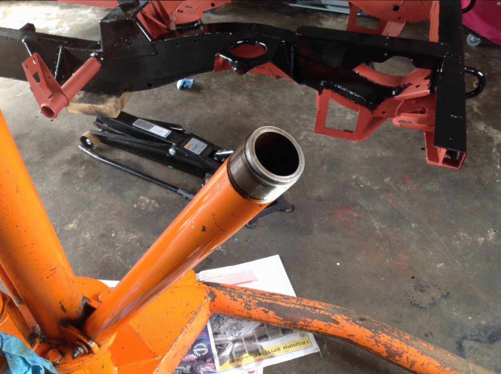

keep topping up...this is what i do to remove brake caliper pistonsmight not be enough oil in it to do so but good idea and worth a try

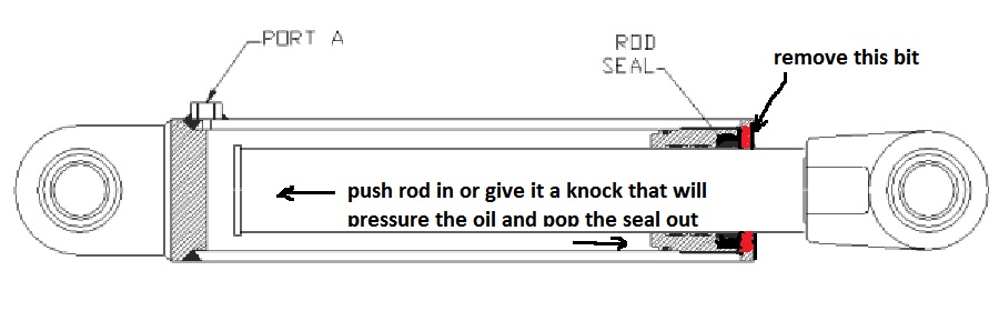

pump the ram to the top and gentle push the rod the last bit to get the piston out.
I think the cup thing at the top needs to be removed. Piston at full length hits a solid stopper with a heavy clunk. I will report back when (and if) I can get cup removed!
sorry I had put to get the piston out, I meant the sealpump the ram to the top and gentle push the rod the last bit to get thepistonseal out.
look at the op's picture, its got a piece on the top.

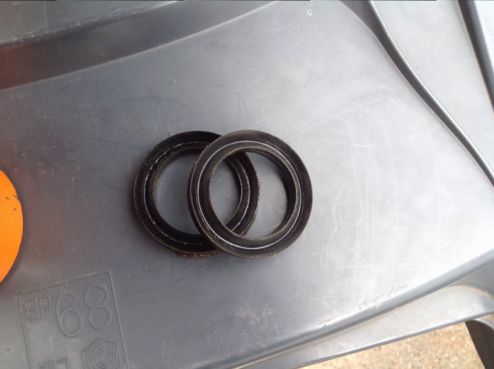

I'll put that down to being a richard head blackwells/hydroscand or sos ?I am going to take the whole lot to a local hydraulics place and see what they say.
try visiting a few different hydraulic places before posting them off, if they get lost in the post you have nothing as a pattern the people I use will always order bits if they don't have anyThanks norm I was going to try chesterchain.com and see what they say. I will go down there tomorrow. I called hydraulic equipment supermarkets but they wanted me to post the seals to them. I will do that, but only if I have no luck locally.

yeah I know them too I was there a mth or so ago.chesterchain.com
