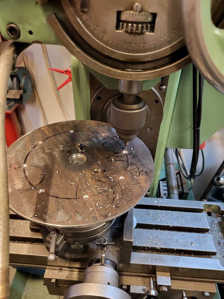

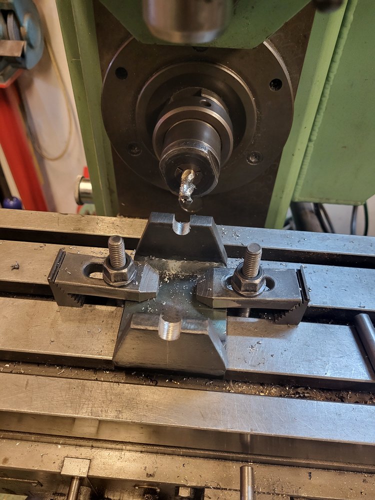

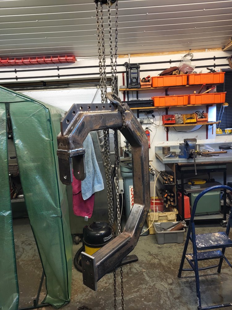

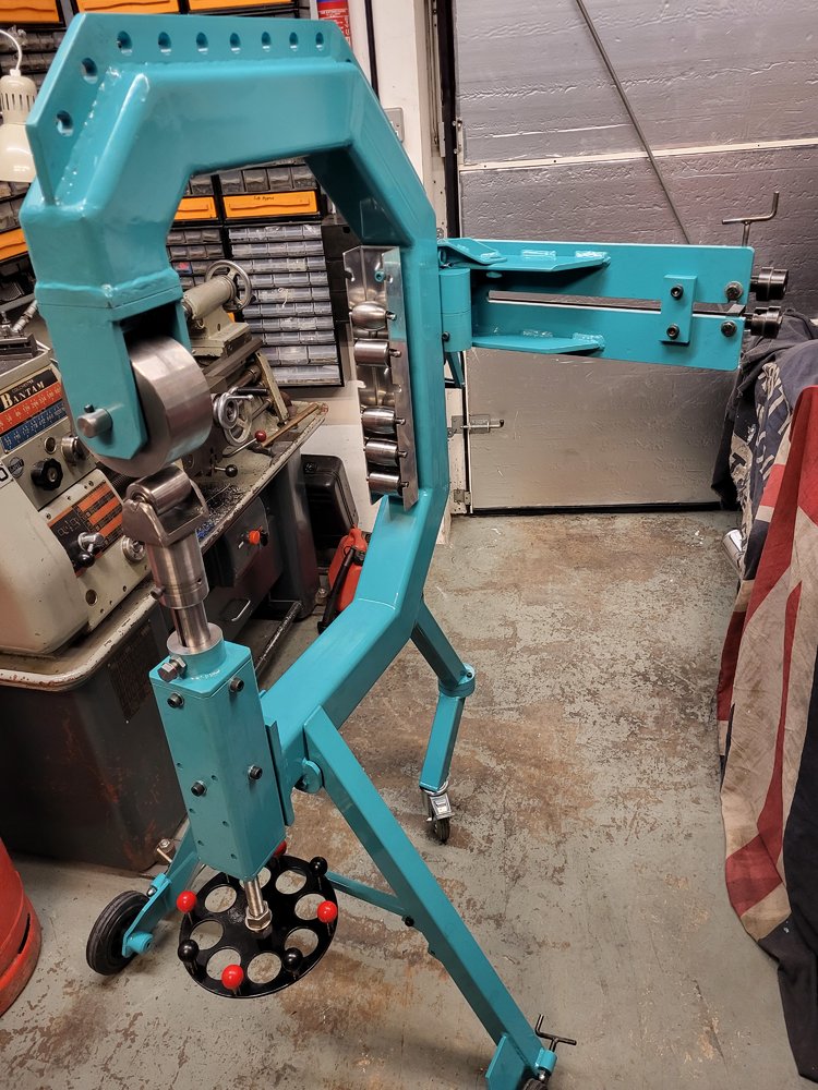

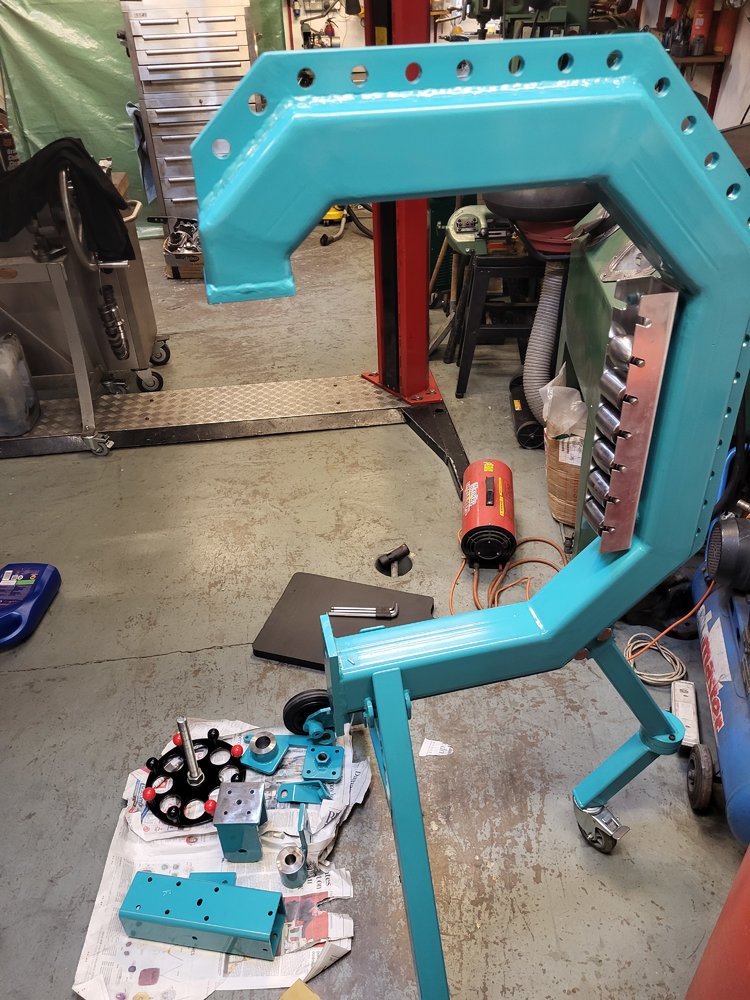

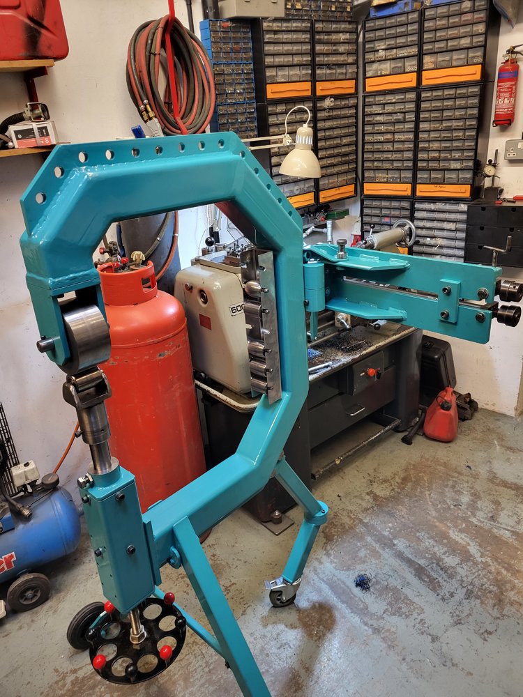

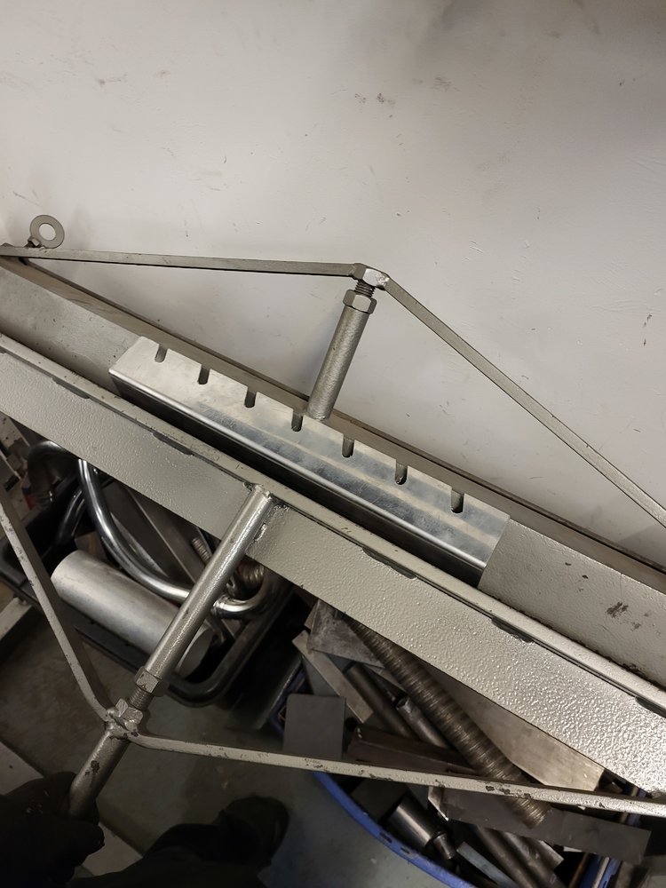

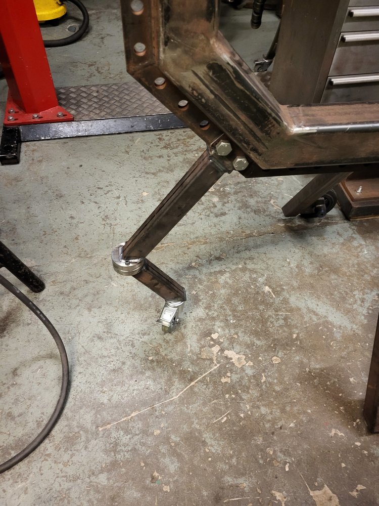

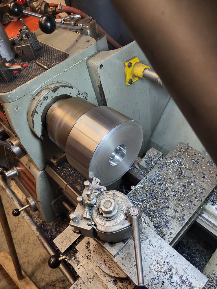

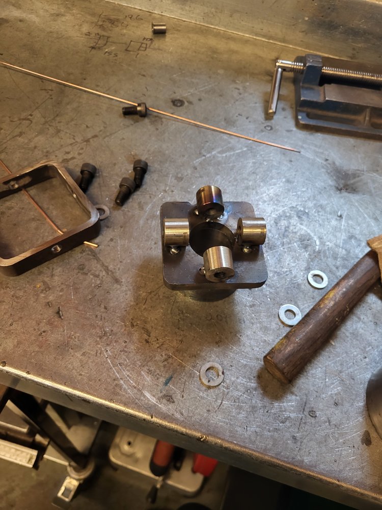

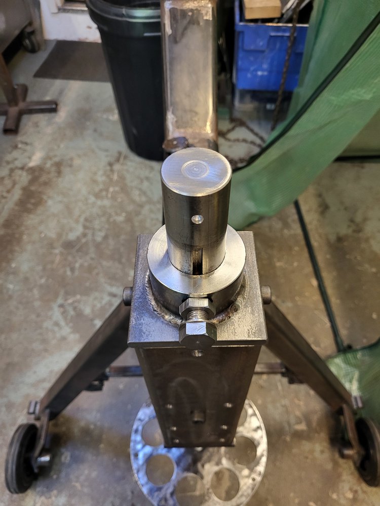

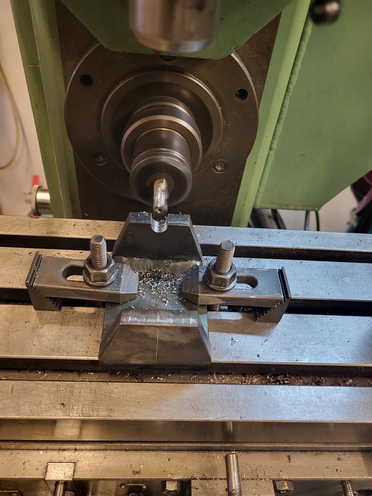

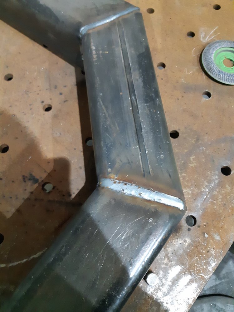

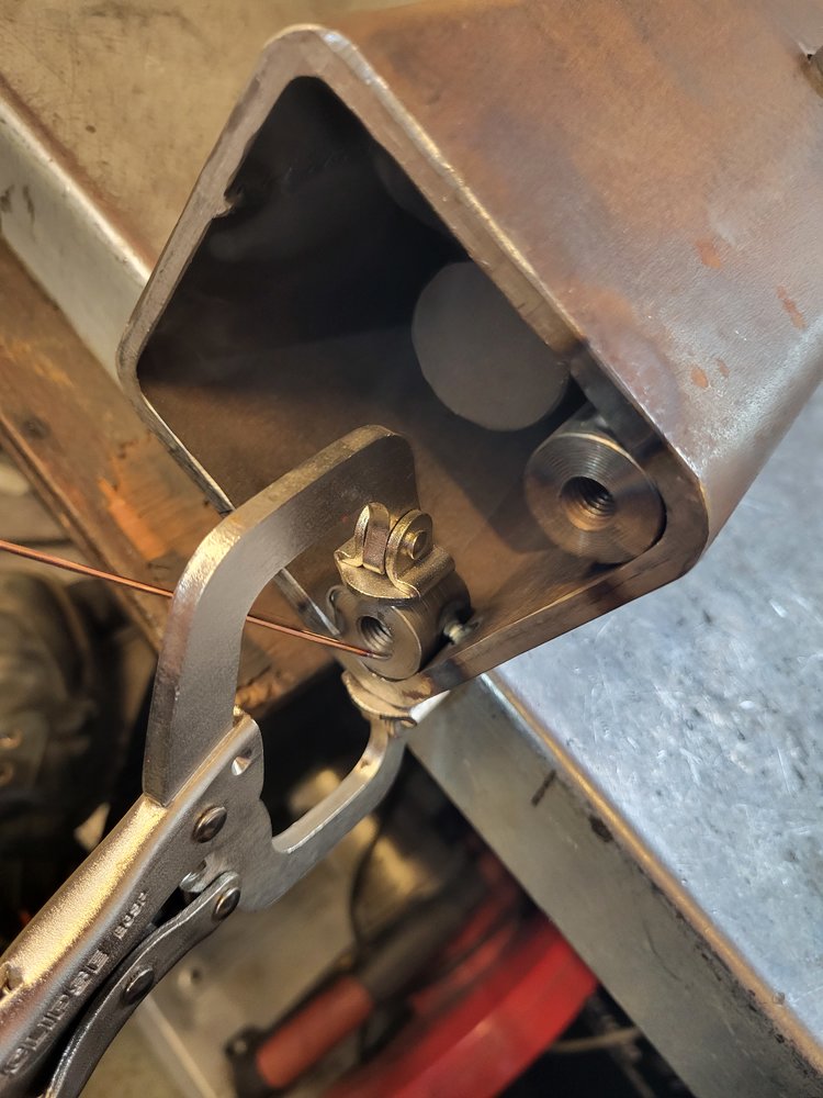

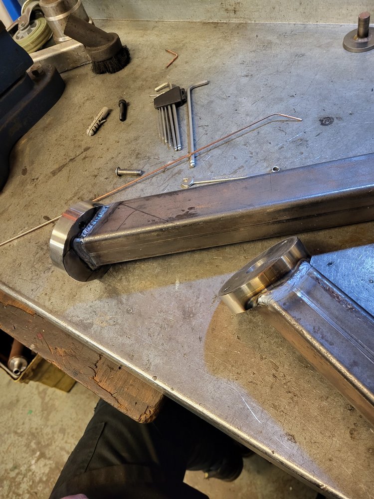

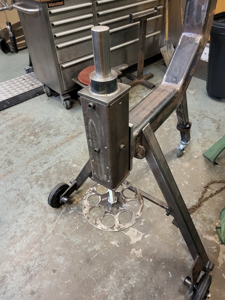

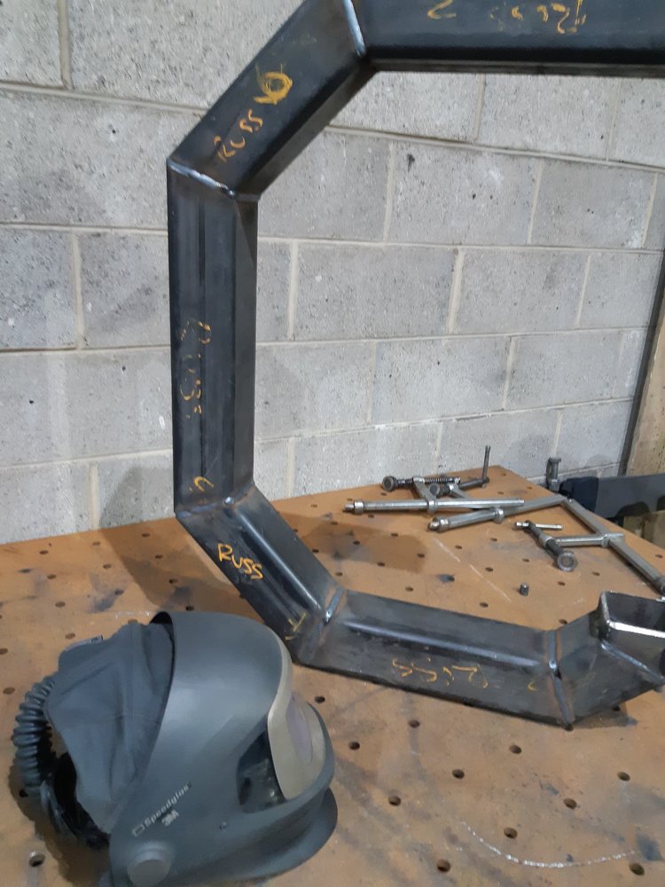

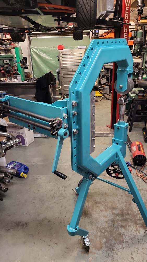

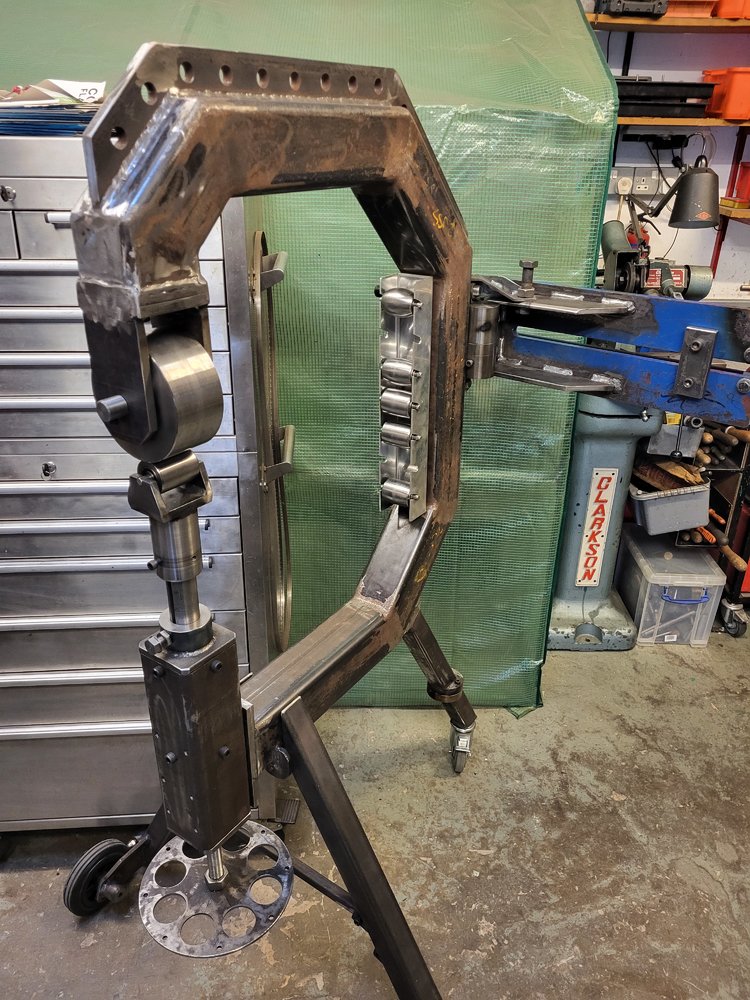

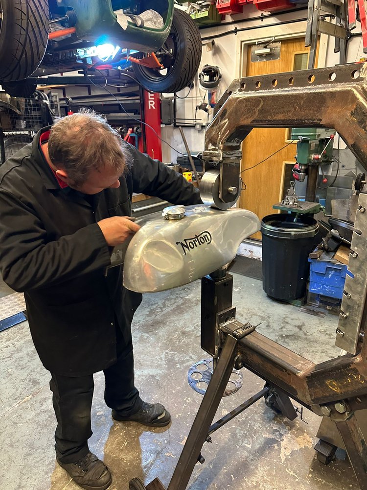

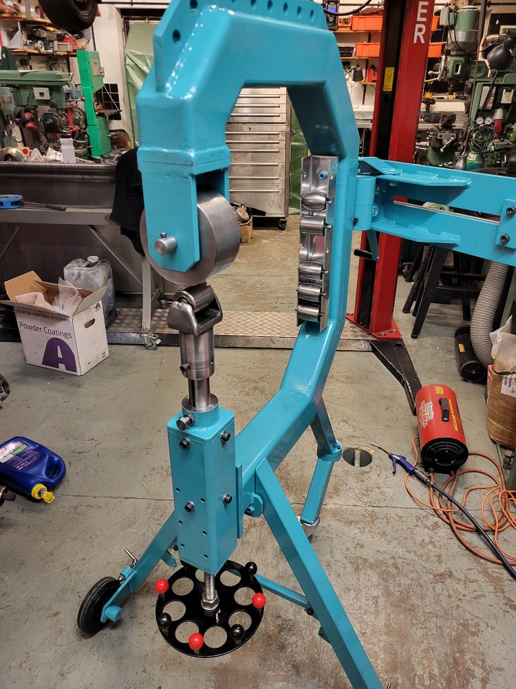

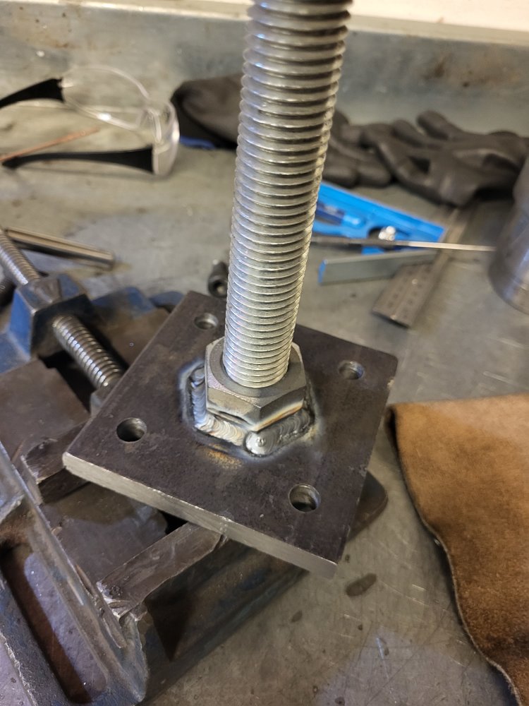

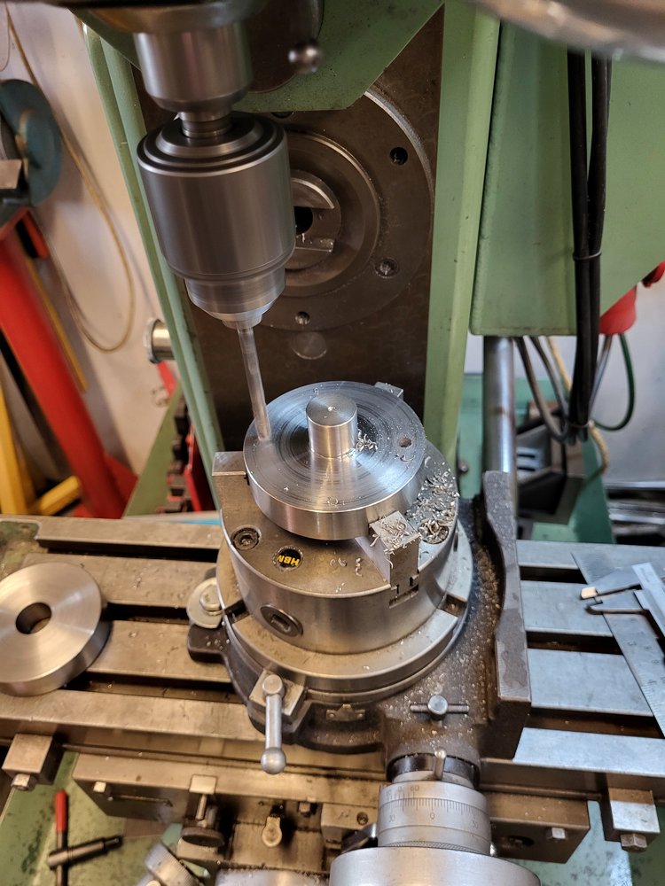

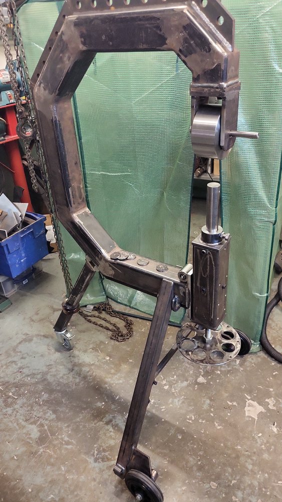

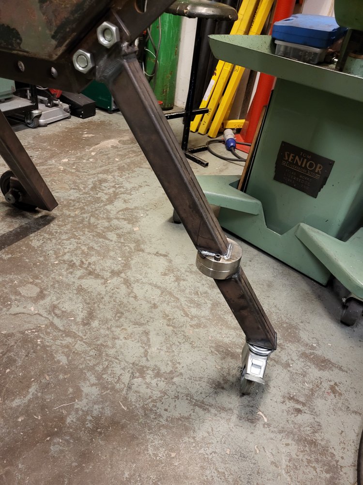

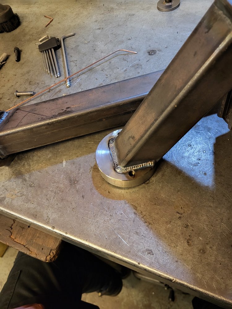

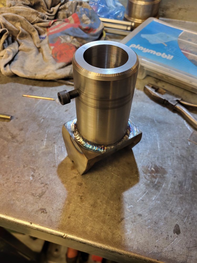

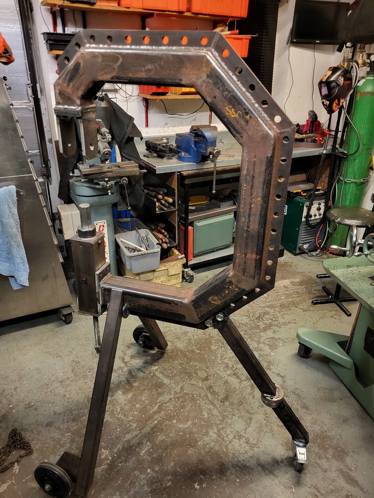

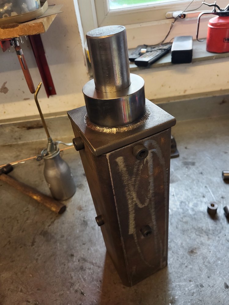

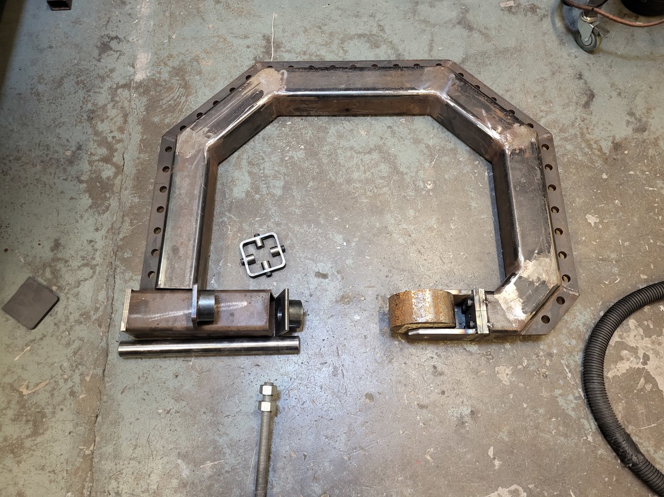

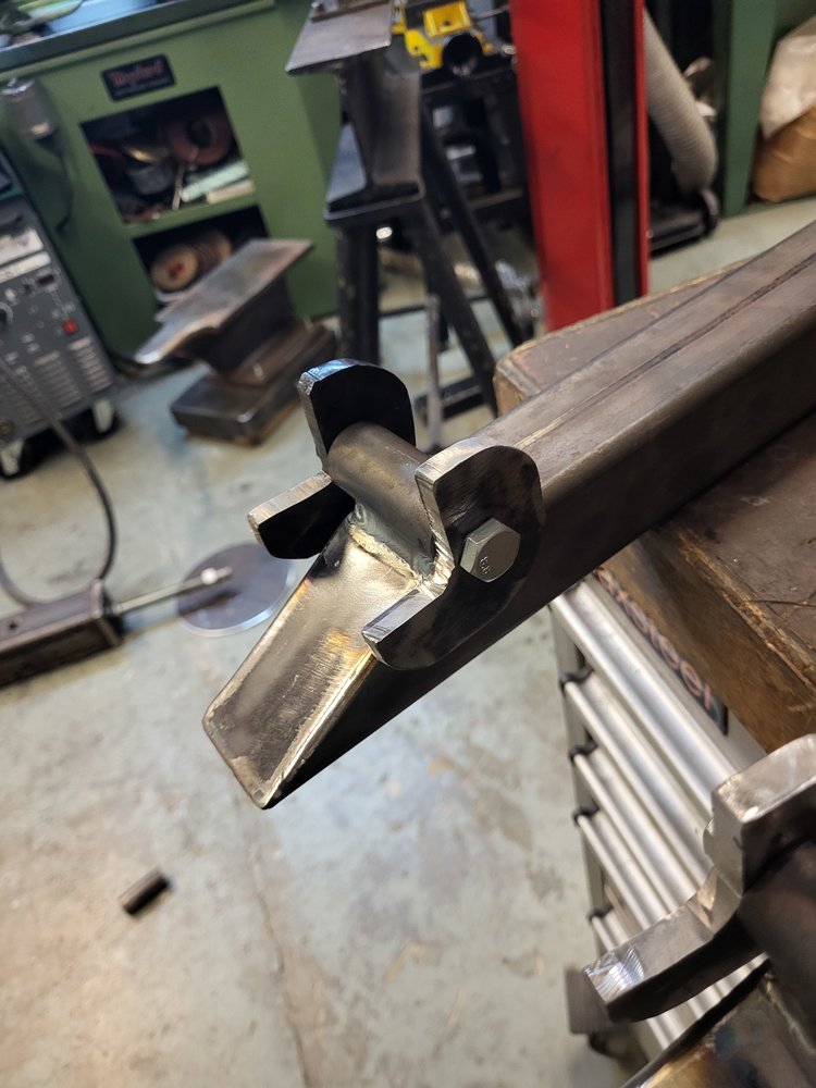

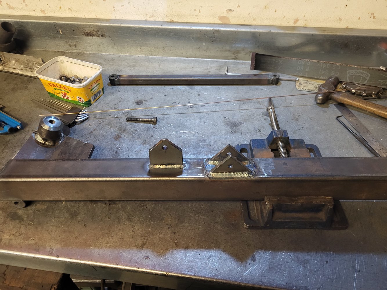

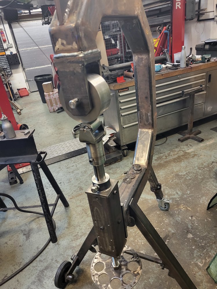

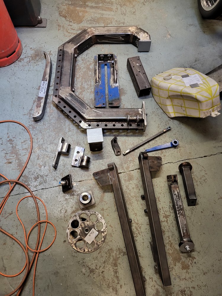

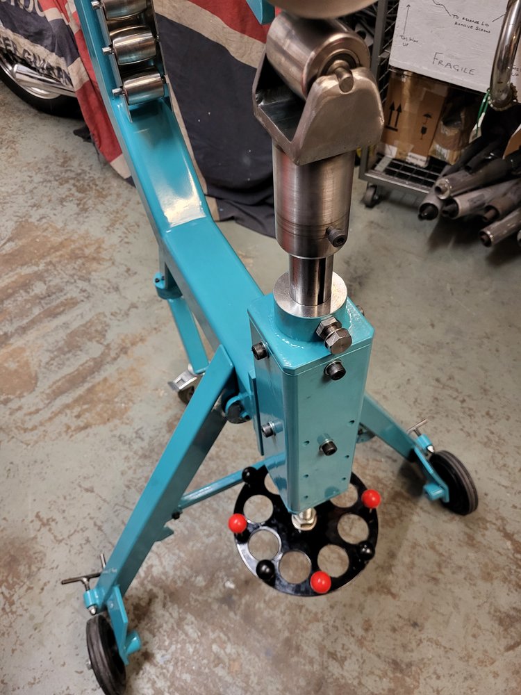

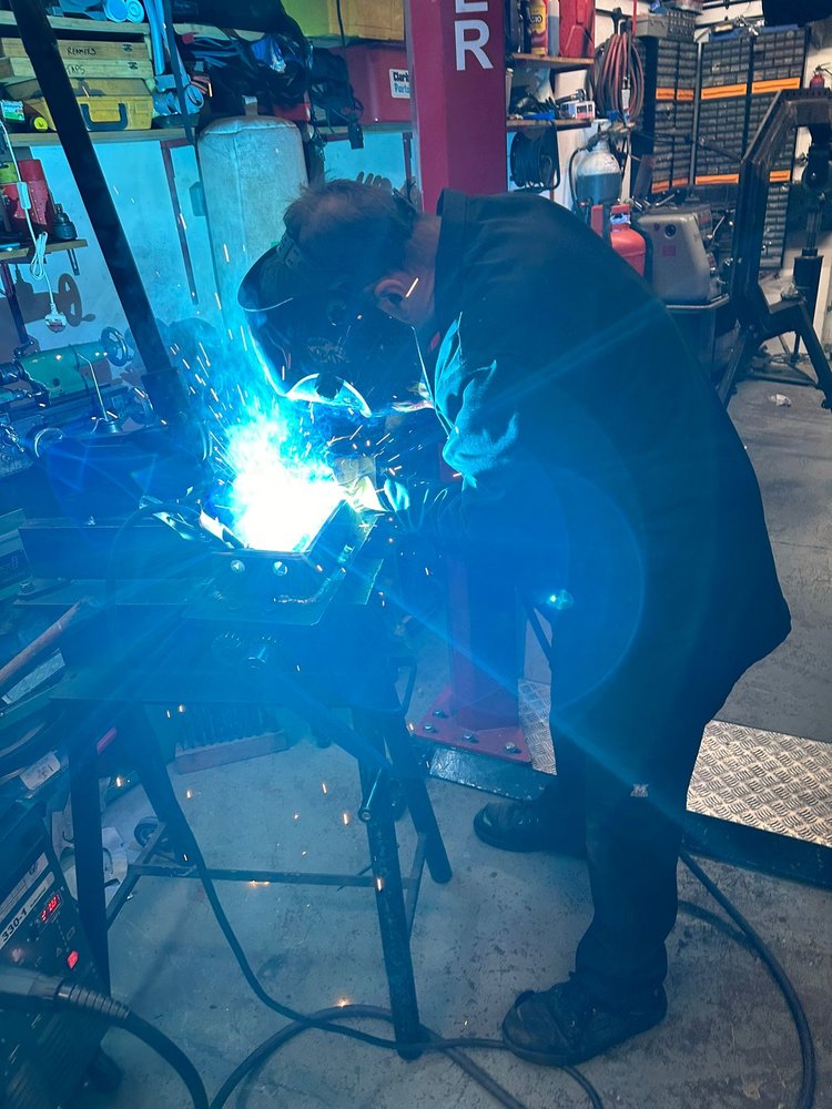

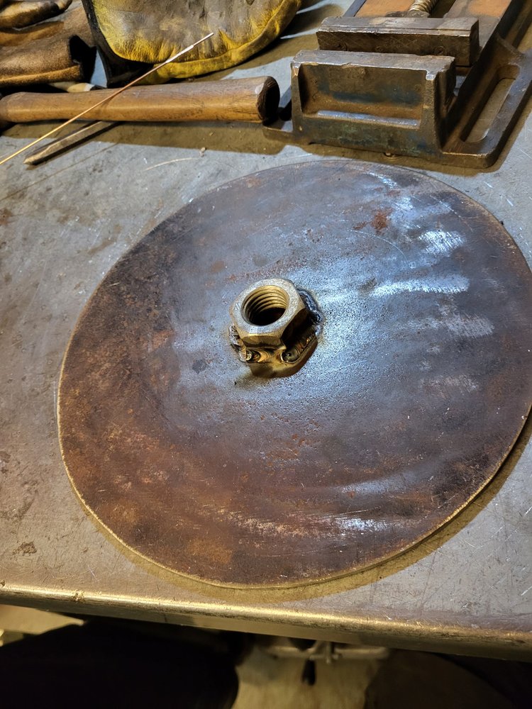

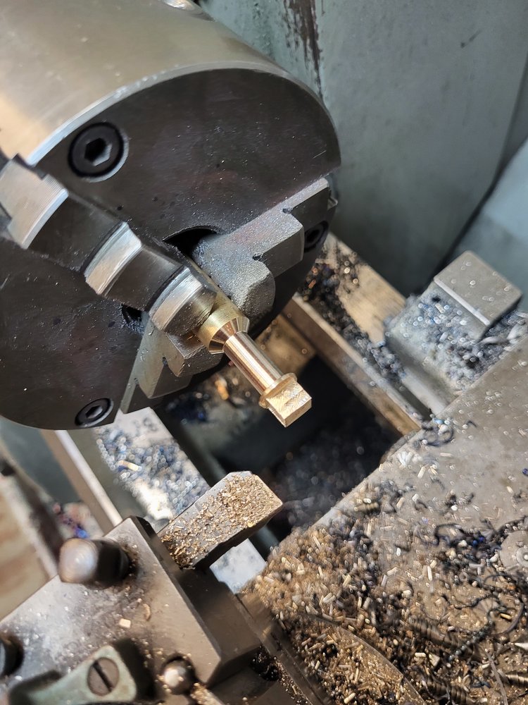

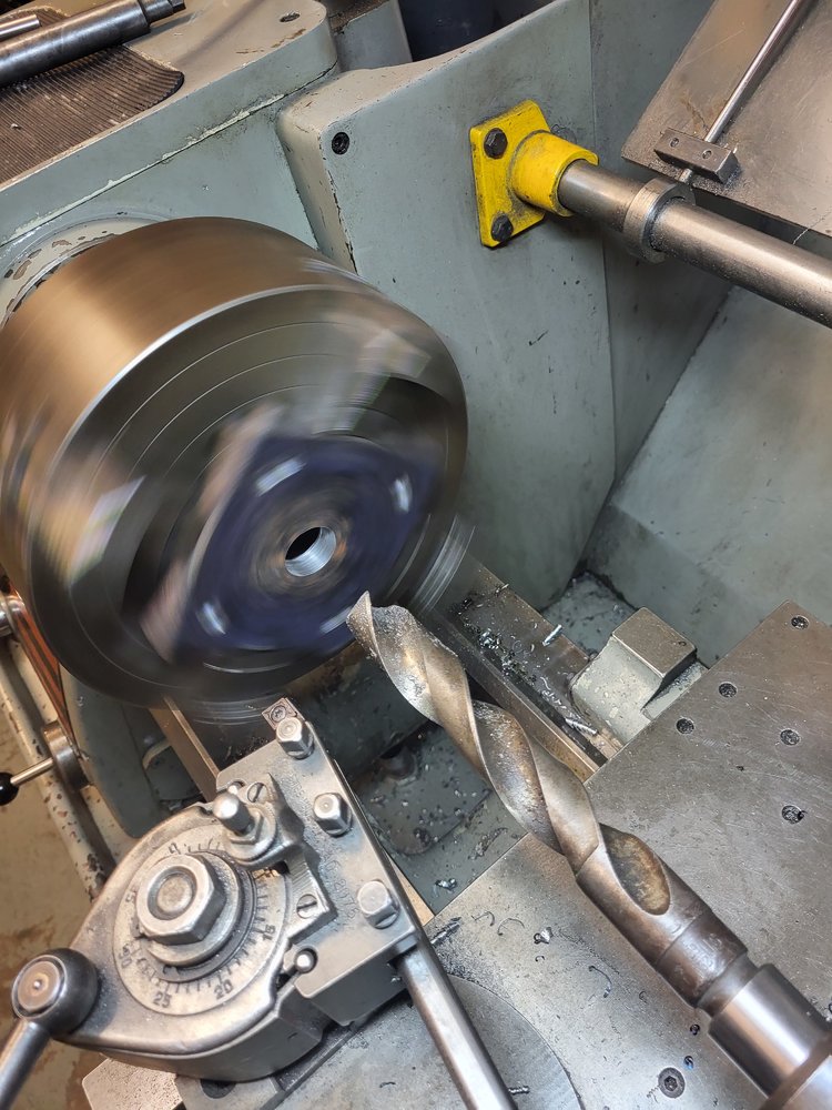

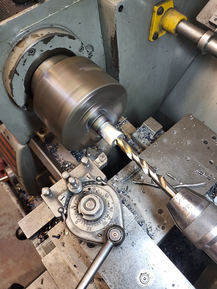

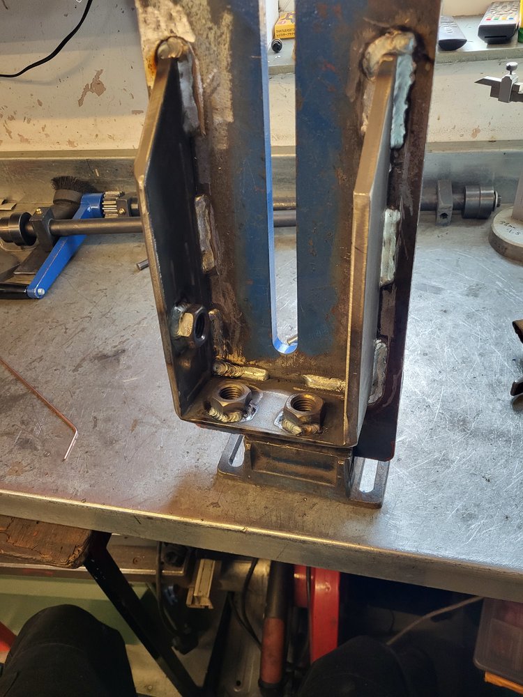

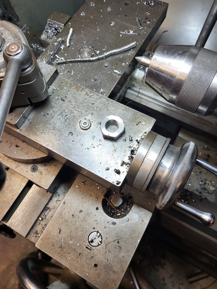

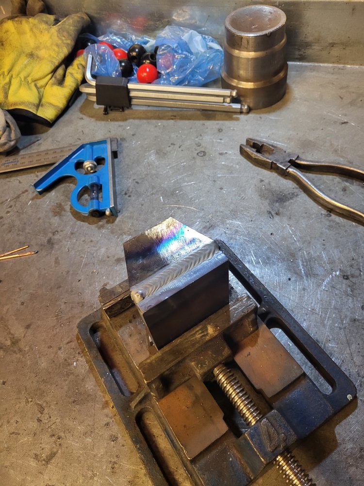

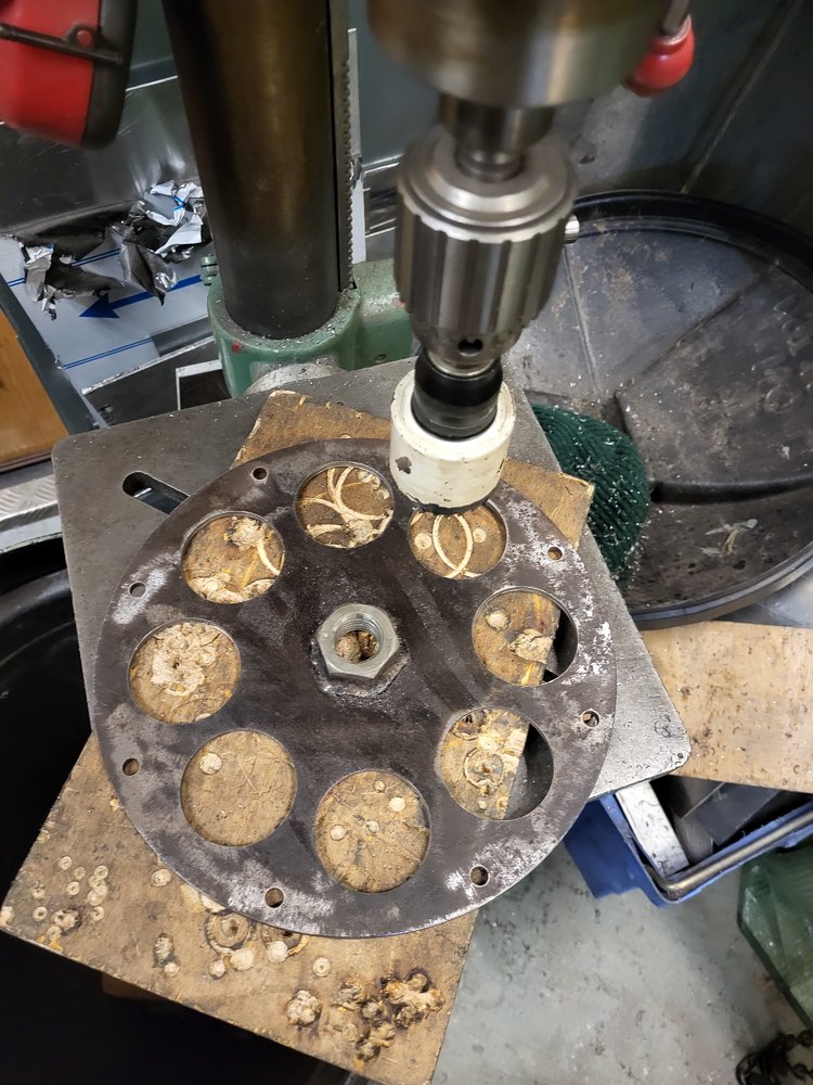

Here's my English wheel build that I started a few years ago. I've recently had more need for a bigger one for repairs and custom work so I decided to pull my finger out and finish it.

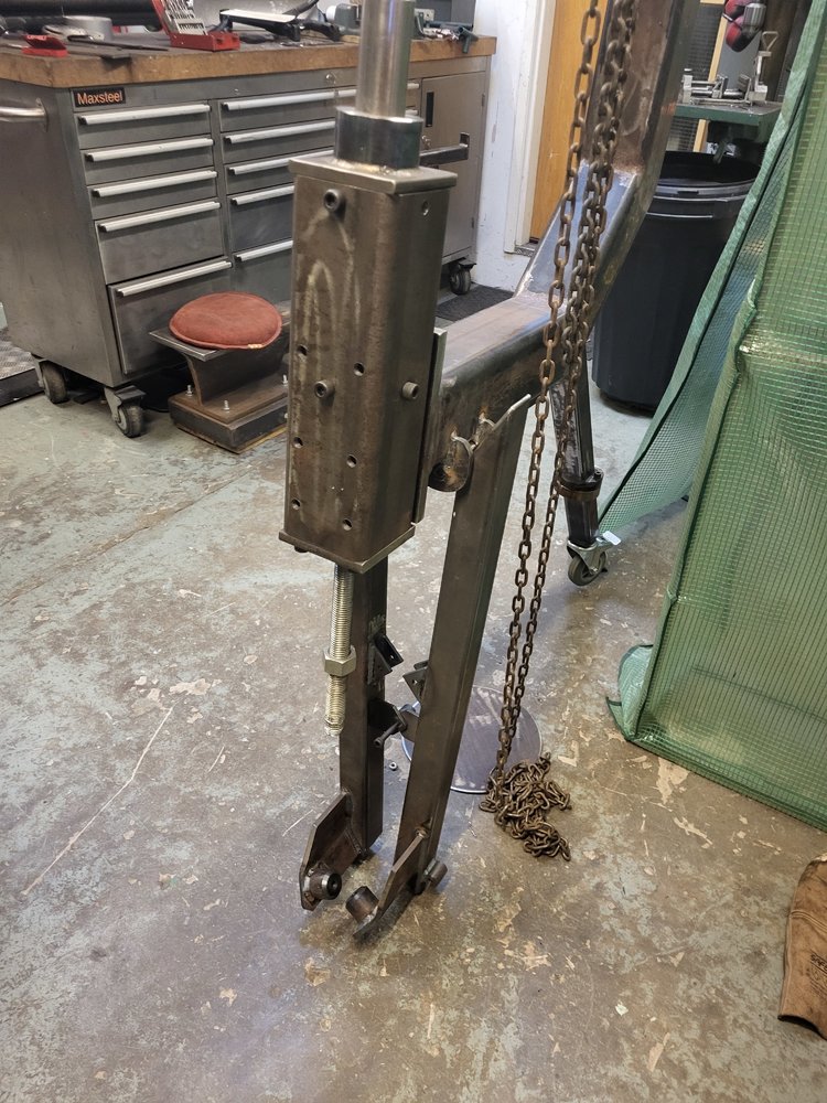

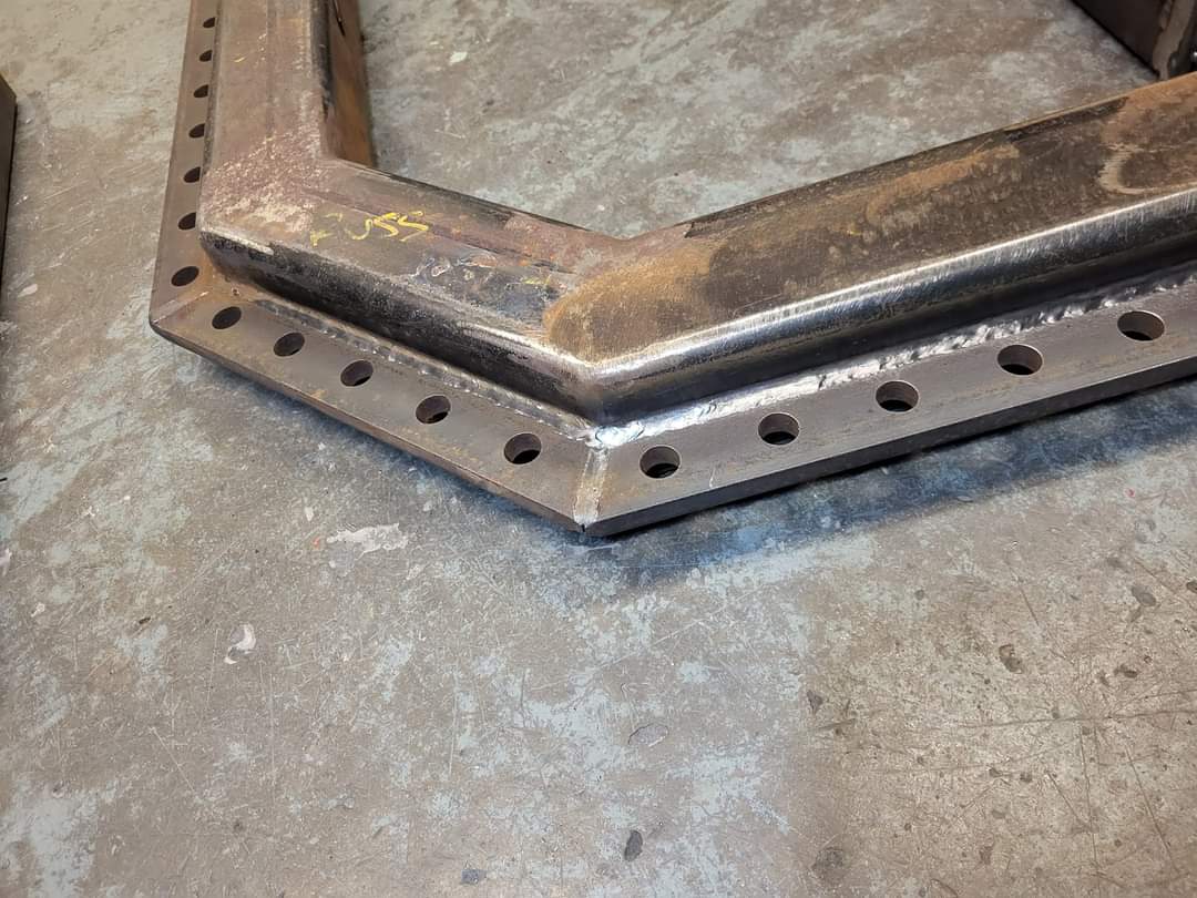

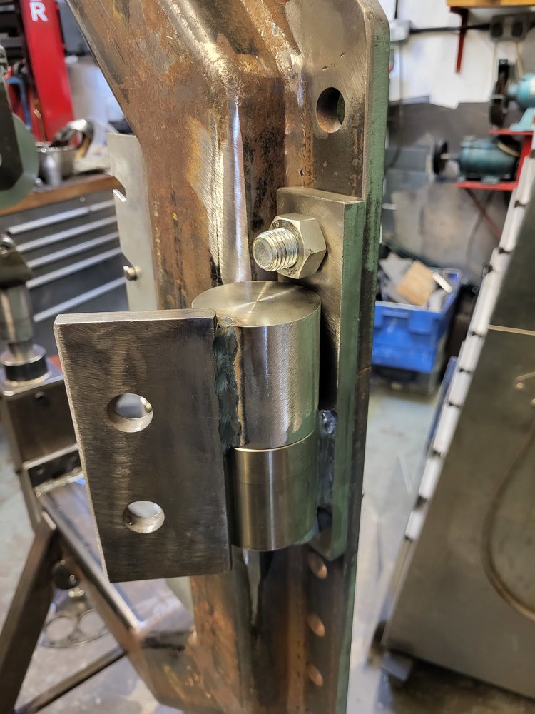

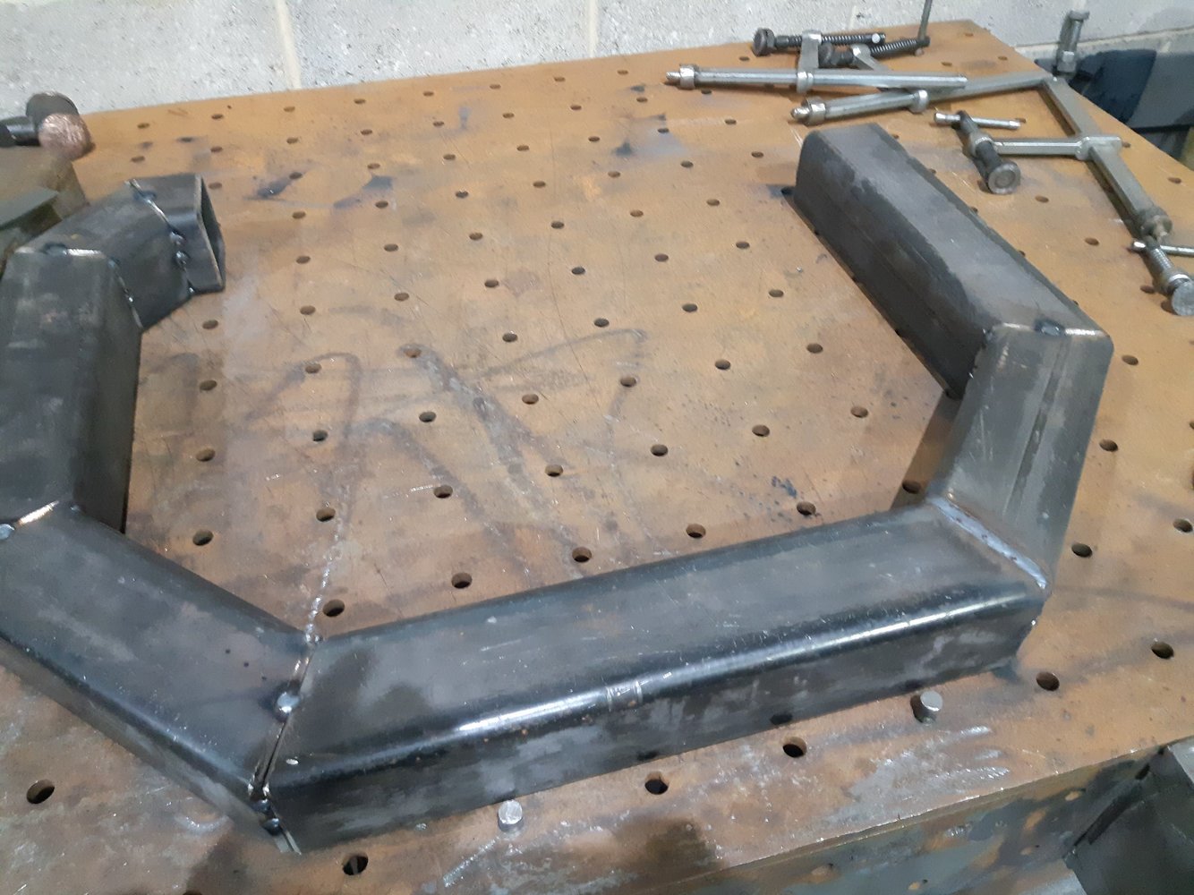

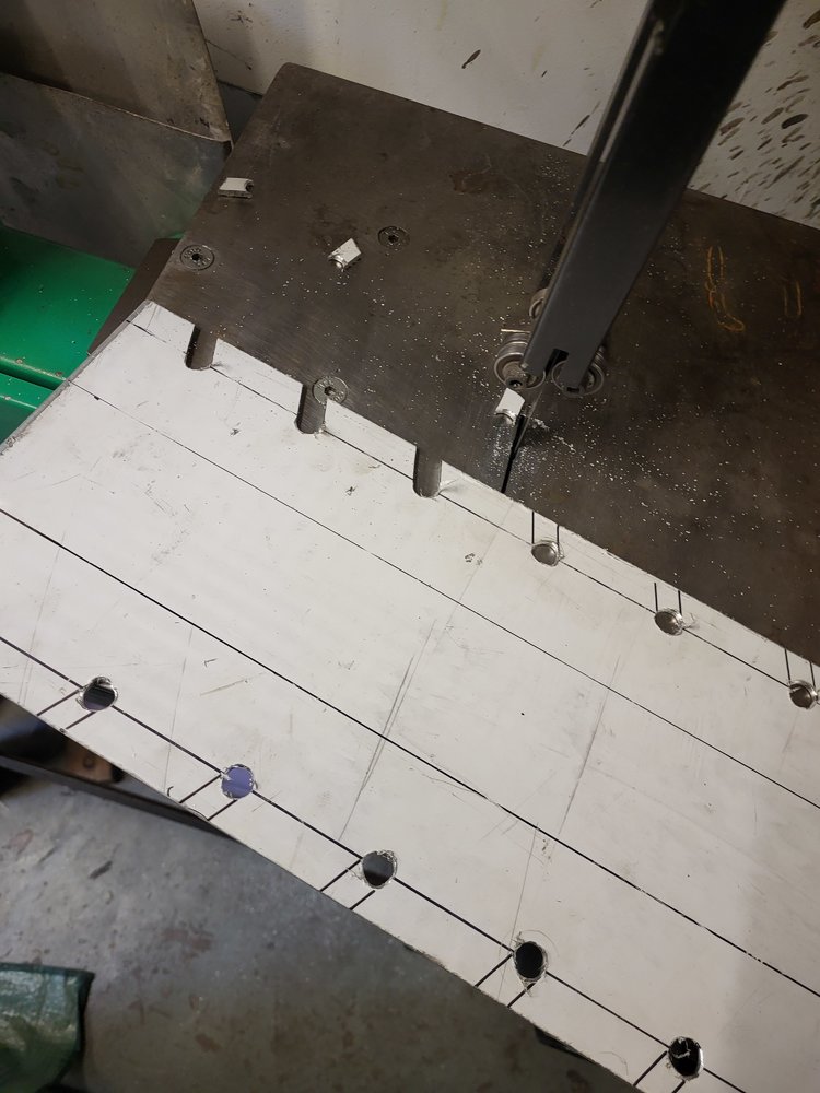

It's made from 100x100x6mm box with a 50x15mm spine welded on the outside. I drilled holes for a bit of style but they are useful mounting points as you will see.

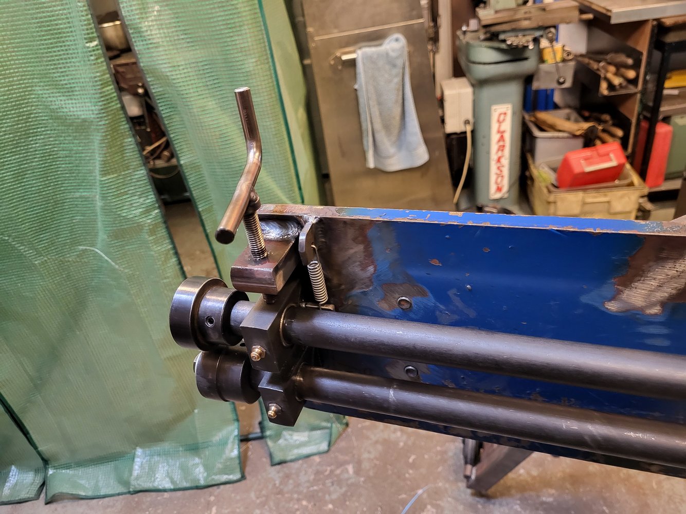

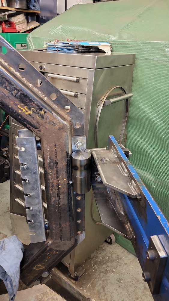

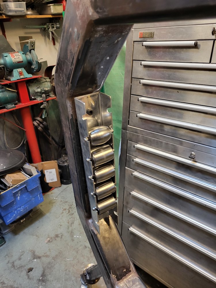

The bead roller is a cheap import job that I modified and strengthened that fixes to the rear of the frame as I was fed up of it being clamped in the bench vice.

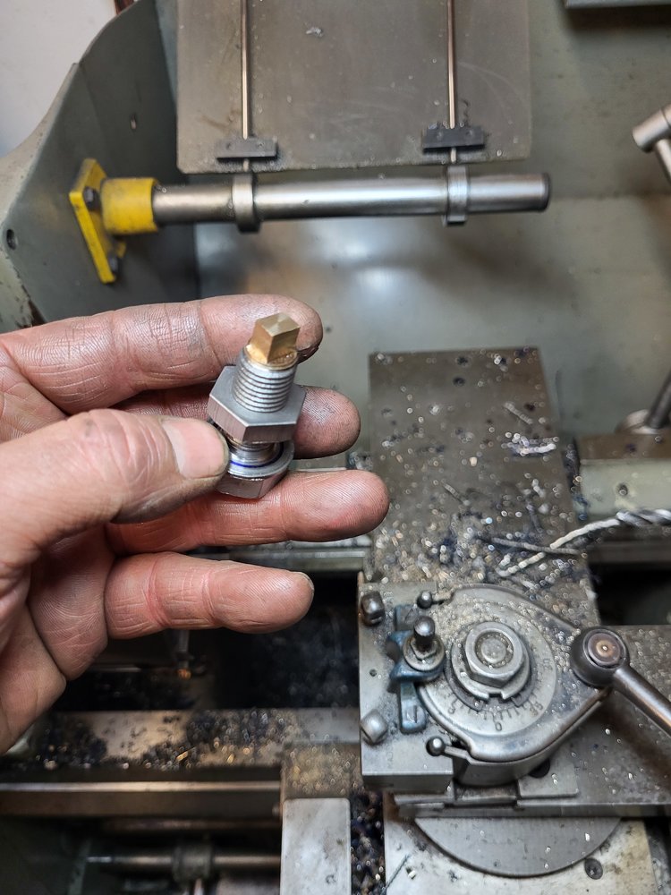

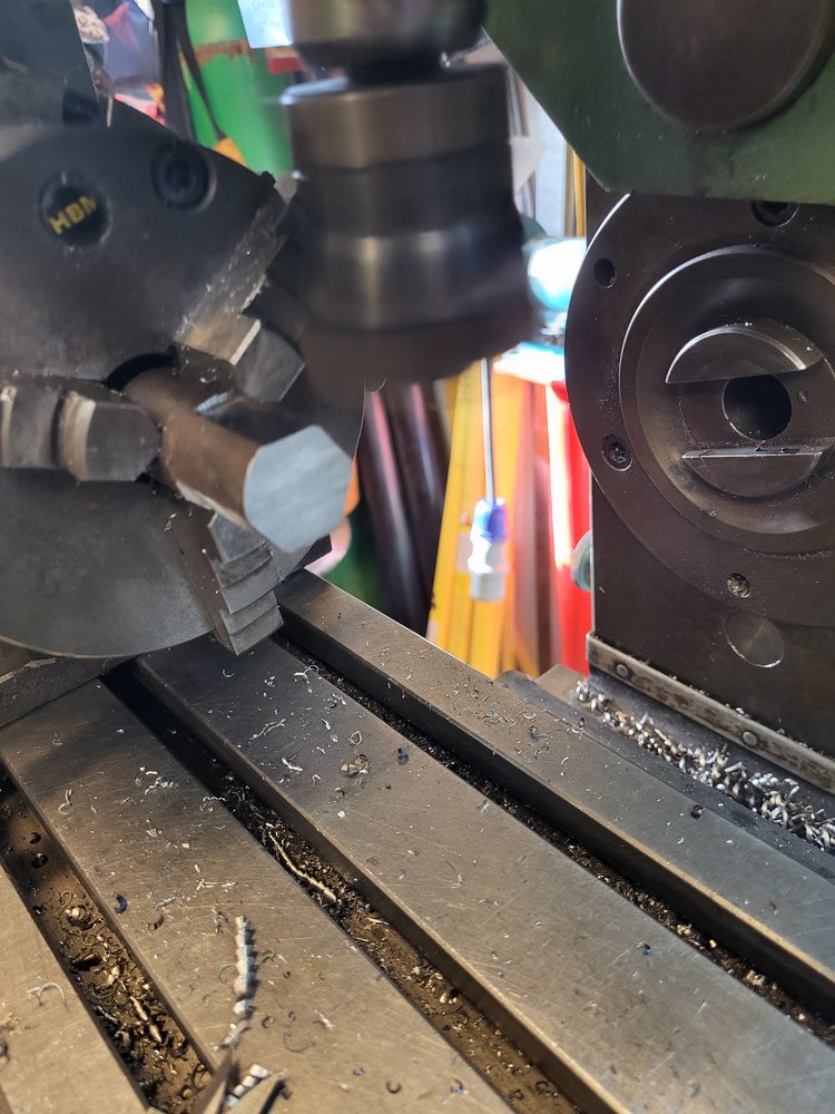

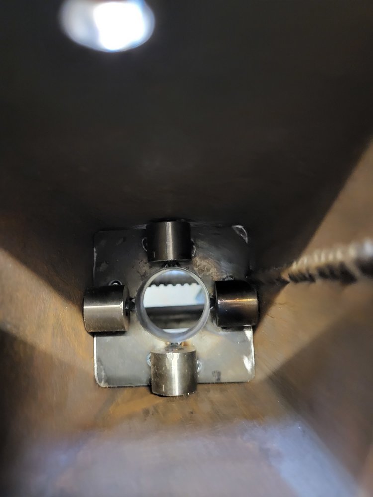

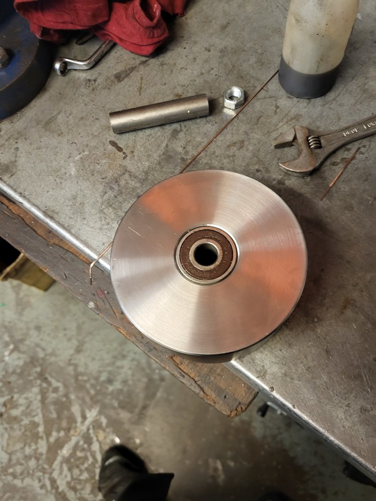

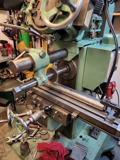

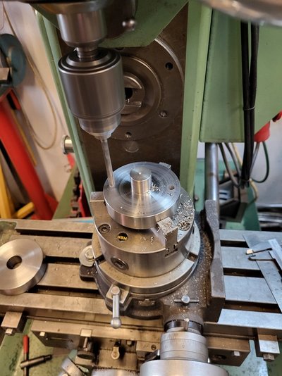

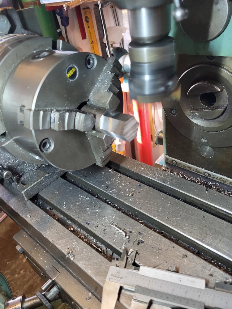

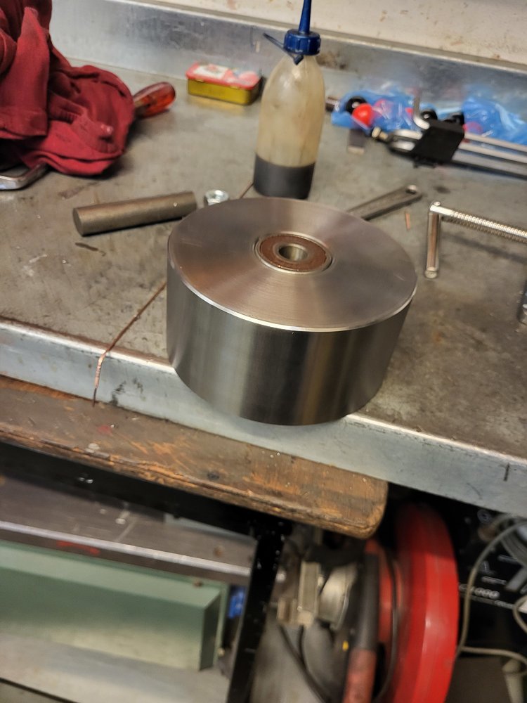

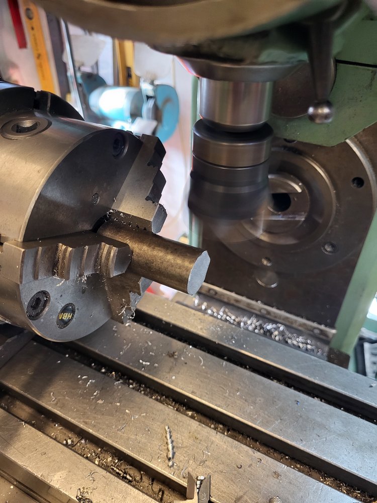

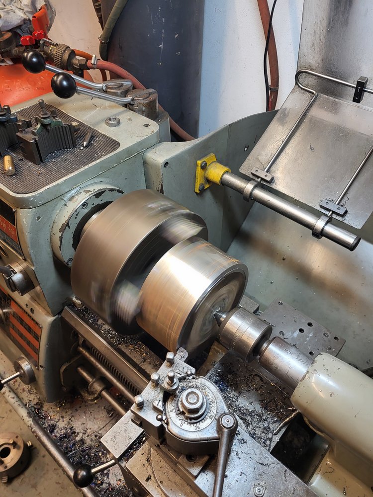

Appart from the bead roller the only other parts I bought were the set of six lower anvils as it wasn't worth my time making them. Everything else I've made from scratch.
