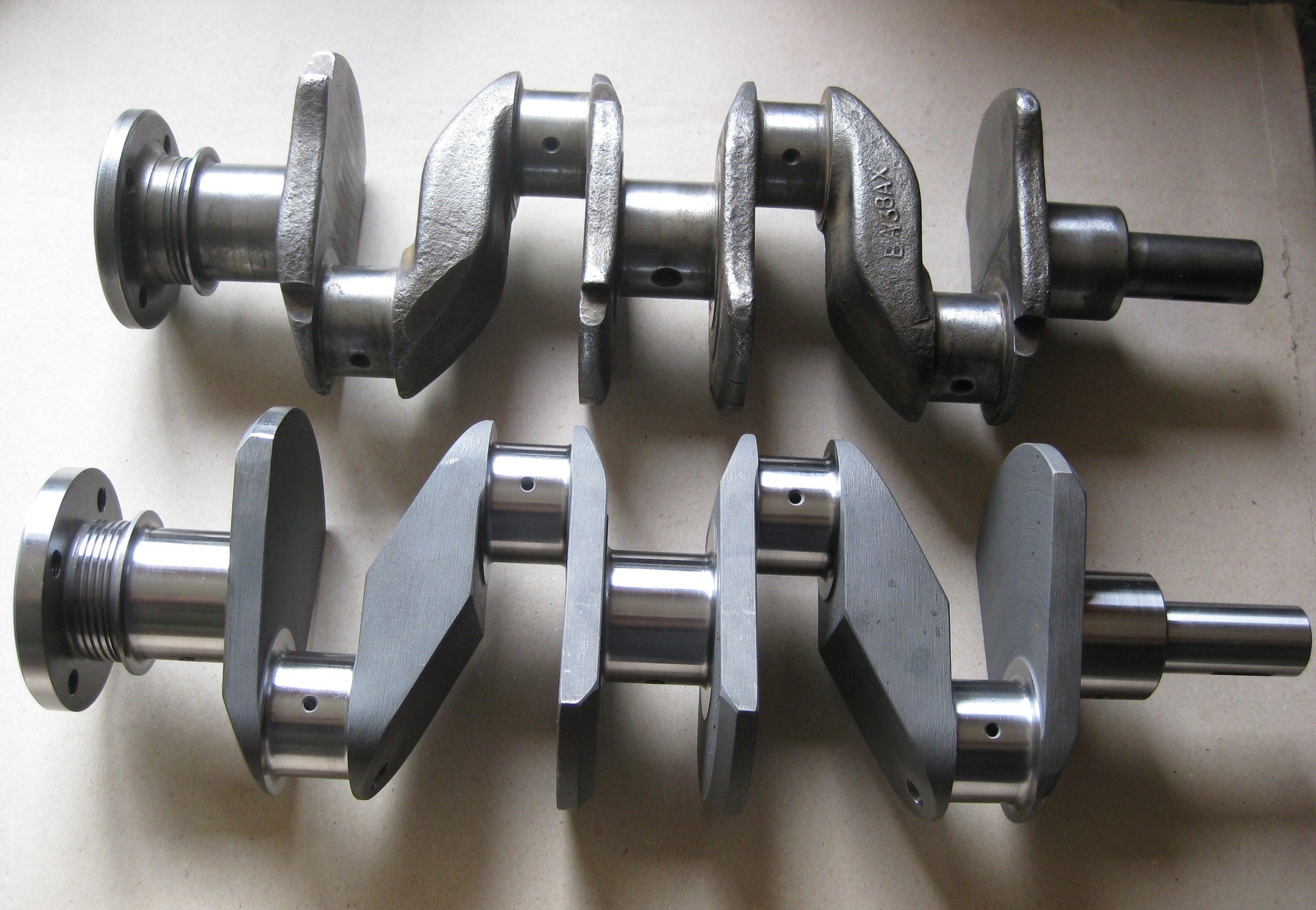

How do you make the crank survive - it surely can't be the std one?
Lastly, on the porous race head - been there more than once - allways on the inside of the inlet port divider, short side radius - plastic metal is good, lasts well unless you boil the thing. I once had a head come back after a few seasons racing - cracked between the middle exhaust valves at the head gasket face - that one I drilled the top face, blast cleaned through the hole, heated it up on my ceramic hob and soldered it, then plugged the hole. It was sill racing last I heard.
@Stueeee what is the name of that company in Slough? I knew a couple of guys that worked in a similar place back in the 90’s.
Phoenix Crankshafts, as in 'Phoenix from the ashes' the 2 guys who started the company had previously worked for Allen Crankshafts and had left Allens following some kind of company upheaval.
I now have had 3 cranks done by Phoenix and 1 done way back when by Allen, always been superb work in my experience.
