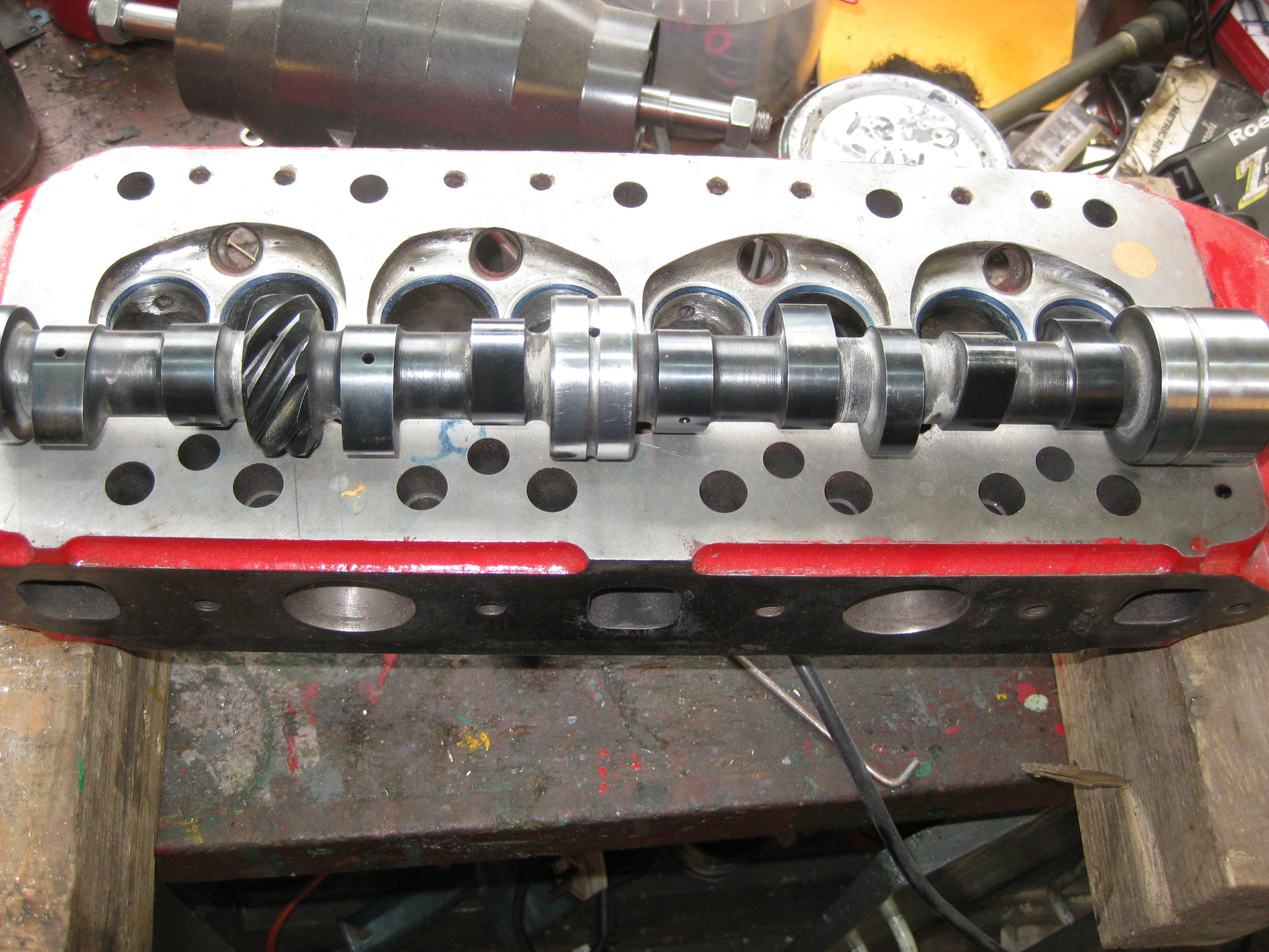

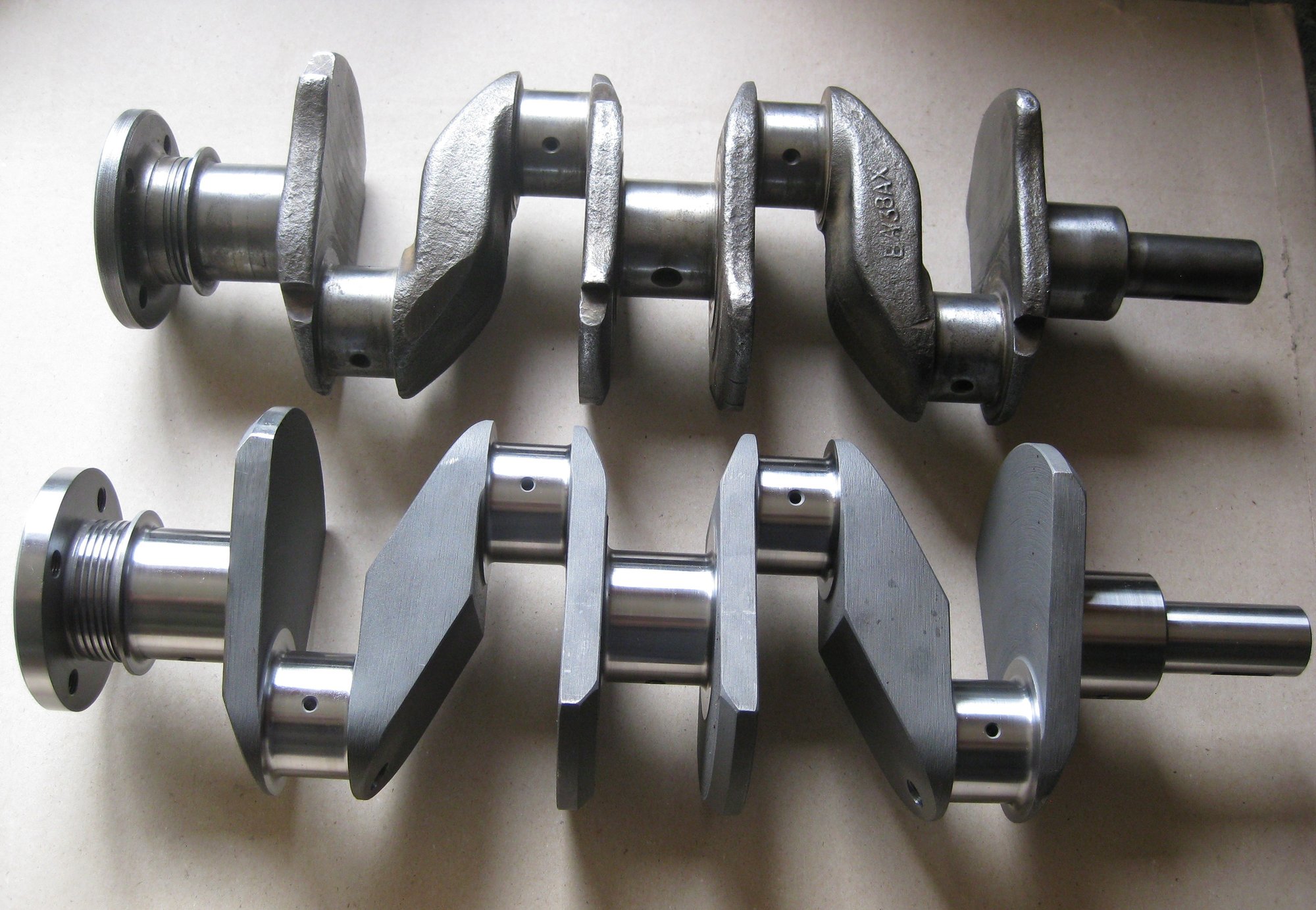

That looks like a deep pocket crank.. I used to like making A35 and Moggy 1000s go a bit faster so i used midget 1000 10CC engines with the 2" cranks, nothing crazy but with a LCB exhaust and a mild cam they went well and were reliable for every day use.taking forever seems to be a "thing" with camshaft people where new masters need making to do the grind. A mate of mine who has a cam grinding machine has had one of mine for six months now....
I have learnt the hard way that finding a crank that Magnafluxes OK before it goes in, doesn't mean that it won't be cracked and/or fail after being run to 7000+ for a while. leading to this solution...
I had this made by a company in Slough, it's from EN40 billet and Nitrided. The only "off the peg" billet cranks with the "wide journal" A35 etc. main bearings are made in USA (they race 948 Sprites in SCCA racing "over there") not such a decent material though, and with shipping, customs duty etc. would have been quite a lot dearer by the time it arrived on my doorstep.
That's interesting about the plastic metal making an OK repair, mine was on the port divider too. Was a b***er to repair with braze, so much heat needed, had my neighbour holding a propane roofing torch under the pre-heated head while I used the biggest nozzle I had on the OA set..
