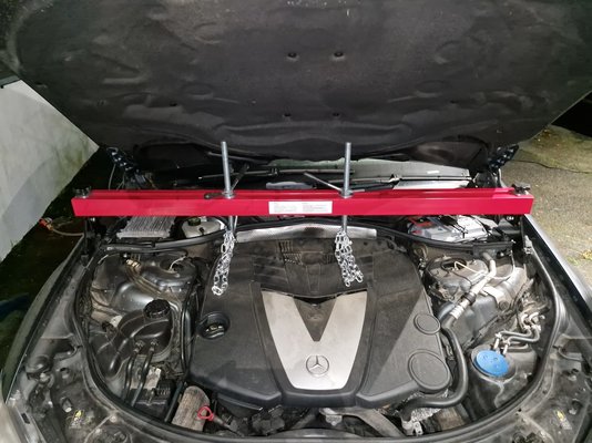

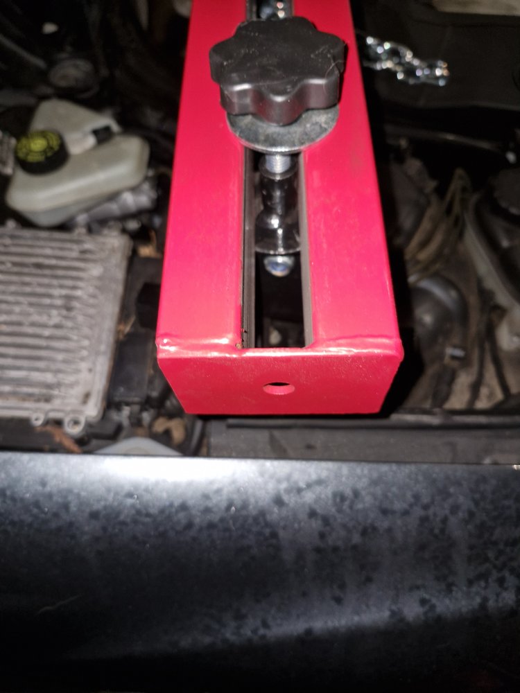

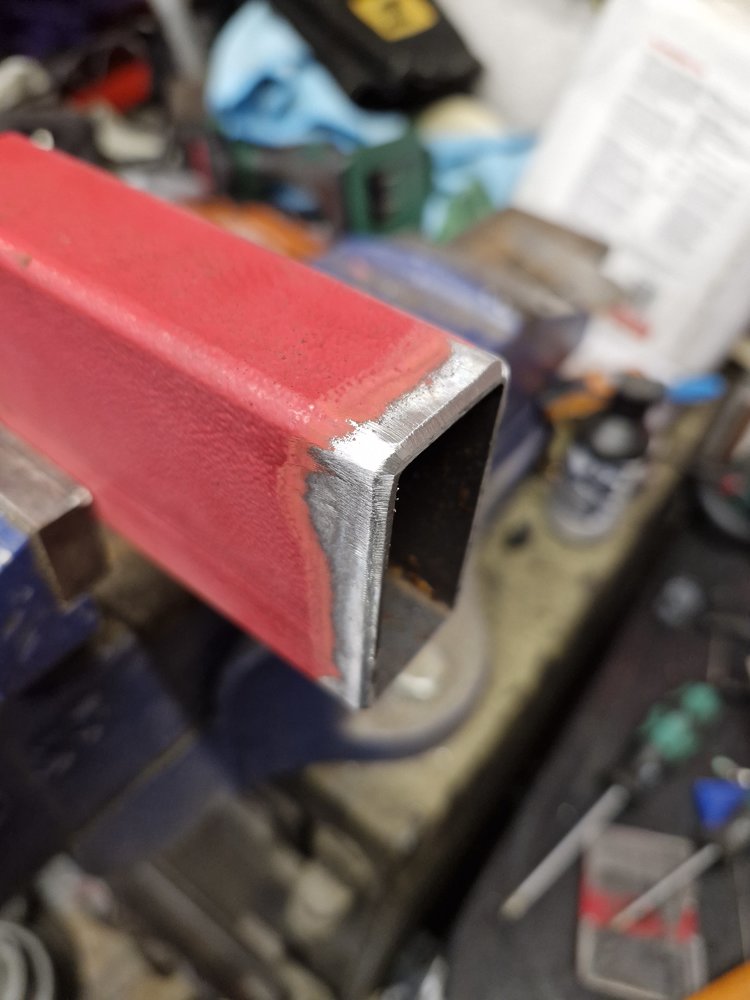

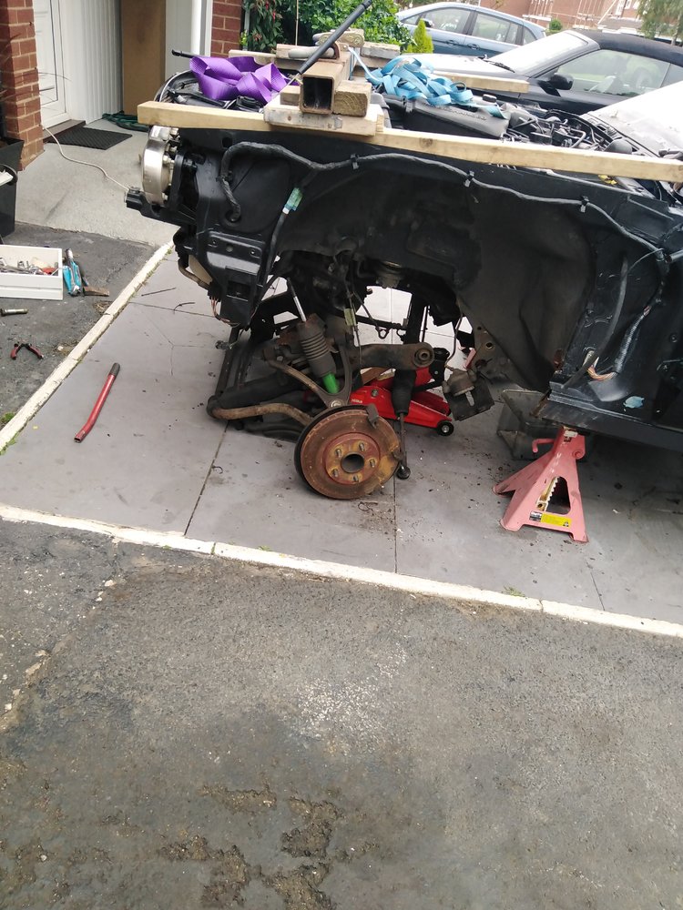

Having Merc S classes can cause problems. One of these is that they are big pitches so certain things don't fit.
£47 engine bar from scamazon free delivery. Very surprised with the quality of it. Heavy duty, probably weighs 25 - 30kg.
See if you can spot the problem:
(Not wide enough and this is not a wide S class) W140s are wider. Indeed so wide that when they first came out they had to widen the trians in Germany so they would fit.

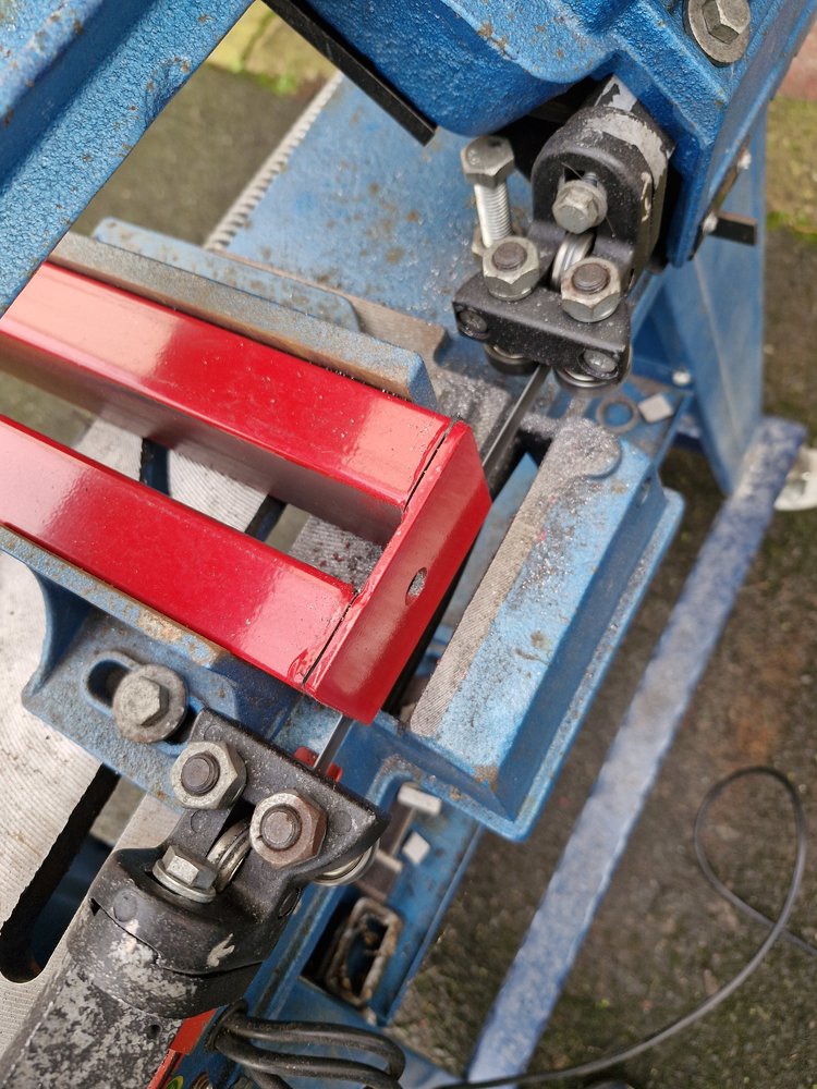

Anyway, I wanted a 500kg one and suspected this would be the case so I have a plan B.
Bandsaw off box ends and carefully weld in 4 inch extensions to both ends. Re weld the end plate. Sand back and repaint the lot in gloss black or similar machinery enamel.
I don't like red powdercoat stuff as it ends up fading to Barbie pink.
Just so happens I have the perfect size box section lying in the "don't throw it out pile"
60 x 30 box.
