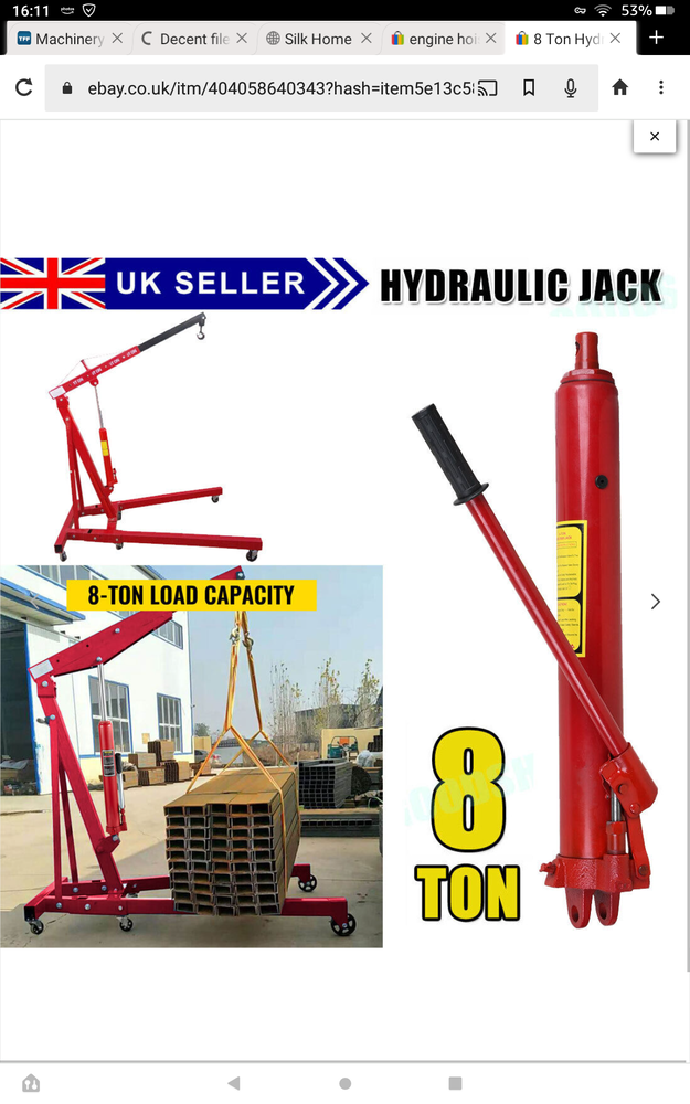

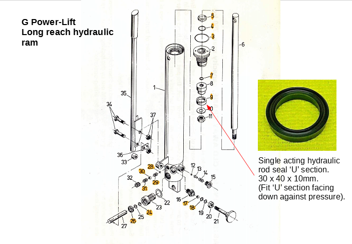

Has anyone used one of the engine hoist rams, off of the bay?
I have an old Clarke hoist, rated at 1 ton, but the ram / pump has given up the ghost. I suspect there is a crack in it, due to severely overloading it.
