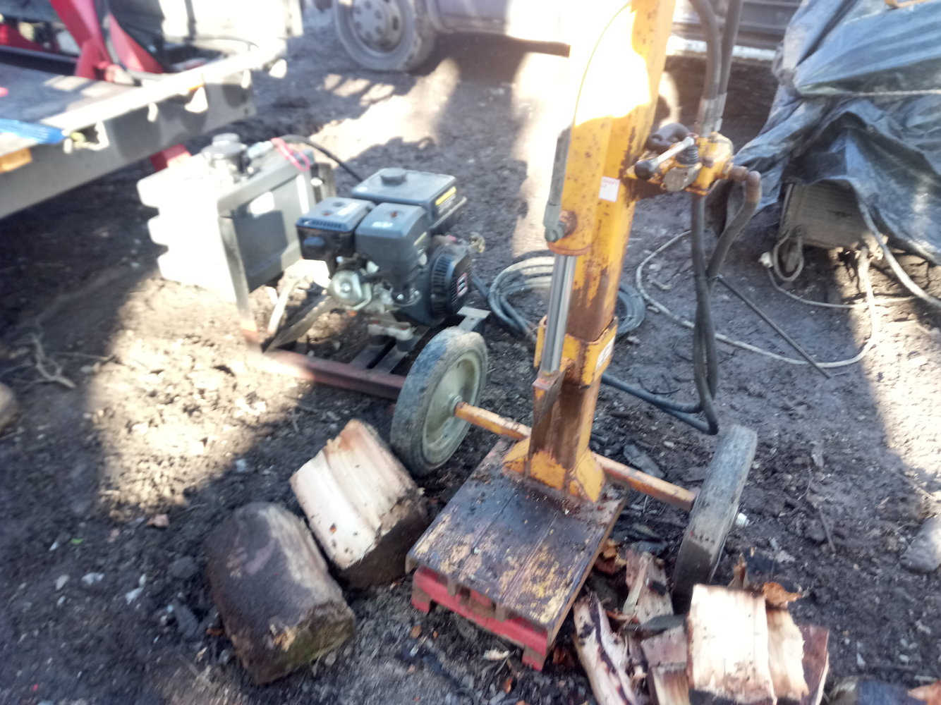

700 bar is pump pressure. I have ordered a 1M hose if I seperate the rams and use 1 I will only need 1 hose
Gotta be to get in the door of the log burnerThey look very short.
Hope you like short logs.
end goes in first not side waysGotta be to get in the door of the log burner
I was planning on the ram not having to go all the way through we will see I can always use a packer!
the blade was going to be fixed and the ram push the log through the blade.
thats how I have drawn it any way

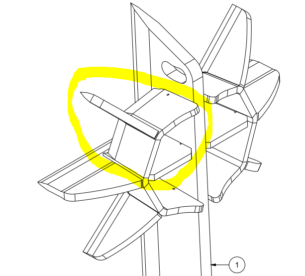

yes I think horizontal will work best with my RSJ desing, I will make a couple of blades that will be inetr changable a 4 way and a 6 way dont think I really need a staright blade although I may desing it as suck the other blades just slide over the straight blade. I was originally just going to got with the 4 way split but I have a few larger rounds here. the logs will only be going through once! sod double handling themSo I guess you are going horizontal then?
If you are resplitting doing it that way increases how many times you need to pick the log up & put it back.
With the wedge on the ram the log stays in place so you just rotate it to make the next split.
Pushing log through wedge is how a processor does it but they do all the splitting in one go via a 2 4 6 8 10 12 way wedge.
I will be dissapointed with its speed, I am sure, but the ram and pump only cost me £50! so I can always upgrade, rather get it right now though, that was why i thought about using one ram then it would be quicker to extend and retract right?I am a little concerned that you will be disappointed with its performance.
Its a twin speed pump.
On fast but no pressure its flows 3.27741 lpm
On pressure but less flow it flows 0.327741 lpm
Roughly your ram holds roughly 700cm3 on extend & half that due to the rod on retract.
At low pressure thats about 12 seconds for full stroke.
On high pressure its about 2 mins.
Ok on most you wont need a full stroke but return speeds if double acting will be about 6 seconds.
Also notice that two logs are much bigger than the other 4.
Would it be twice as slow with the 2.rams. I'm quite liking the strength and stability of the 2 rams.My numbers were with one ram.
Yes. Most only use 1 ram.Would it be twice as slow with the 2.rams. I'm quite liking the strength and stability of the 2 rams.
