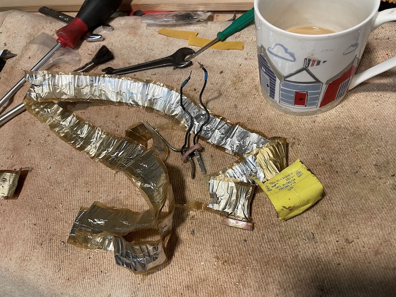

It looks to me like this capacitor is about to show me its insides. Can't seem to find one on any of the spare parts websites or eBay, so I'm wondering what I can replace it with.

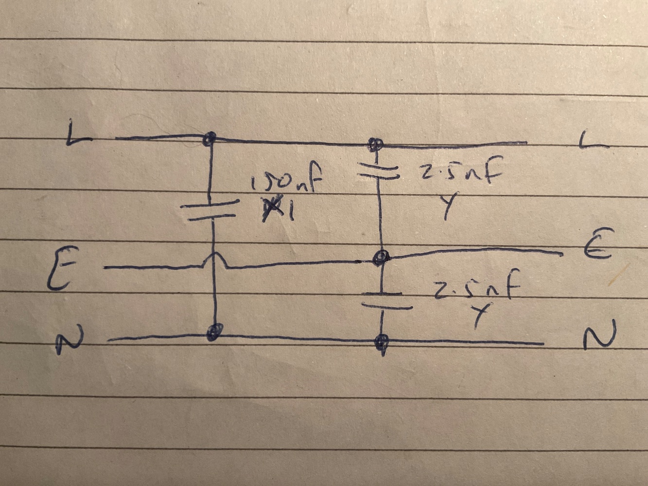

Correct me if I'm wrong but I don't think it can be an electrolytic because its AC not DC, also it has more than two wires coming out of it (didn't dare disturb it too much so I couldn't see properly, but it looks like four, maybe more??). Maybe one pair across the brushes and another across the field coil? But the marking suggest three capacitors in the one package 1 x 15 nF and 2 x 2.5 nF.
1. I'd like to replace like for like if possible - has anyone got a spare I can buy?
2. If I can't get an exact replacement, what can I buy instead, ie type and value?
3. Need an expert to decipher the markings so I know whether it's just one capacitor or whether the wrapper contains 2 or even 3.
