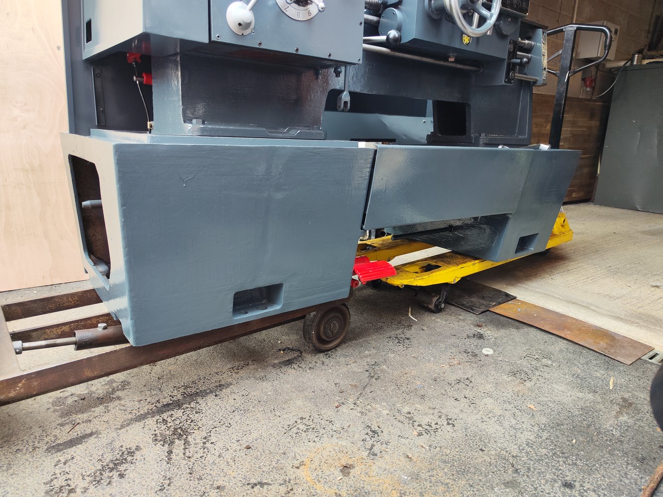

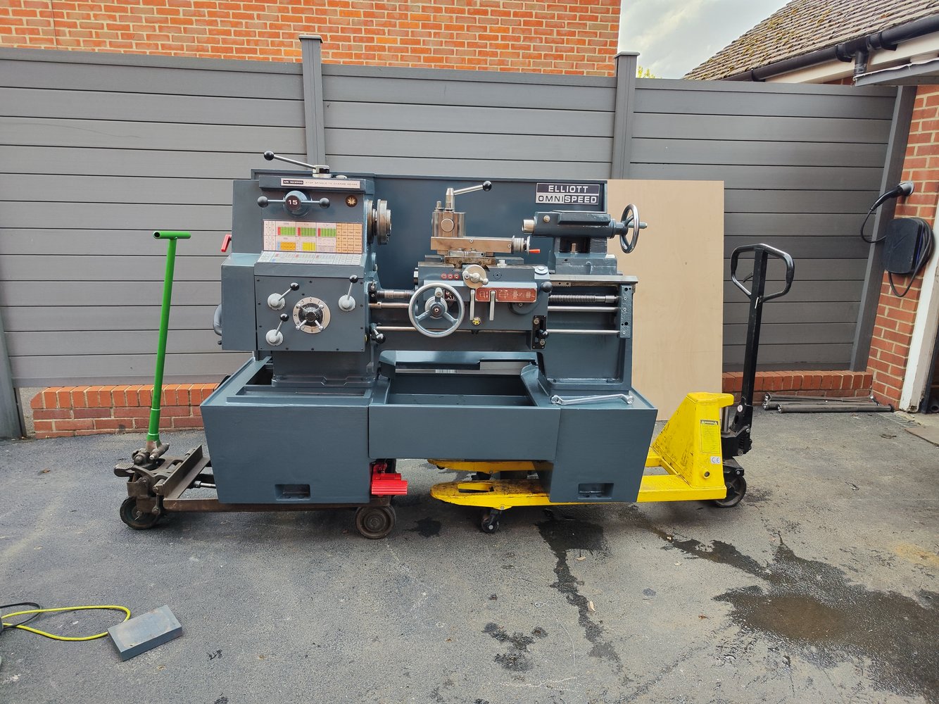

The lathe looks nice. Good work.This is as far as I got before it would not move anymore.
I pushed, I pulled, I swore, I sweated, but move it would not.
Unfortunately for the wife, she was the closest person to assist
Even with the two of us, it was not easy getting it into the garage transitioning between the driveway and the garage floor.
I also got an earful multiple times from the wife due to oil spillages and the state of the drive which I caused over the last few months.
I guess one of my next jobs is to paint some drive seal onto the drive again.

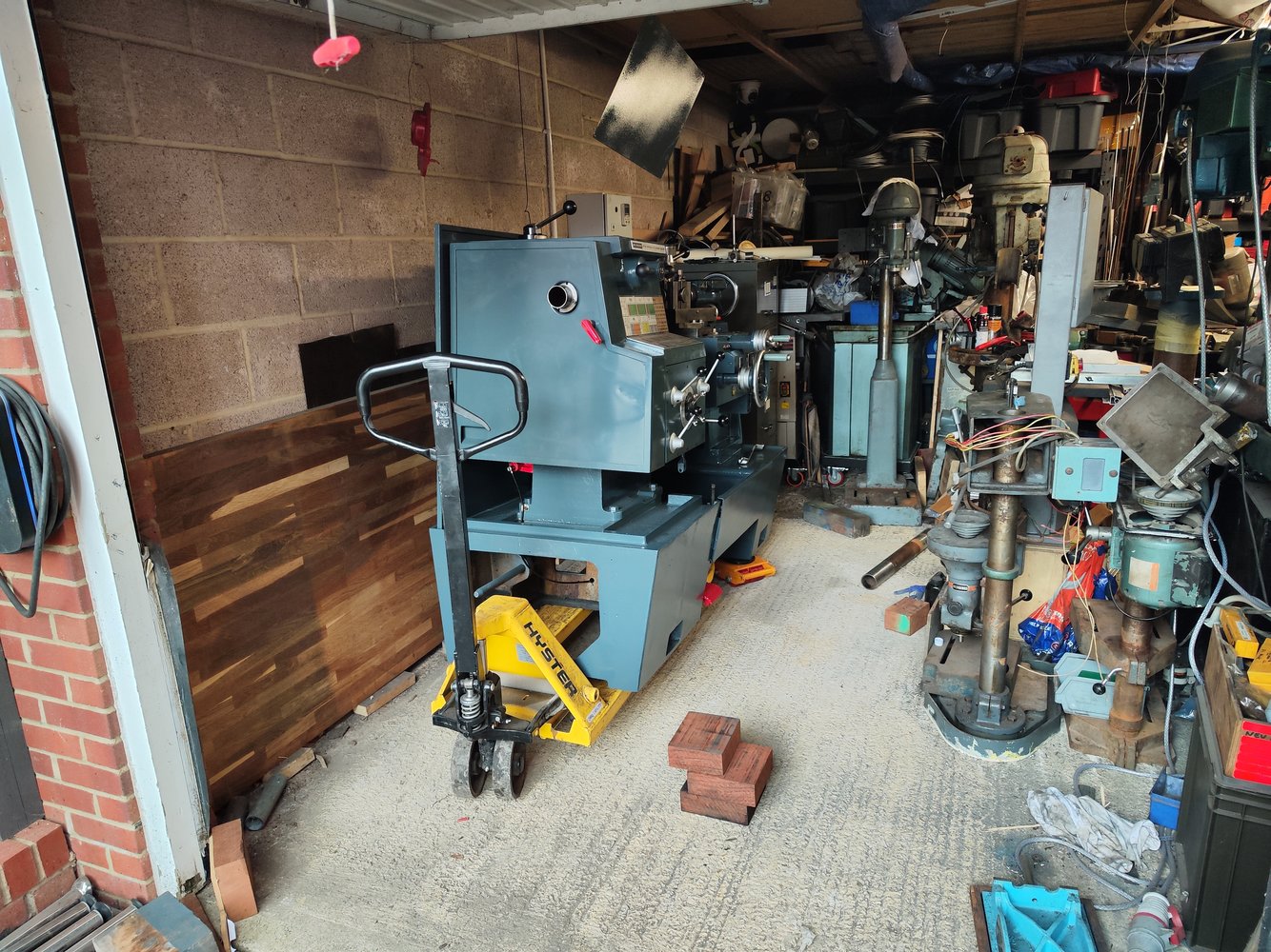

Due to my excessive hoarding and lack of space, I could not go much further into the garage otherwise I would not have been able to withdraw the pallet truck.
I had a rethink and swapped the trolley and pallet truck around and used my two engine skates for the front of the machine.
The garage floor is not very smooth and the engine skates kept sliding and turning, and I had to re-adjust them a few times until the lathe was in position.

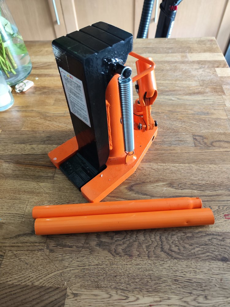

I anticipated that I would have a problem withdrawing the skates/trolley/pallet truck from underneath the lathe so I ordered a Chinese toe jack. Unfortunately, it did not arrive in time.

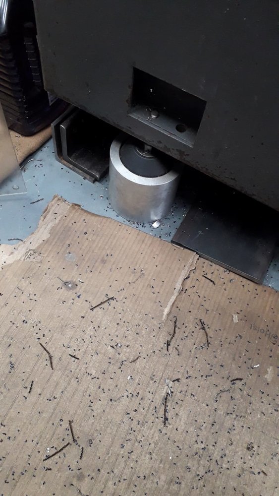

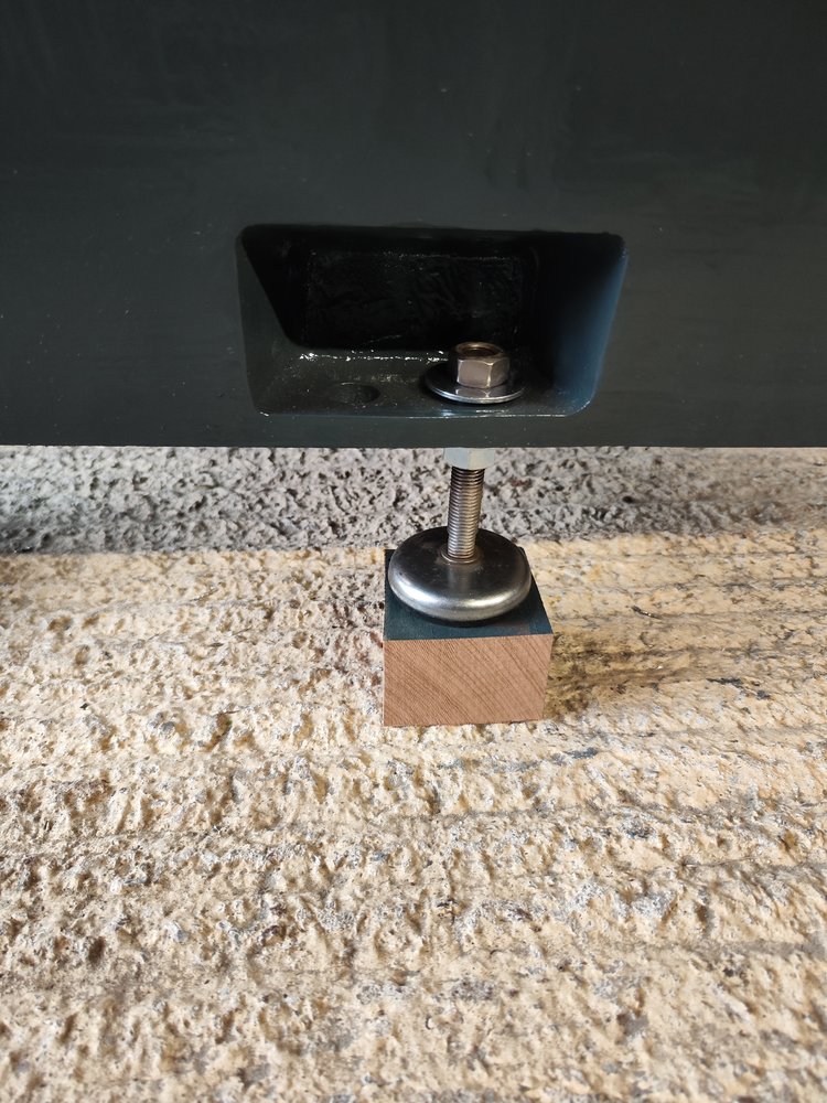

The next best thing would be to put the lathe on machine feet.
@RobCox showed me his lathe's feet and spacers.
Very fancy!
Mine, however, not so much
At least the lathe was in the garage and I could get the pallet truck out from underneath it.
I was well-chuffed with my quick bodge job until a certain guy with fancy lathe feet and spacers pointed out that he hoped the lathe would not walk off the wooden blocks if there were ever to be an unbalanced workpiece in the lathe.
Doh
I guess it is a wait-and-see situation with a rework if needed.

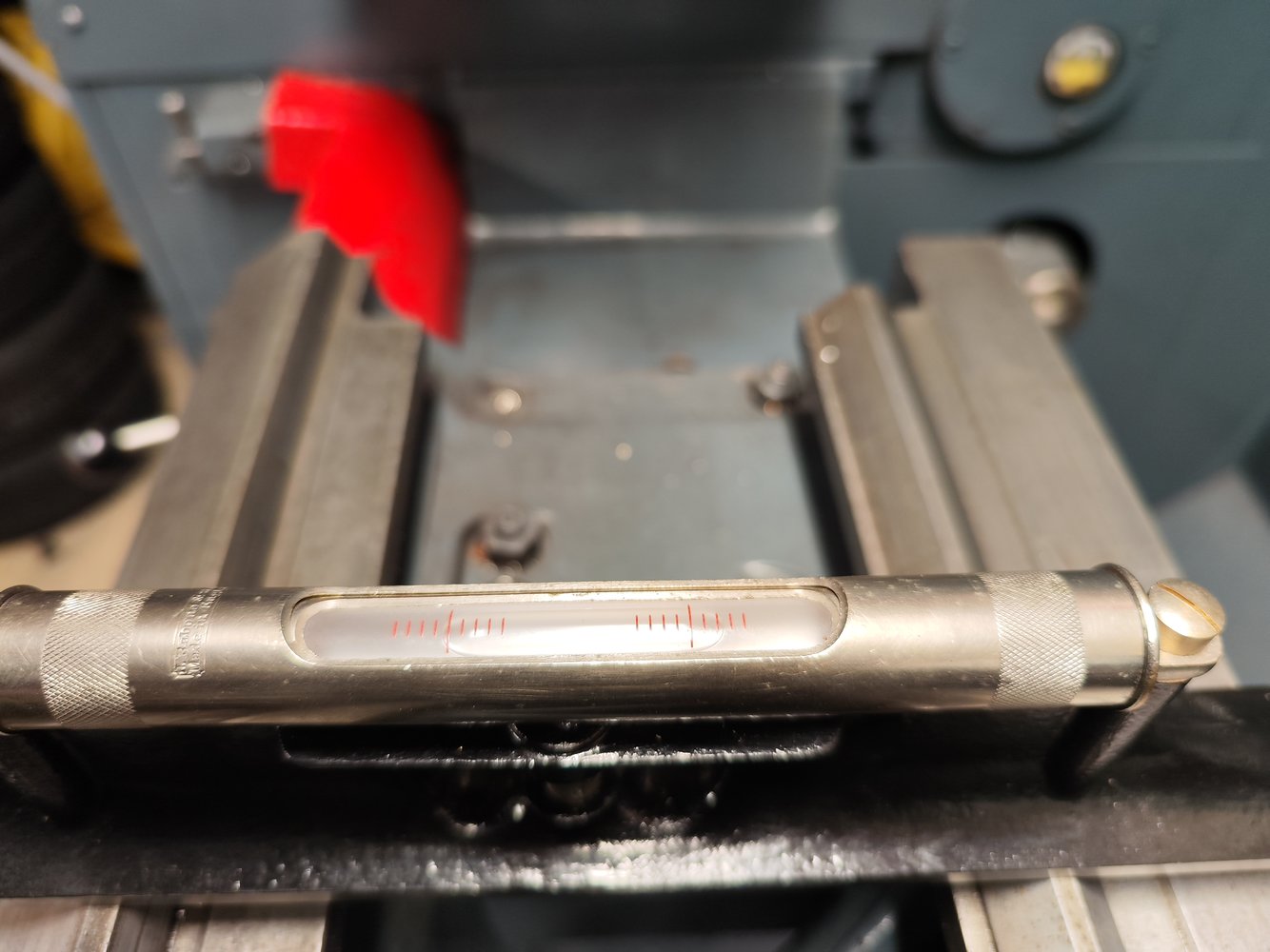

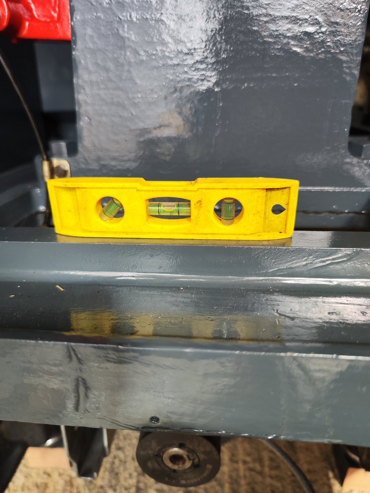

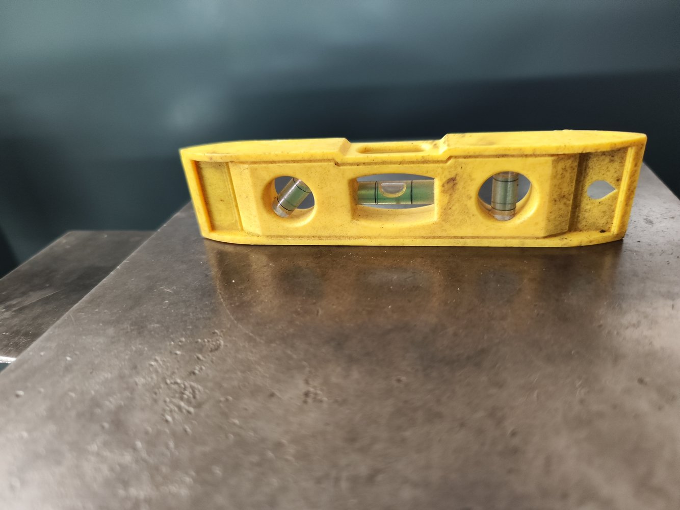

Next up was using my precision level to get the lathe set up.
Perfect! #pinocchio nose

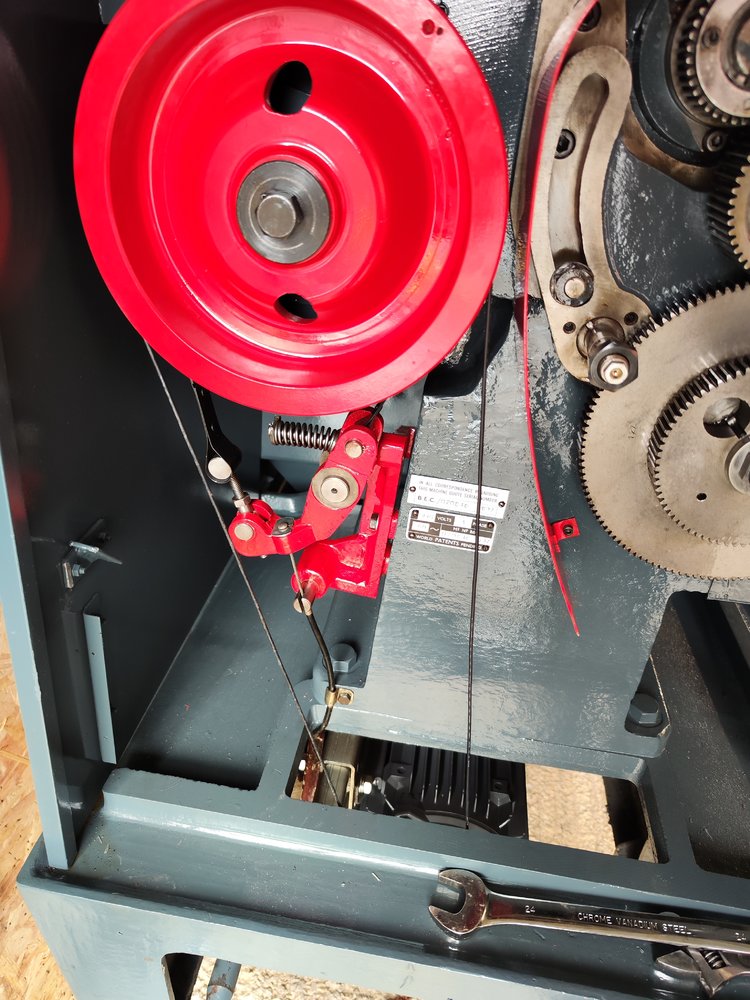

I installed the motor but could not find the old drive belts (they were knackered anyway and I must have thrown them out). I, therefore, used the super sophisticated method of measuring the inside length of the required V-belts by using a piece of electrical wire wrapped around the pulleys and then measuring the length of the wire.
I was approximately 1803mm. The closest SPZ belt with an inside length of 1803 mm is an SPZ 1837 belt (inside length 1799 mm).
There will be enough adjustments on the two motor mounts to make the belts work.

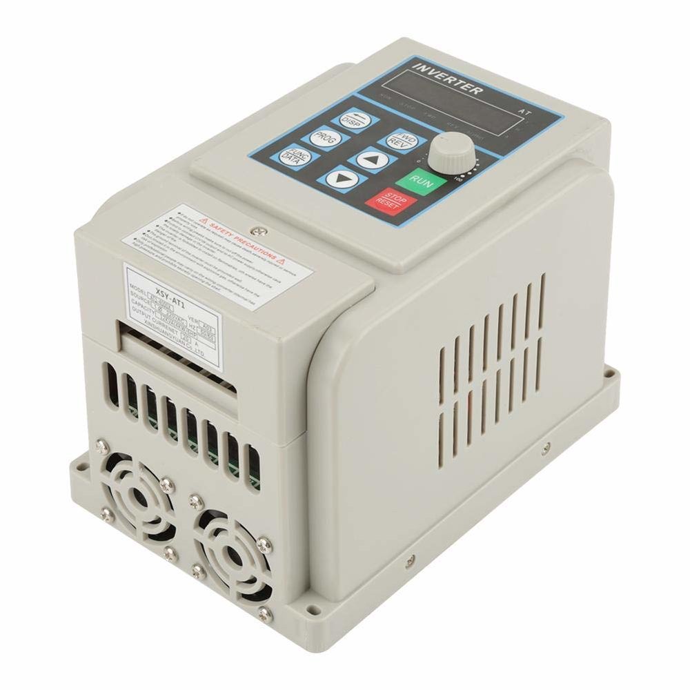

Do all the wiring and set up the VFD.
I never did find a bargain branded 3kW VFD so a trusty Chinese AT1 VFD will have to do.
I believe the biggest 'problem' with this VFD is that you can't wire/setup a true emergency stop into it.
I am pretty sure I have read something like that before about these AT1 VFDs. Further investigation is required.
Finally, guess what turned up this morning.
Sigh

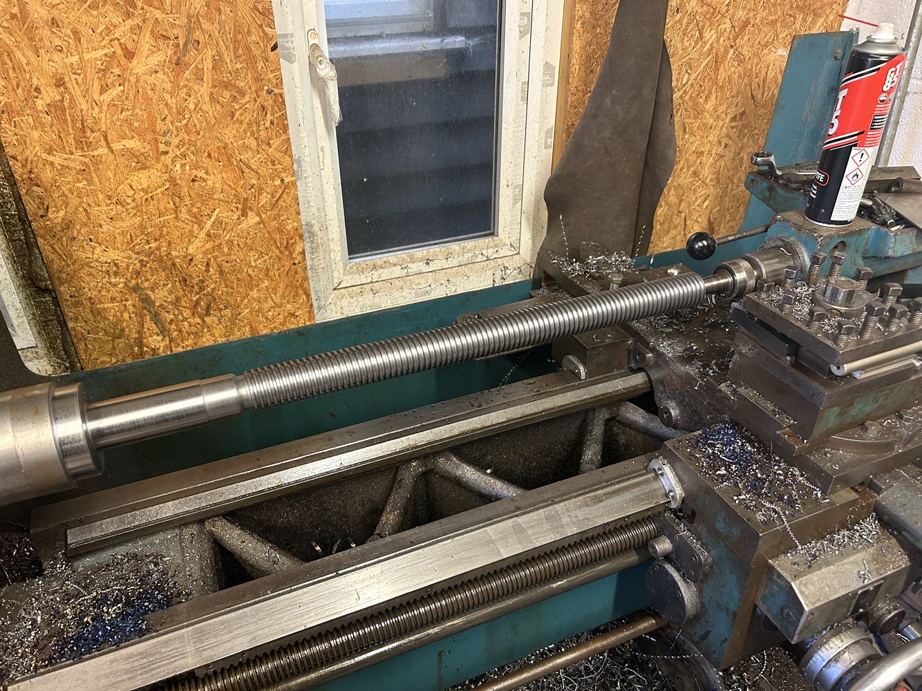

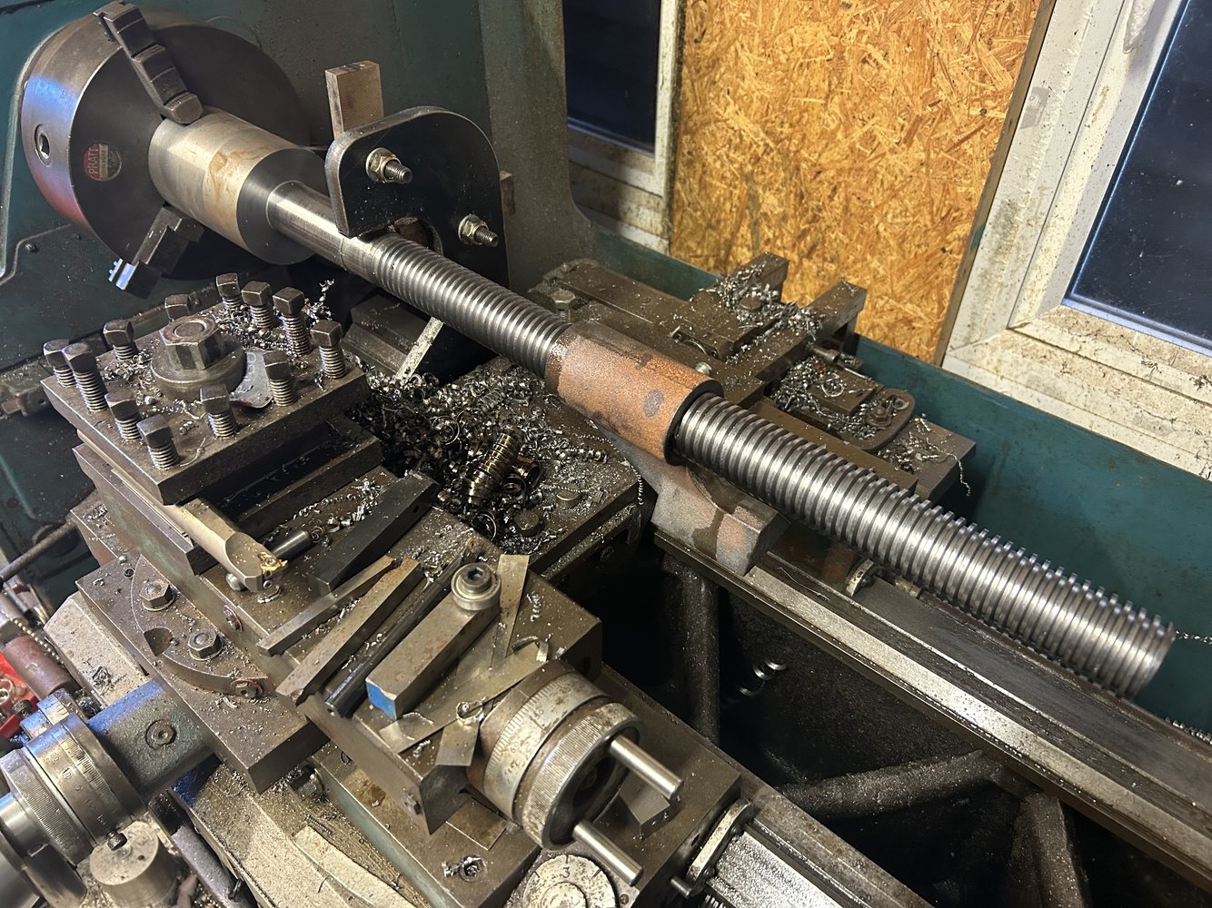

Is that a home made travelling steady you have fitted?Unintentional vice spam
I screwcut the 45mm 4tpi screws on my omnispeed after roughing out on my monarch lathe
View attachment 424519 View attachment 424520
YesIs that a home made travelling steady you have fitted?

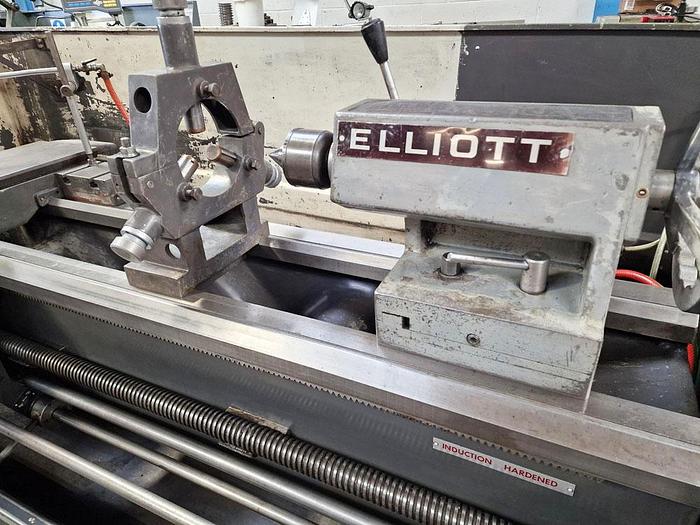

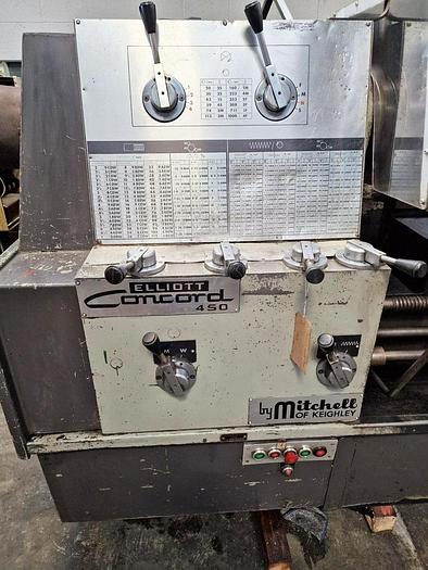

I’m actually struggling to find a manual for it, but going to assume that it’s 90% the same as the model that the digital pdf is available for.Welcome
I've never seen that type of gear change in the manuals... will be interesting to see your progress
Even the tailstock seems different
Do you have the nylon slipping clutch by any chance on the apron?

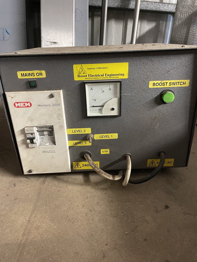

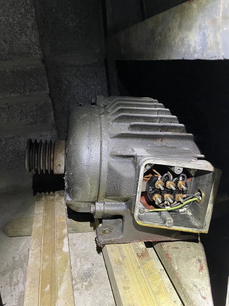

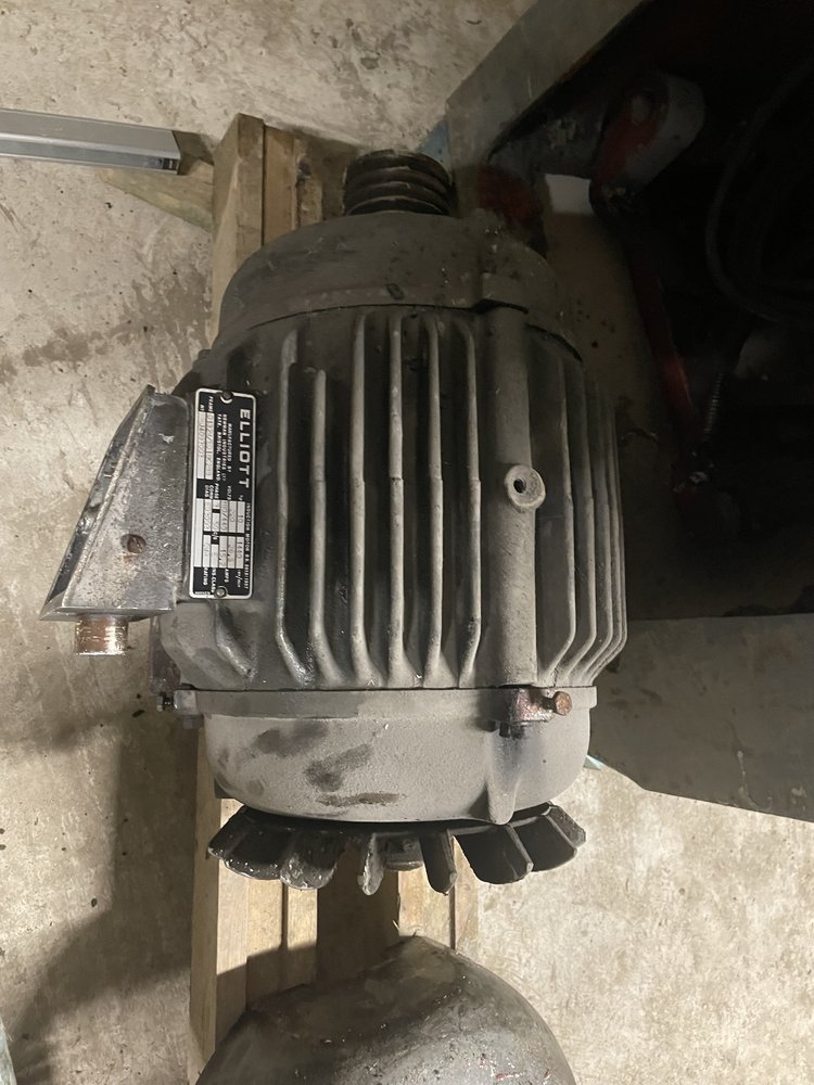

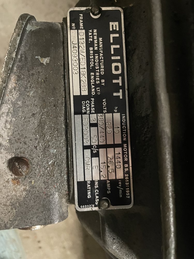

Managed to get big Bertha out (heavy lump) and cleaned the faceplate off (pictured). So I’ve got the details now, which helps inform my choices. There is a static phase converter in work I am going to have a closer look at (pictured), however I may switch her out for a smaller as you suggest and a VFD. I’ll keep on keeping onI am running a VFD on mine and so is @Pawcu. My original motor was a little too big (and also 440v only) to be easily run on single phase power so I swopped it out for a 3kW one.
So far, I have not needed extra power.
I got my first lathe (Warco) just over a year ago and then refurbished my Elliott, I think you will be perfectly fine.
Loads of clever people on this forum who helped me with numerous things. If you ever get stuck, just ask, someone will be along shortly to sort you out.
In regards to the manual, I think you are correct, 95% of the things will be the same.
Nice!Managed to get big Bertha out (heavy lump) and cleaned the faceplate off (pictured). So I’ve got the details now, which helps inform my choices. There is a static phase converter in work I am going to have a closer look at (pictured), however I may switch her out for a smaller as you suggest and a VFD. I’ll keep on keeping on
View attachment 425273 View attachment 425274 View attachment 425275 View attachment 425276
I think it is was probably one of the last versions (most modern) of the Omnispeed lathes they have done.10hp? :O
Like @Smouser said, 10hp might be a bit excessive xD Will be easier to go with a smaller potentially more modern motor and couple it with a VFD

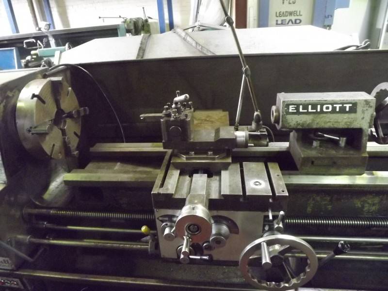

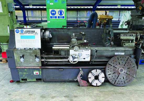

I am even more curious now about this machine - I cannot find anything in the manual about a 10hp motor variant... that coupled with the different front gear selector and tailstock makes we wonder if this is another variant that is not listed in the manuals? Do you have a serial plate on the machine that tells you the date and serial number?![]()
You're right it does look very similar... good eye!I think it is was probably one of the last versions (most modern) of the Omnispeed lathes they have done.
I have read (on the lathes.co.uk site) that the Omnispeed was built and imported from Eastern Europe but there are no mention of the actual manufacturer/factory that made them.
The tailstock looks similar to the Elliott Concord lathe to me.
I’m hoping to have a bit of time next week to have a good nose around the machine and finally decide on a motor setup. I’m 95% sure I’ll go for the smaller motor and vfd setup (there are even ‘packages’ with a motor and matching VFD etc that I’m going to give some serious thought to).10hp? :O
I live just outside of Cardiff (Wales) and would have really liked to have had a “local” modelI really do love these Elliotts. The older ones were amazing quality and made in Cardiff. I know the later ones are Eastern European but they turned out some pretty good machines as well and Elliott still had their reputation to think of. The high top speeds attract me - much better for carbide tools.
If you can find a matched pair that would be great. Not sure how much that will cost you but vfds off aliexpress are quite cheap and tbh can't complain with mine... Though I don't use mine every day for prolonged periods so...I’m hoping to have a bit of time next week to have a good nose around the machine and finally decide on a motor setup. I’m 95% sure I’ll go for the smaller motor and vfd setup (there are even ‘packages’ with a motor and matching VFD etc that I’m going to give some serious thought to).
As far as a serial etc goes, I’ll have to examine (and clean!) further, it’s not on the bed where a Colchester may be.
I’d love to find a manual dedicated to this model.

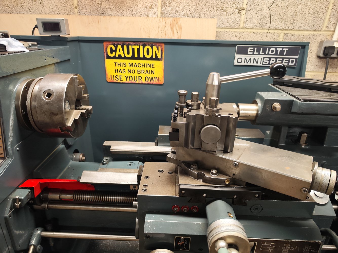

Installed a safety sign so I can hopefully keep all my fingers.
No grabbing stringy swarf with fingers!
