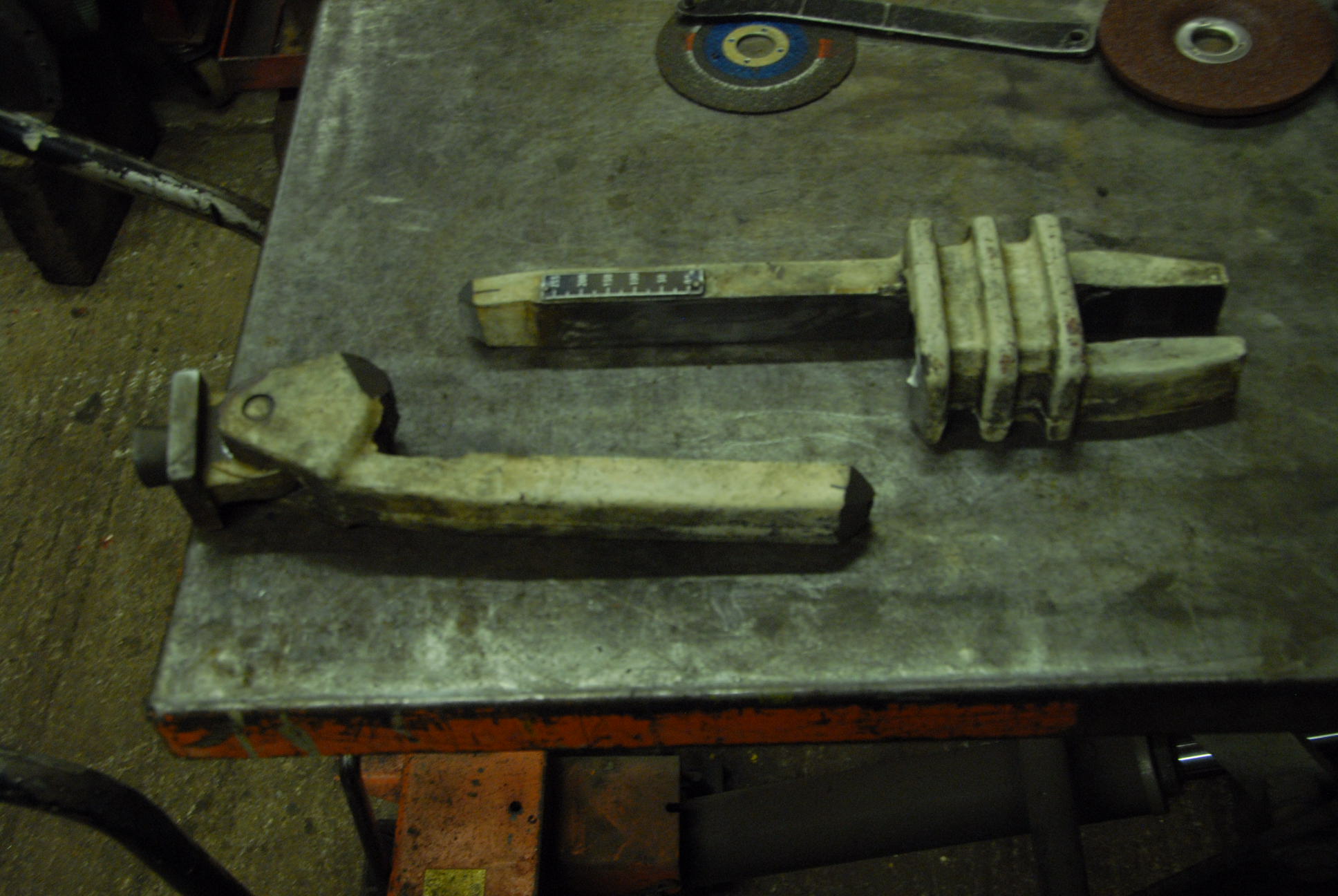

At the moment I'm having to make a stock Bin rack as the t'other uns collapsed/ Using ali weld skills, or lack of. Workshop is a bigger s'heap than ever.Here's an idea, here's a pic of how I repaired my Alba shaper, the part you're having trouble with broke clean of, oh what fun that was!

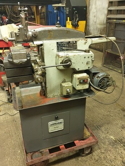

Your Alba is a heavier set machine than the Elliot, but very similar. He use the opposite approach to the one in the Elliot manual i.e. set in the vertical, but then no opposing force to the tightening of the adjuster nut, which is the main issue.
