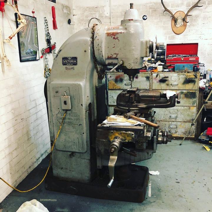

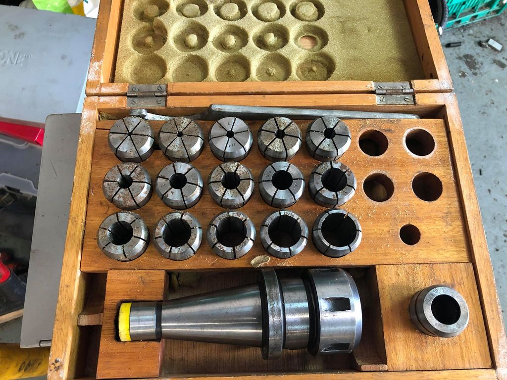

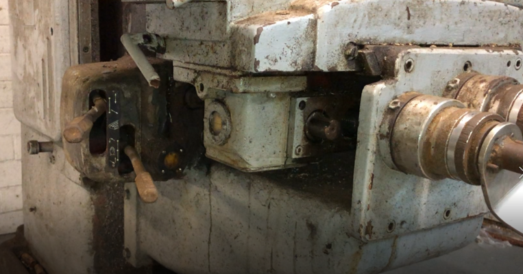

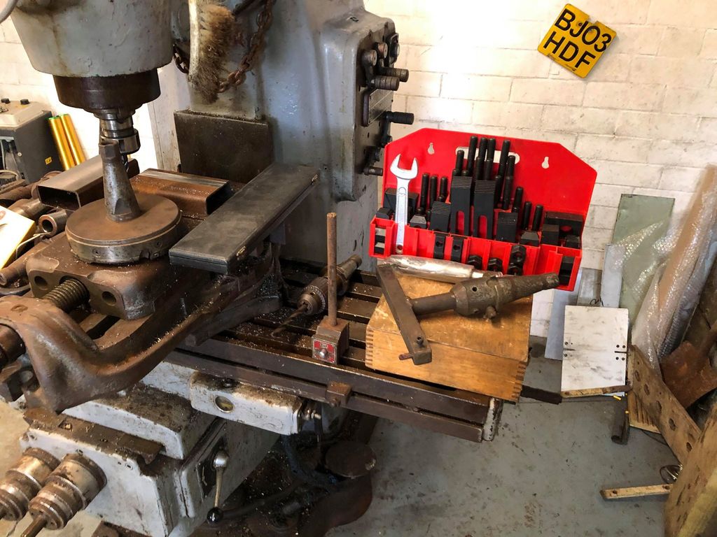

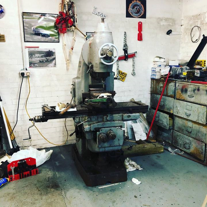

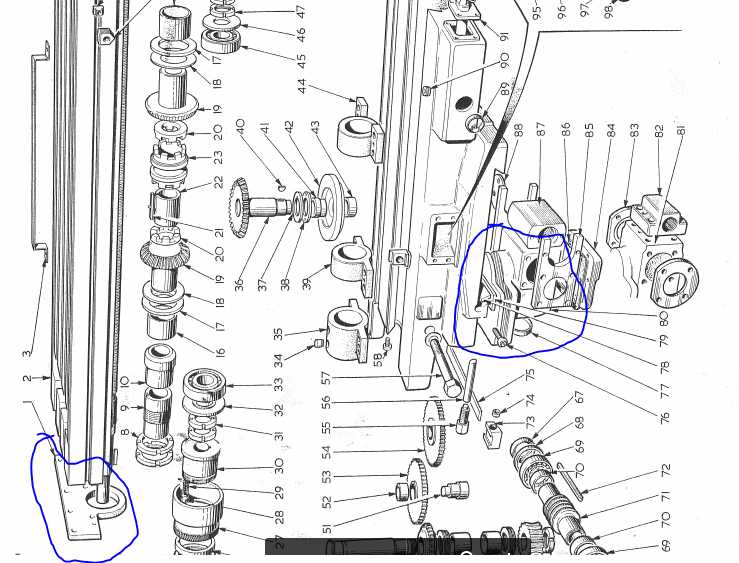

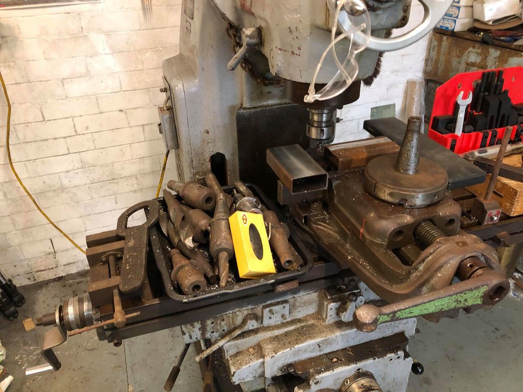

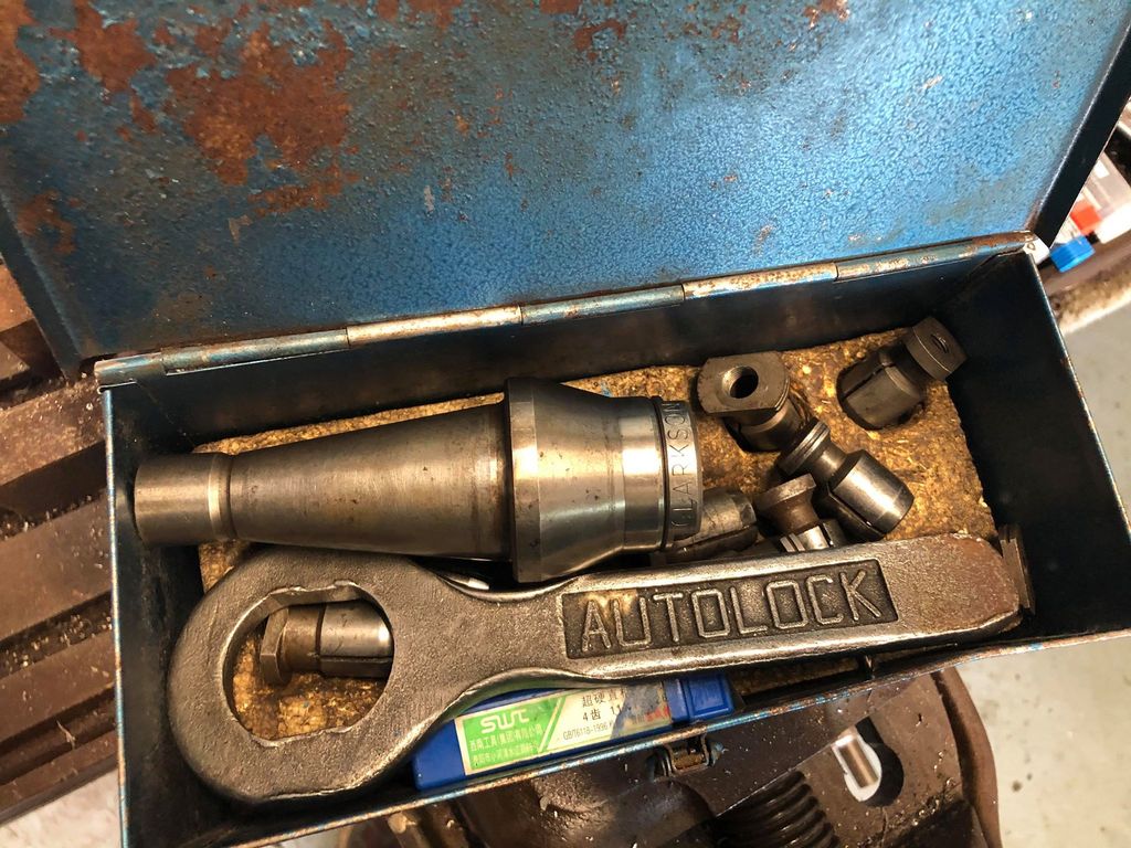

not long after this Victoria V2 popped up for much cheapness, it had also been converted to 240v ( using something high power enough to flicker the lights when i switch it on ) which cut out the need for the cost of a rotary converter ( and the time spent diy wiring one up ). it is a bit of a project, the table end bracket had a crack through it, which ive managed to weld back together ( which welded wierdly well for cast iron) until i can get another, the worm feed box for the table power feed has a crack running around it, to make that worse its also what bolts to the Y axis lead screw nut which is giving me a fair bit of backlash, and the shaft from the gearbox to the table power feed shaft is missing, so i currently have no table powerfeeds.

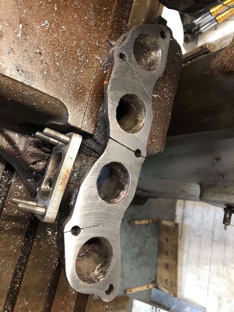

Upside is, it cuts! i have used it to bully some poor bits of offcut steel box and it came with a pile of tooling. its first real job was to flatten out my cars turbocharger manifold as it had taken a bit of a warp in welding. im still playing about with it to get used to how everything works. but the plan is to try and replace the damaged bracket/ worm drive box. come up with a power shaft and then use it for mostly car related stuff as thats what i spend most of my time doing outside of uni.

if anyone has any parts for this mill please let me know as theres a couple of bits i need as ive said earlier.
