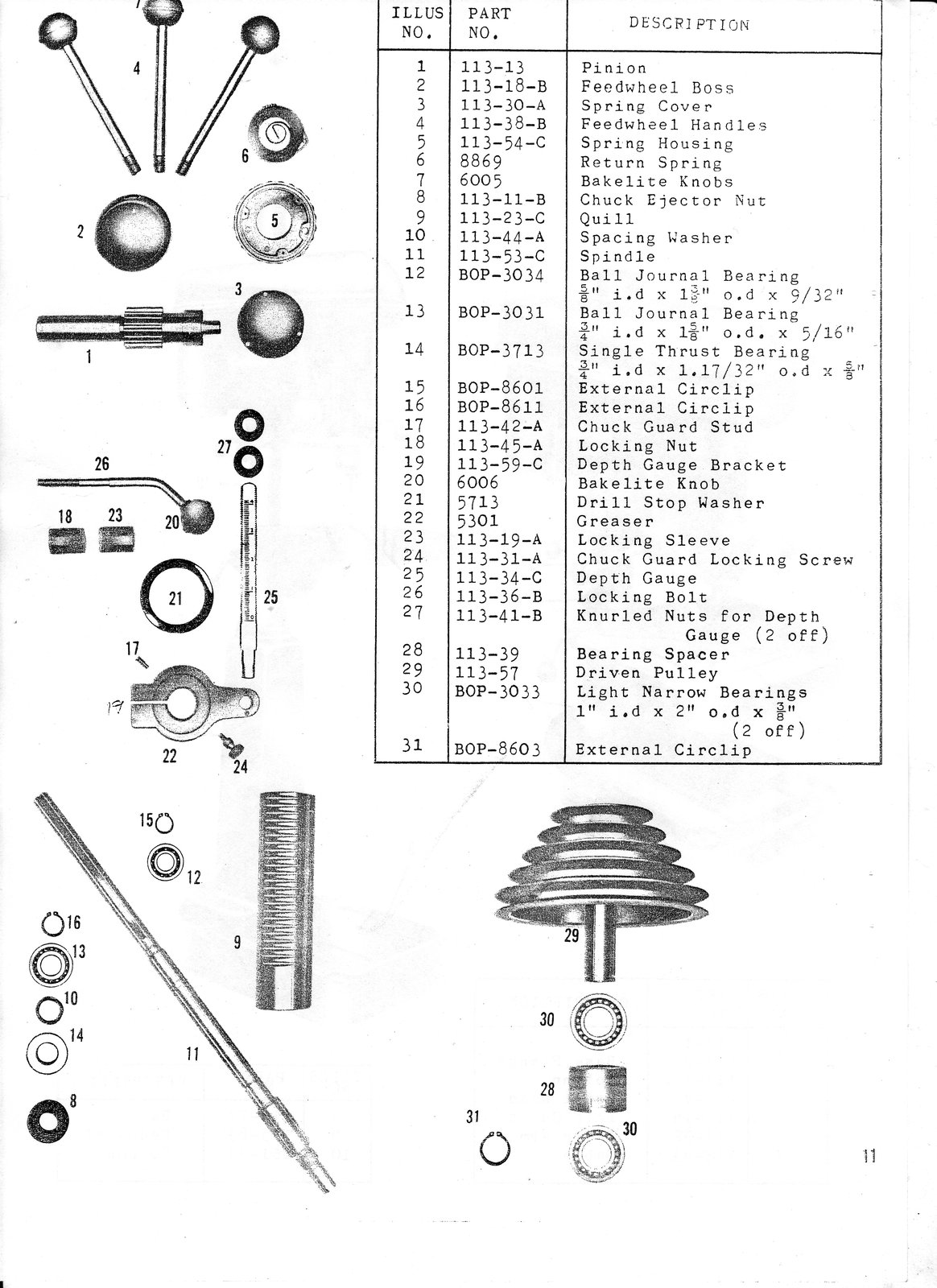

That knurled nut is called the "chuck ejection nut" according to the manual. Item #8
Can you tell me what 30 is please ? That looks like the right bearing but can’t make out the measurements. Not to worry found out how to see the attachment directly. 1” x 2” x 3/8”
