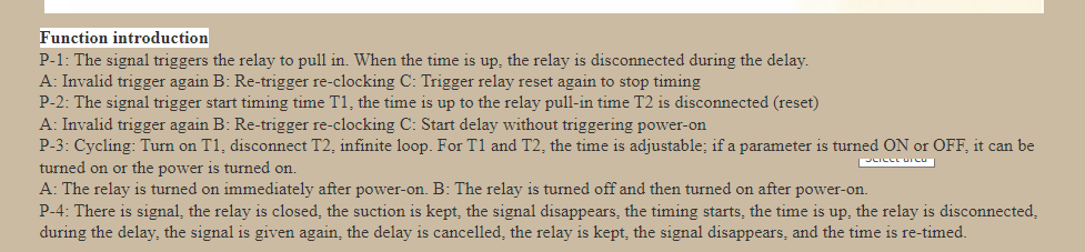

cheap time clock looks the way forward but thank youThis zero-to-60 seconds timer is a lot cheaper than £103.50 :
The main time switch that I linked to previously could trigger this one, which then will run the auger motor for the selected short "ON" time.
