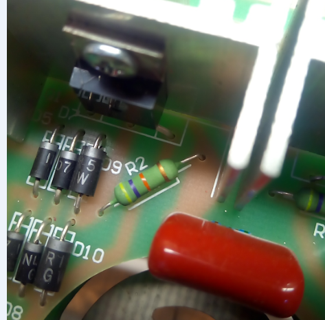

That's them. Motorolo MJE13009. My ultrasonics kept blowing the MJE13007's so I uprated to the 13009. The resistors are usually a long square white ceramic type that sit in the collectors and I suppose they act like a fuse as they always go with the transistors. I've always suspected that my machines were 110v by the look of the design on the board and the Chinamen just altered a few components to get them to tolerate 220v. Heat sink compound is a must if you replace them.ah ok, that would explain the fuse, definitely looks shattered more than blown...

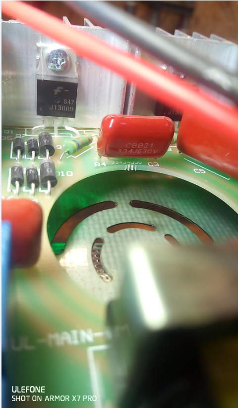

had another look at it just now, took a clearer photo of the resistors
I had to go and look up darlington transistors, ok if I understand correctly, what I thought were "mosfets" are actually darlington transistors then?. there's not that many resistors on the board just one each besides the transistors.... J13009 would that be the reference?

What!! Are you sir, implying that some far eastern manufacturers cut corners - surely notI've always suspected that my machines were 110v by the look of the design on the board and the Chinamen just altered a few components to get them to tolerate 220v. Heat sink compound is a must if you replace them.
, will have to go back and reorder that....thanks @Alan Reynolds well spotted never thouught of that... Has the resistor actually blown? If so maybe get a higher wattage one in when you get replacements might be a bit marginal?had a look at the dimensions, and if google is right, the existing seems to correspond to 0.5W (more or less) while the new ones I have are only 0.25W, so no good...
, not that's ever stopped me cracking on with it before ....can you not solder two of the new resistors together ?
