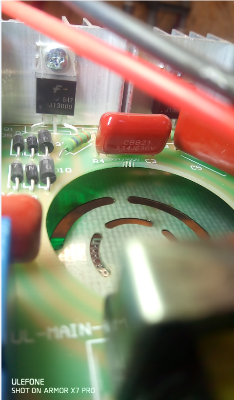

Yesterday, while waiting for the heater mod to the 30 litre tank to heat up test, been looking at why the little 3 litre tank ultrasonic had crapped out... just not got any bzz bzz
heater worked but nothing from the ultrasonic side. Just shoved it to one side, but had a wee bit of time on it so had a good look at the boards, and think one of the components has gone. A fuse I think, best as I can see a 3.15A? would that be right? looks more like it's cracked rather than blown (the glass is all crazed) either way certainly has no continuity across it.
Where would you get such a small fuse, what would they be called? doesn't look like the fuse can be changed, soldered in... Are they anything special, or could I solder another fuse across the "legs" and cutting out the original? I have some small capacity slow blow fuses, but they're physically way bigger than that one.
any advcie gratefully appreciated as usual... cheers
