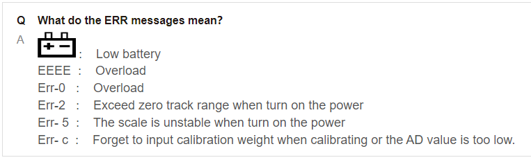

Here's the error codes from the Furi website.
Not too helpful really, it could possibly be down to one of the resistors in the load cell drifting.
You could try measuring the output of the load cell with a multimeter, power it up and measure the voltage across S+ and S-, it should be pretty close to zero and increase with some load, not sure how high the circuitry expects it to go, probably no more than a few mV. Check E+ to E- too, should be some constant, "normal looking" voltage, you might be able to trace E+ back to a voltage regulator (Or the power supply) and determine what voltage it should be.
You could also desolder the load cell and measure each resistor individually. They're wired as a "whetstone bridge", under the epoxy there's four resistors, three normal and one designed to stretch and change it's resistance when the cell is flexed. They're wired like this:
Red and black leads are the top and bottom of the square, green and white leads are the left and right points. The resistors are probably all the same value, but if not, the ratio of R1 to R2 should be the same as R3 to R4, if one is miles out then it's probably shot, I don't think there's any saving it.
