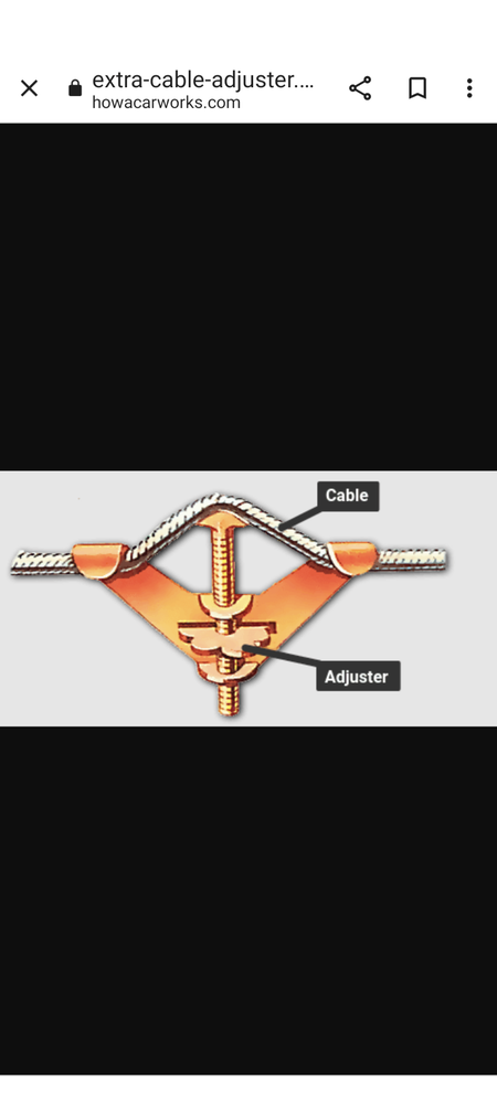

The stretched cable issue was more of a problem in the 80's. I've changed several, where you are out of adjustment at the lever end due to cable stretch. It was quite common then, to the point of motor factors selling a device that sat on a straight stretch of cable and you screwed it in to take up the slack. I can't be the only one old enough to remembers these! I think they became illegal for an "MOT work around" at some point though!
Maybe the cable quality has improved.
