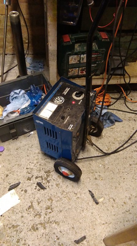

I've got a massive 40 amp battery charger if that'll be any good.

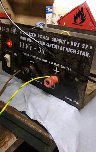

I thought, because it's effectively a dead short, it would draw as much current as it can. I've got a half built bench top PSU, but I never bothered finishing it.The setup will only draw what it needs current wise.
A stronger solution is better or worse?
What effect does voltage and current have? I
	 (You can probably make out from the photo that it's running 12V, 1A or so there). I've do have a higher output unit, but I've never felt the need to hook that one up. The small one has dealt with everything fine so far, and I've done some fair size pieces. All of the vices, the large Rapidor, the Drummond 5" bits and plinth/leg etc., they've all been derusted using that PSU.
 (You can probably make out from the photo that it's running 12V, 1A or so there). I've do have a higher output unit, but I've never felt the need to hook that one up. The small one has dealt with everything fine so far, and I've done some fair size pieces. All of the vices, the large Rapidor, the Drummond 5" bits and plinth/leg etc., they've all been derusted using that PSU. Aluminium is a possibility too, though the tests I did with that were patchy in result. Some worked, some didn't.
