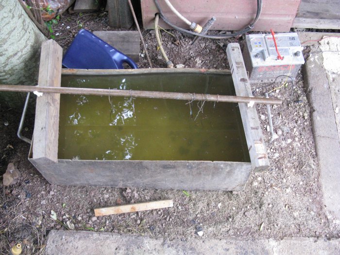

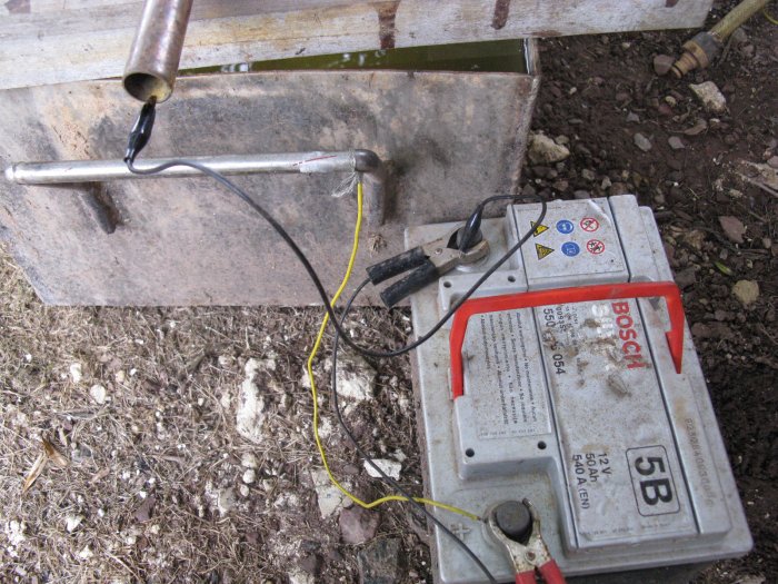

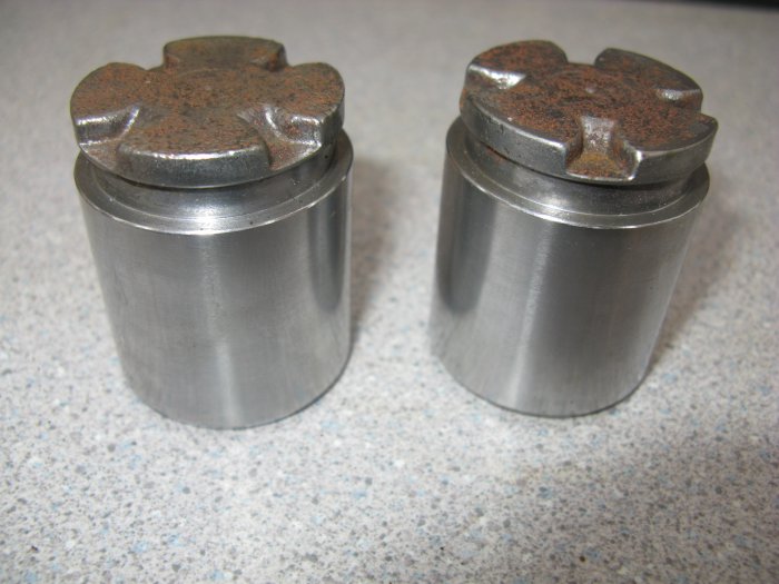

Also it is MUCH better to completely immerse the part - the bit sticking out won't be derusted!
Doesn't that have an effect on the battery charger clamps, as they would need to be immersed? Or would they be OK because they're not rusty to start with? I thought about using some old thick copper wire between clamp and workpiece, if that would be better. For me it was no big deal to just put the piece in again the other way up.
But I'm just starting out with this, using the bucket I normally use to wash the car, so taking on board all these suggestions.
