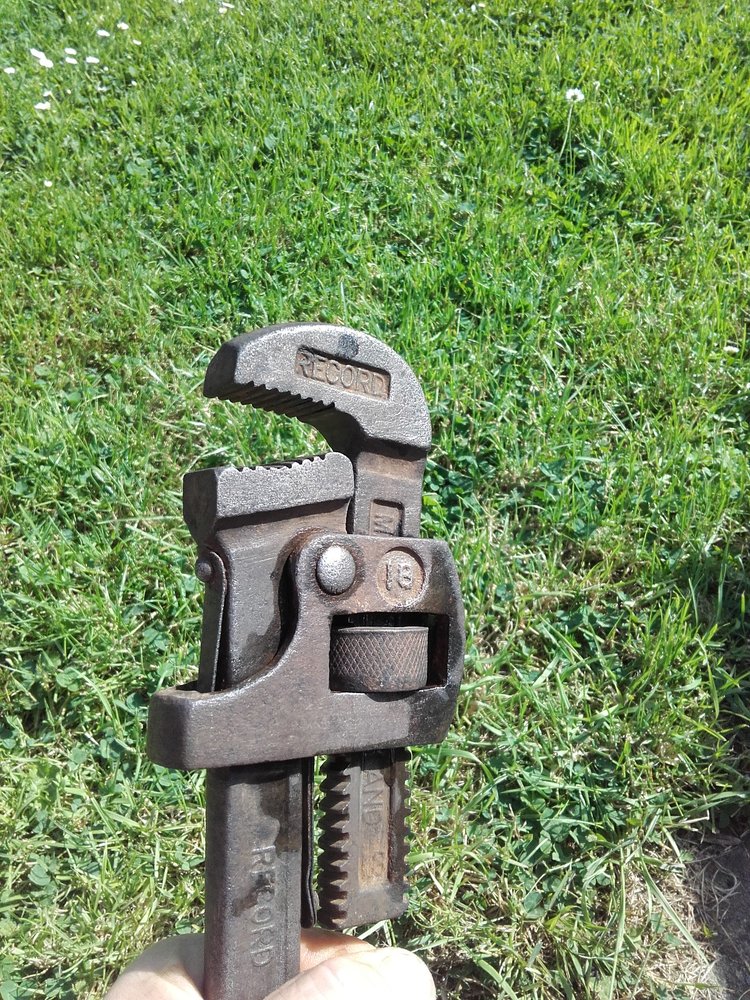

@Dilkris asked about my electrolysis bath using bolts:
Needed to derust a couple of steel wheels.
And to think everything in the photo was being thrown out!
My 38 year old CB pack made from a battery charger:
10ml of these per litre, so 350ml into 35 ltrs of water:
And leave to ferment:
Safety first:
