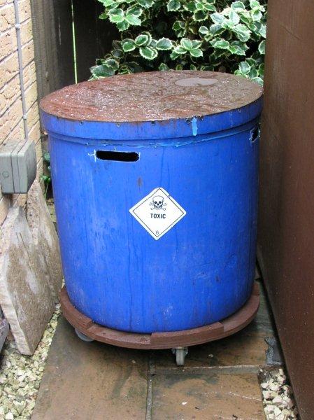

Watch this space!!! I have 3 tanks on the go, one in baby size, one in mummy size and one in the daddy size!
Are you going to put porridge in them?![]()
They've been in the tub a week or two now. Suppose I ought to get them out.
