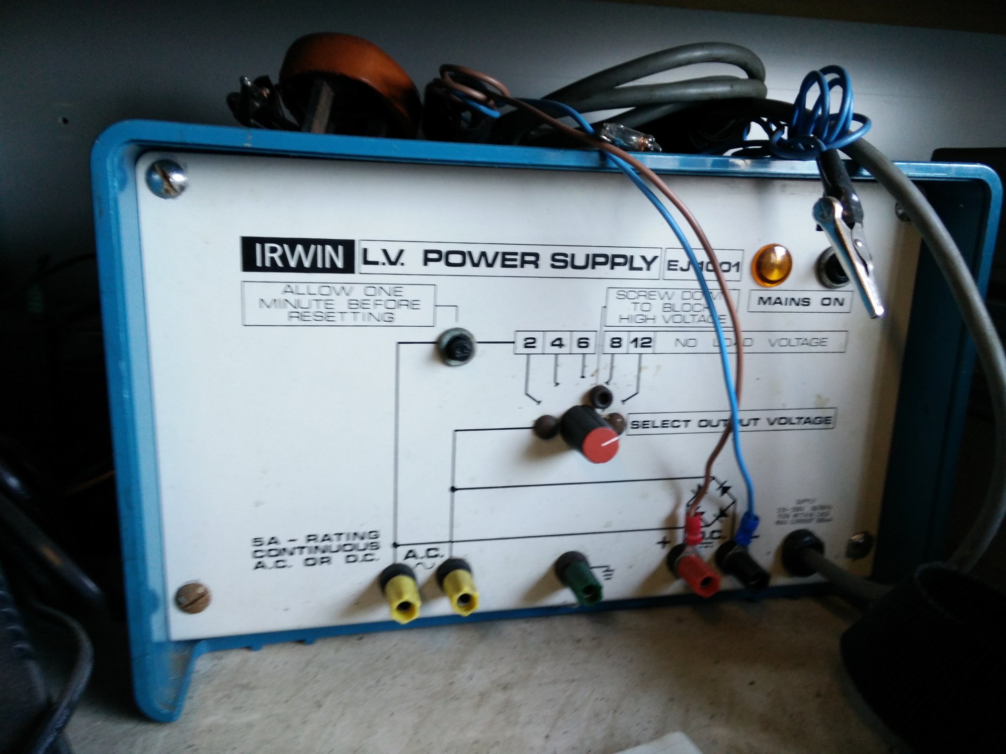

I have an old PC power supply with a bulb box for current control I built for plating. I also have an ancient variable voltage bench power supply I liberated from a skip at school. I just use these nowadays, there is no real need for such large currents.
