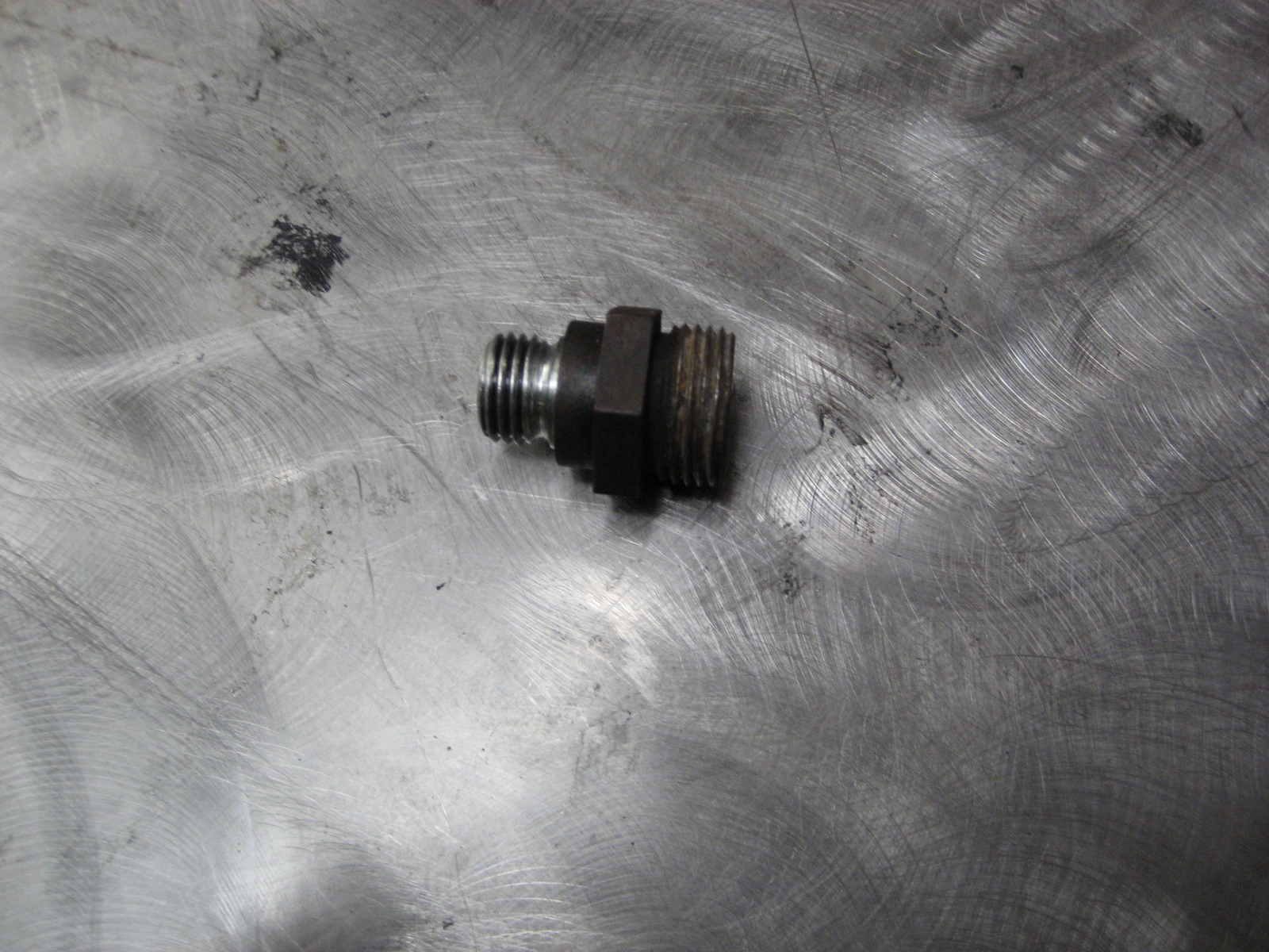

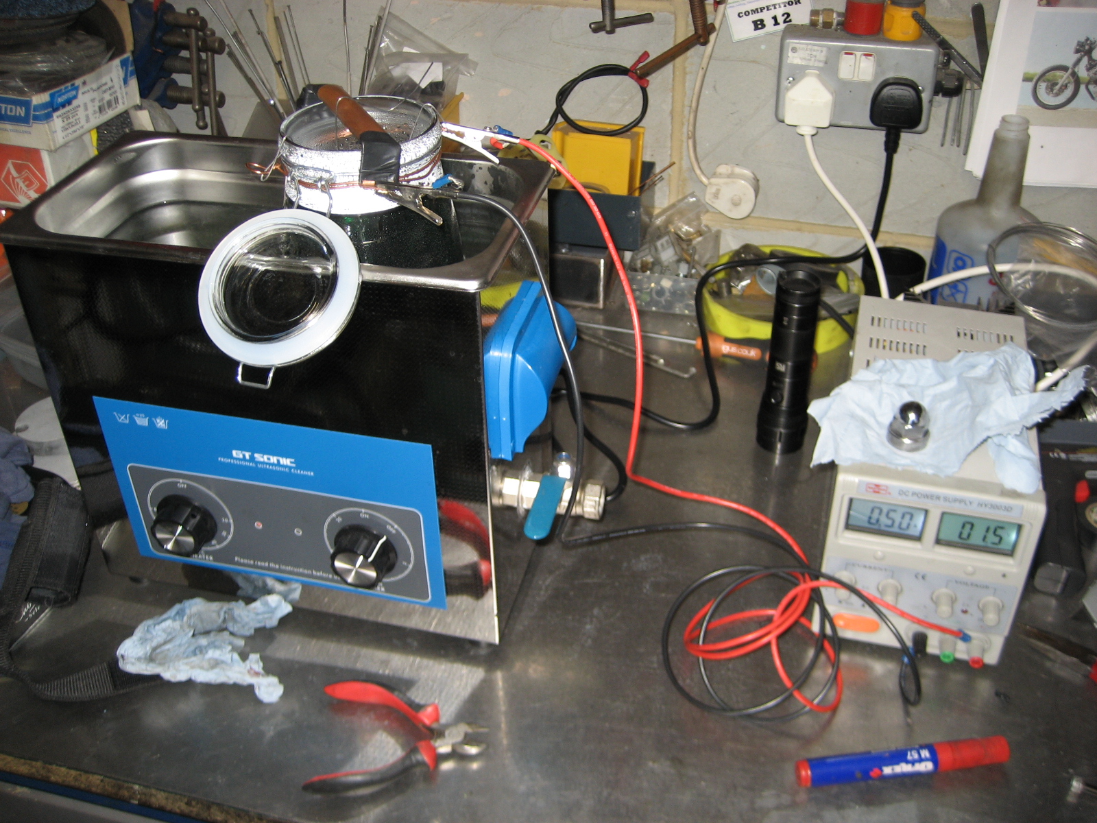

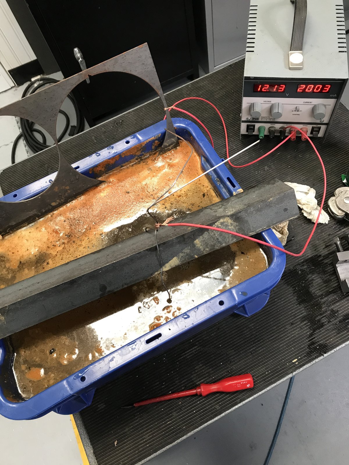

followed a few YouTube instructions and came up with something suitable. Used a bench power supply instead of a battery charger for a bit more control. 2a max seemed about the sweet spot.

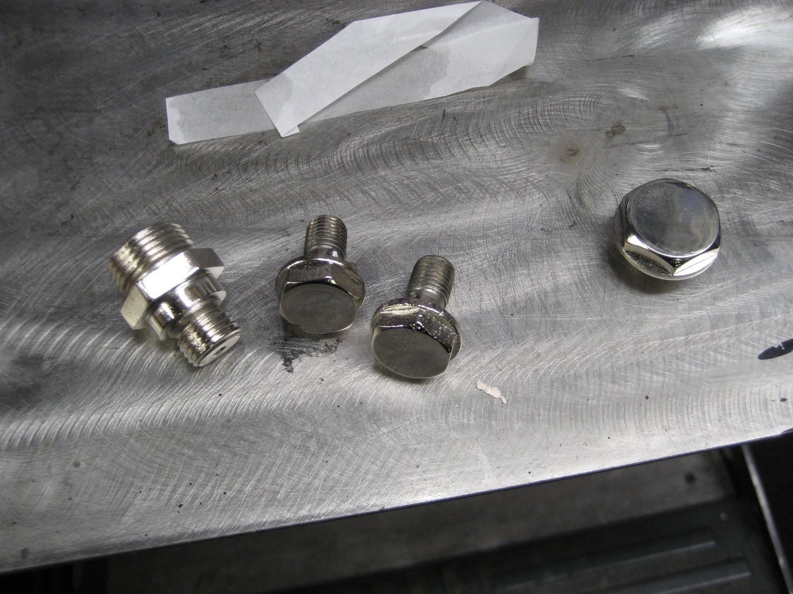

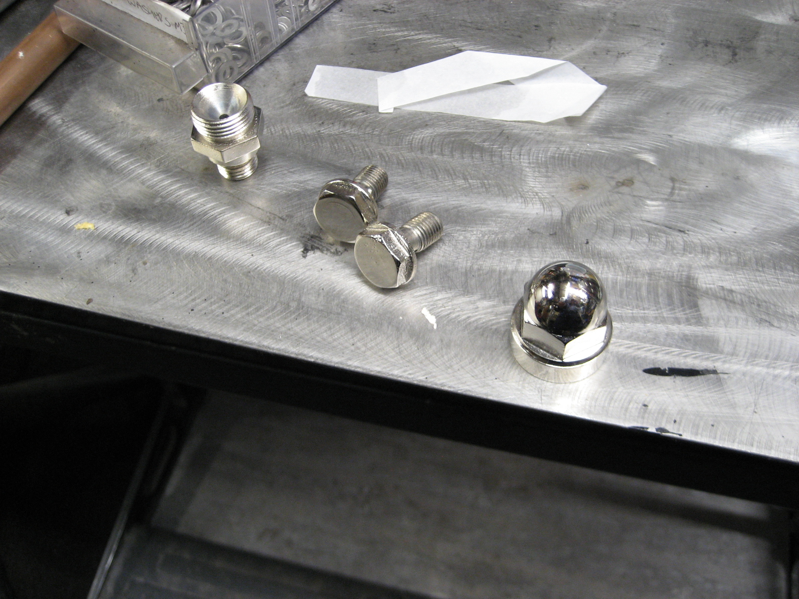

Didn’t have much faith but by crikey - it’s bloody brilliant.

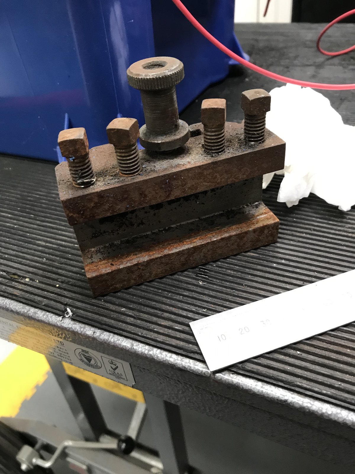

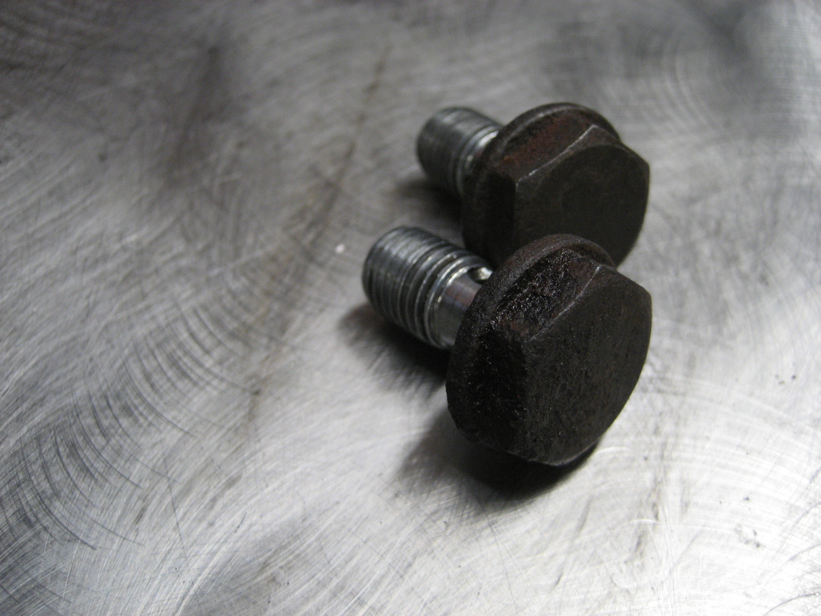

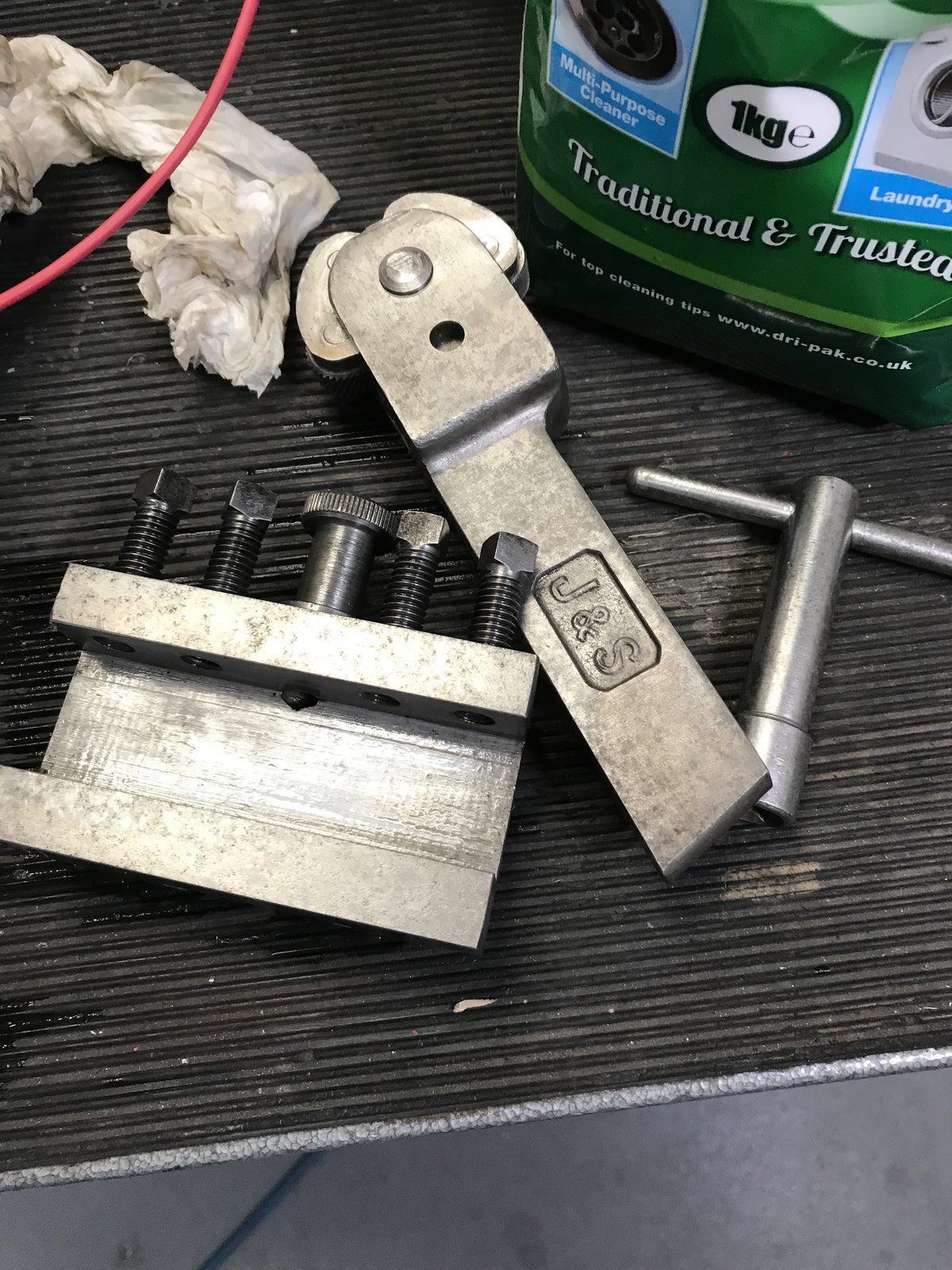

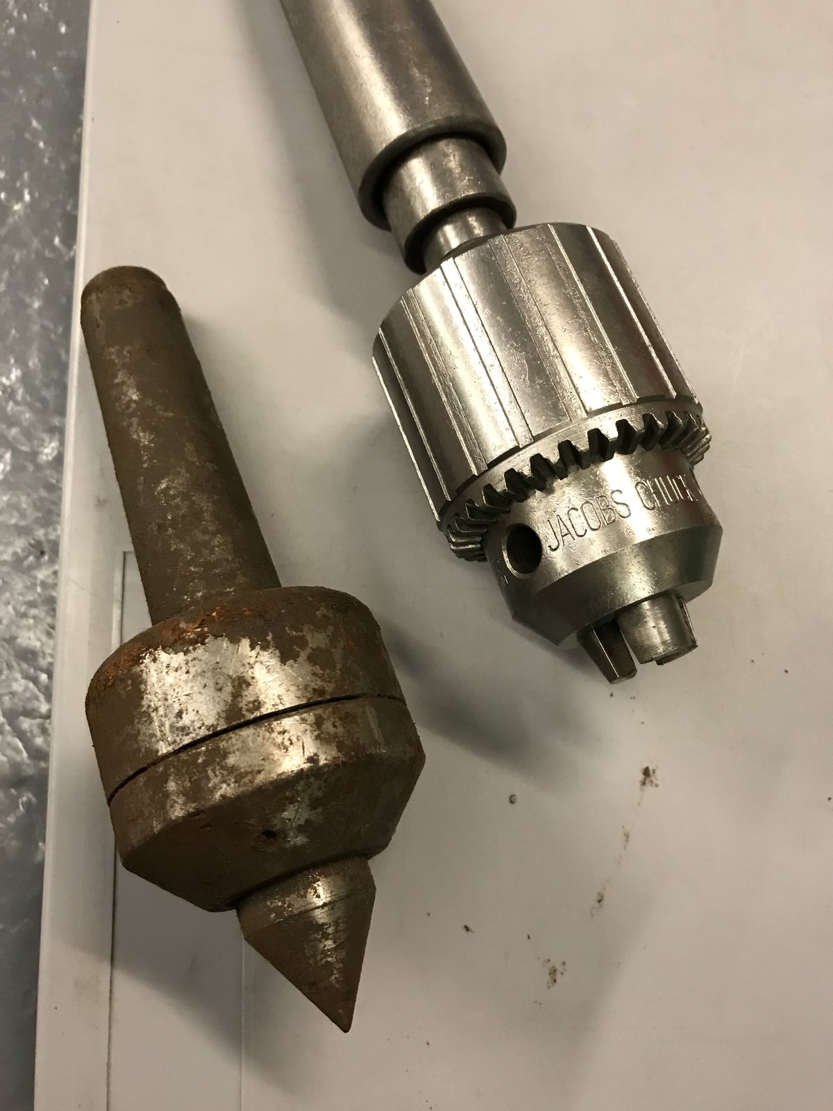

Before and after a few hours in there, and they were proper rusty as you can see..
