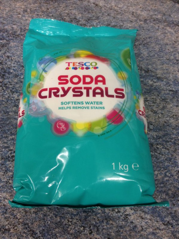

I thought sodium bicarbonate was a no no. Happy days, if it works I've got plenty of it.
