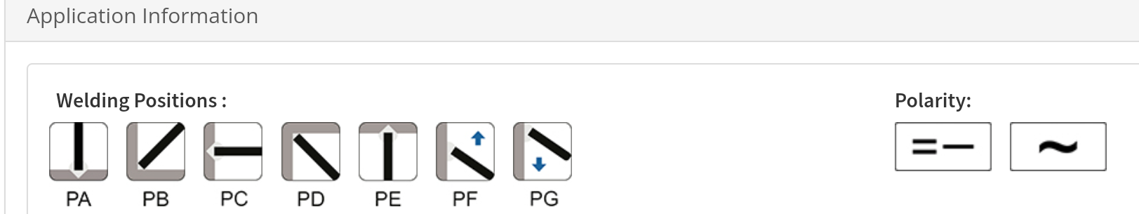

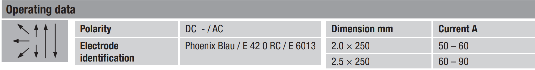

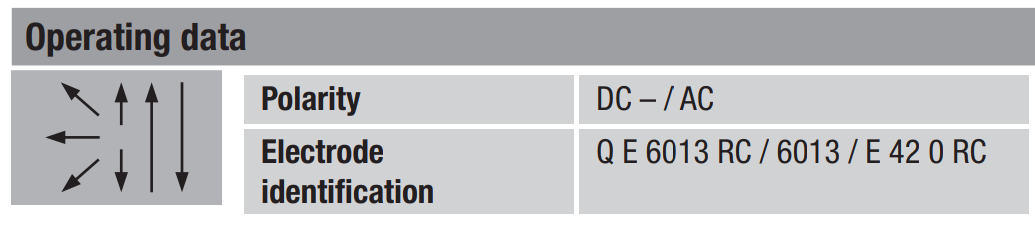

I just want to sanity check the meaning of the symbols or abbreviations for polarity, as given by the electrode manufacturer. For example the 2.0mm that I have are E6013 "Magmaweld ESR11" the label is difficult to photograph but its the same as on their online data sheet. Does this literally mean AC or DCEN only? Not electrode positive ..
That seems to contradict general advice, or is DCEP taken as read without needing to be stated?
