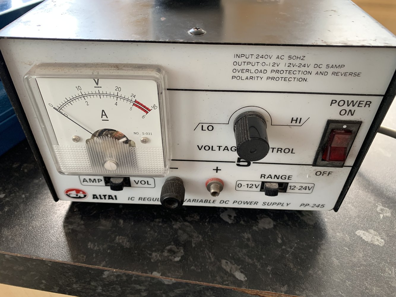

Get a known voltage and the little white slotted screw on gauge is to adjust the needle to suit..Bought this from the local tat shop it isnt giving the correct voltage output any ideas? View attachment 330565Giving about 7 volts when set on 12?
Yes gauge matches my Multi meterHave you tried measuring with a separate multimeter? Could be the gauge is wrong.
Well just had a good fiddle with my knobs and switches and it lives, must have been 30 years worth or dirt, just need a Red knob thing for the Positive connection £5 well spentSlide the Range switch left and right a few times, to clean the contacts, Chances are it selects different transformer windings for the different voltage ranges. If that doesn't help, it could be that the regulator has packed up.
