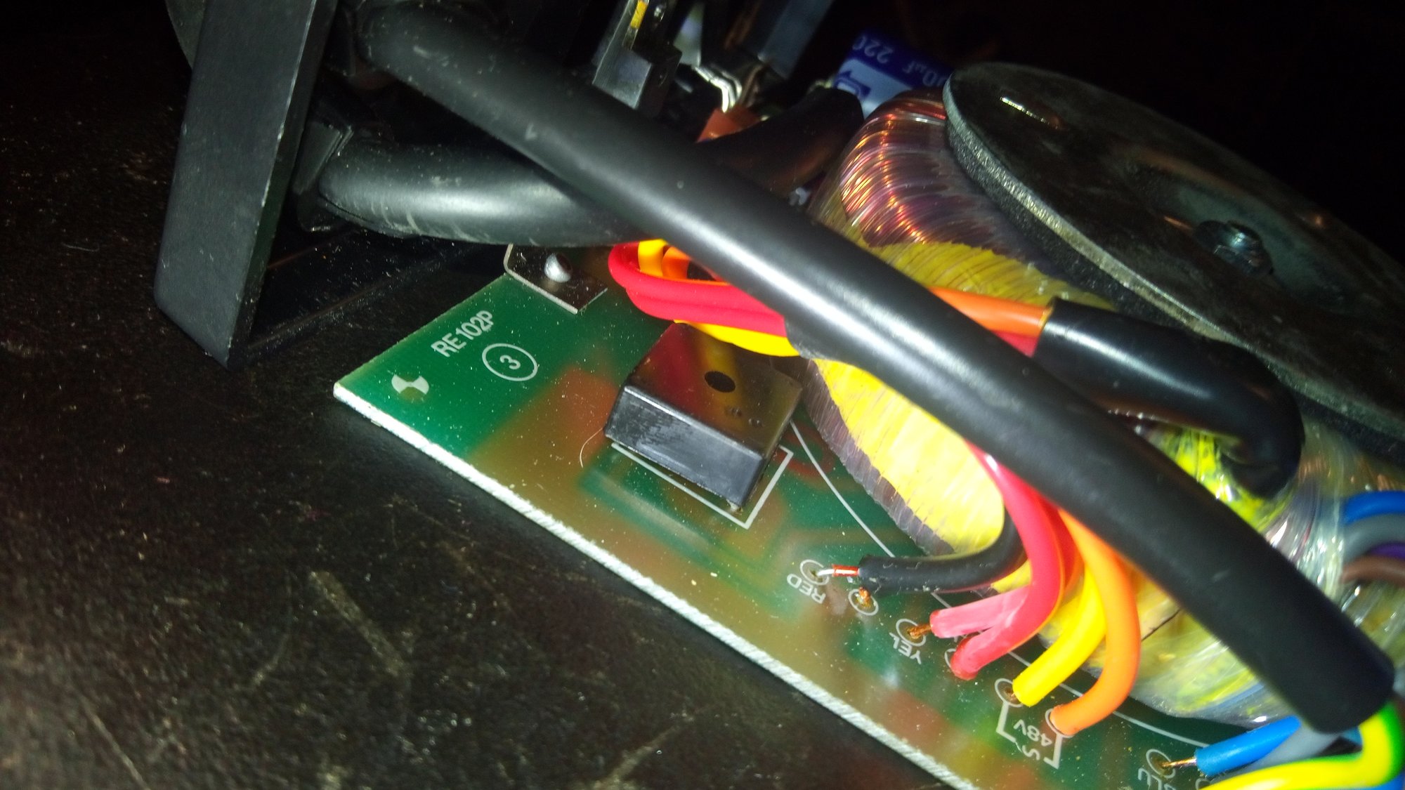

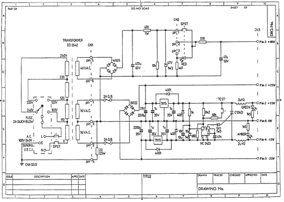

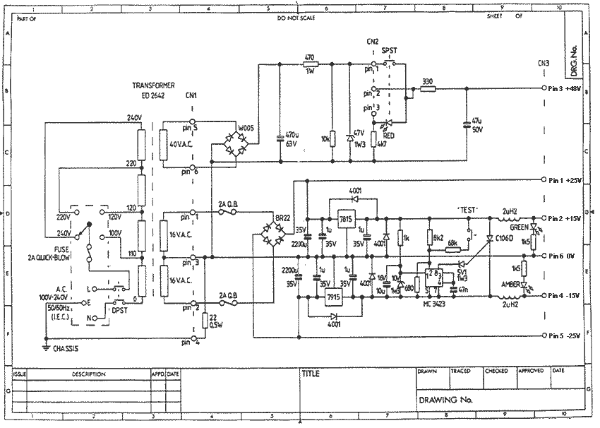

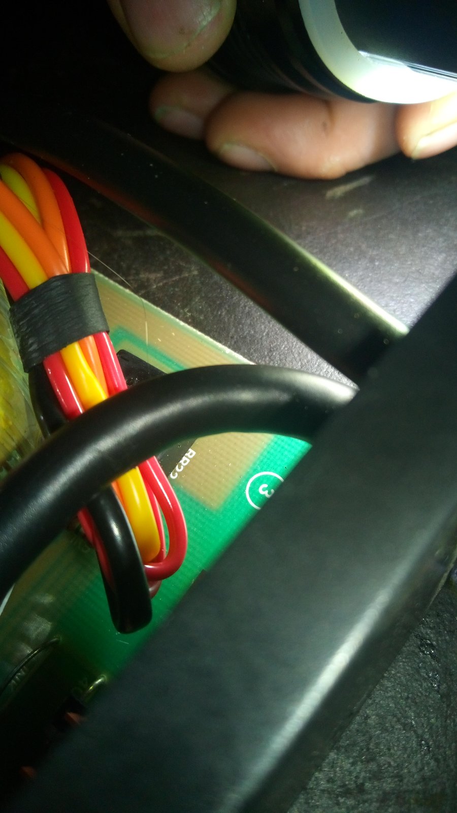

    I need to repair a PSU for an old mixer.
    I've tracked down all but one component.
    Marked here as br22
    Judging by the drawing it's another bridge rectifier like the w005 shown.
    Can't find any info on it and I'm well out of my comfort zone
    Wiring a plug or motor is about my limit.
    Any help very welcome.

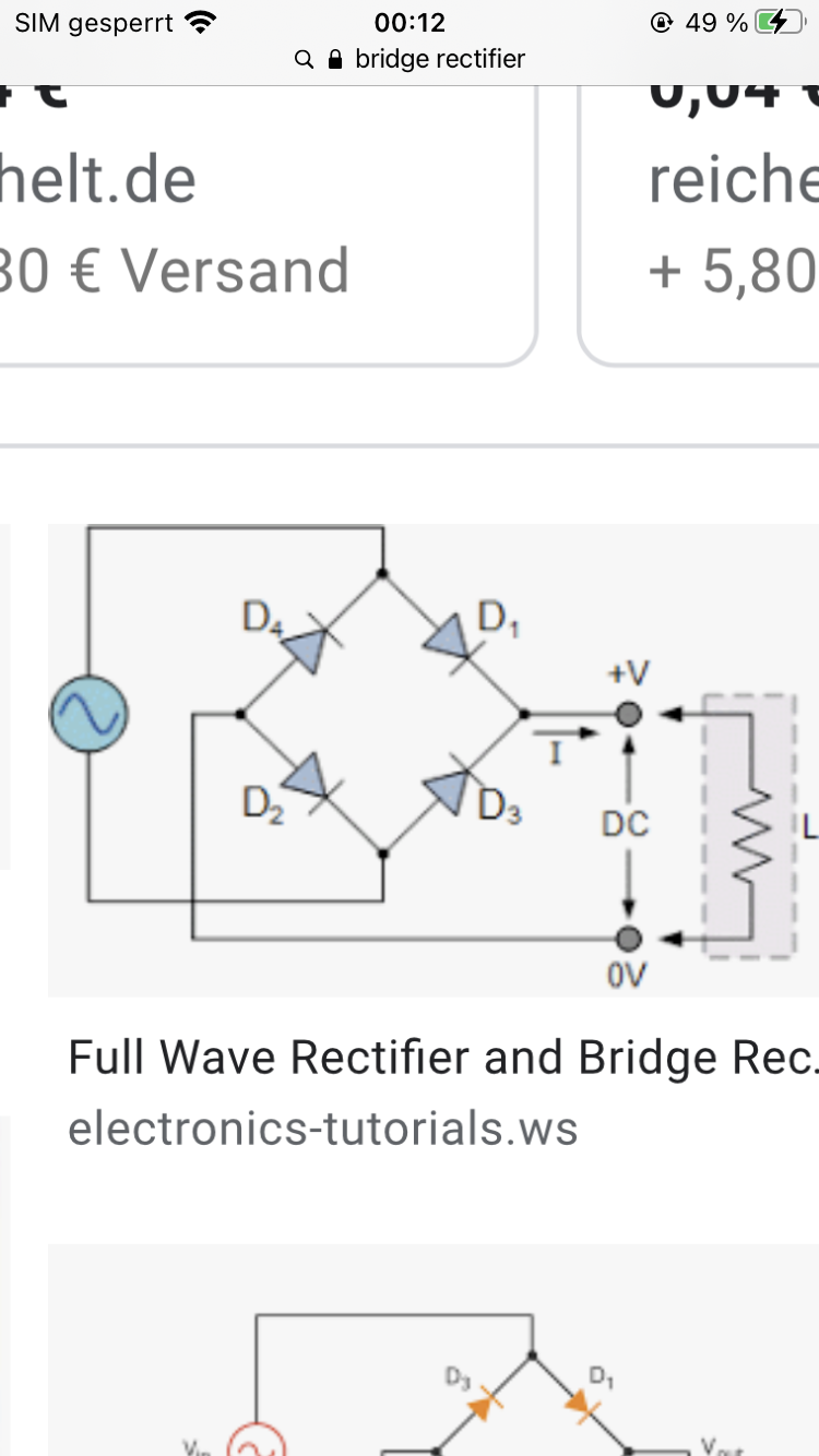

    Maybe measure it before buying one ,
    Dmm on diode mode and check 4x 0,6 v
    Plus is the chamfered corner
    More likely a capacitor

    I looked at the circuit diagram, and thought it was really complicated just to run one of these: Mixer.jpeg
    Then I realised other types of mixer are available. Yes, its a bridge rectifier, running off 32v AC.

    Thanks for confirming. Guessing it's not critical to have an exact match
    Just dimensions and input voltage?
    Memmeddu likes this.
  6. eddie49 Member
    Yes, not critical, the one linked to by a111r above, or similar, will be fine.
    eLuSiVeMiTe likes this.

    Amperage is quite a big thing, go for one that you know will supply enough current to run what's needed
