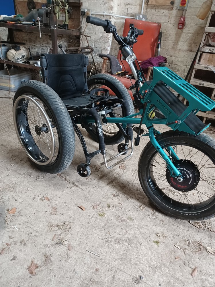

so one carbon fibre wheelchair "pantera x' current price £6200 and a davinci beach rider electric trike , the lady was quite small stature so too narrow for me
so i had a hatced a plan to utilse both
and get rid off a load of chair weght

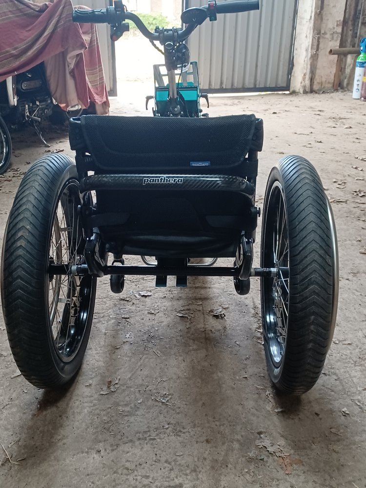

i made a widened axle out of t6 tube that runs parralelwith the original and mounts in the old wheel spindle bosses
almost there small bit of work on the front bracket to finish
i thanked the old guy for his generosity and he said his mrs only used the buggy once scaring herself s less
its 500w 36 v with uprated battery packs
good for 12 mph and up to 20 miles
only thing is i think its to be limited to 4mph or the cops get stroppy and want it mot d and taxed
we will see be great for nippin down the road to see my pal
