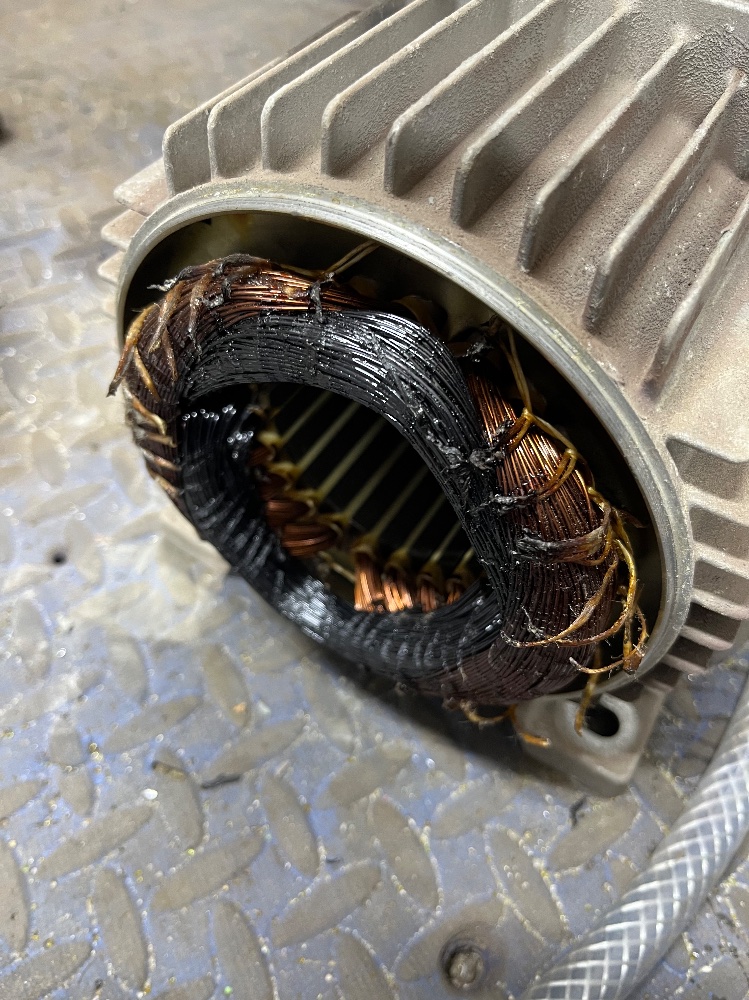

No good then.thanks folks,but safe to say my old one is fried746W to 1HP if my school physics serves me correctly?

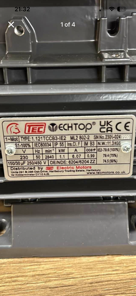

Looking at a new motor for compressor but seller states it runs anticlockwise.is this correct,if not can direction of motor be changed?

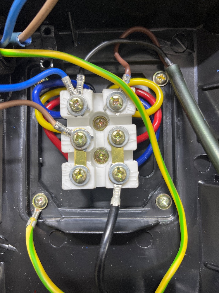

Show a pix of the connection box opened up.Looking at a new motor for compressor but seller states it runs anticlockwise.is this correct,if not can direction of motor be changed?
Ain’t ordered it yet,just asking the question before I do.Show a pix of the connection box opened up.
