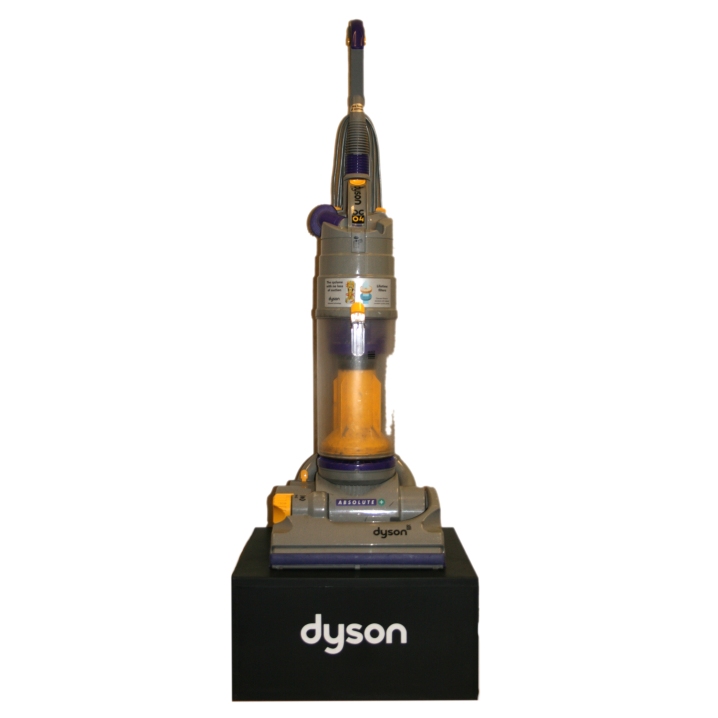

    which model do you have ?
    dc01 1st model
    dc03 with double system
    dc04 with a different style vortex
    dc07 with valves at the top
  3. jimbo84 Member
    Messages:
    452
    Location:
    Up North
    It's a DC04 Absolute.
