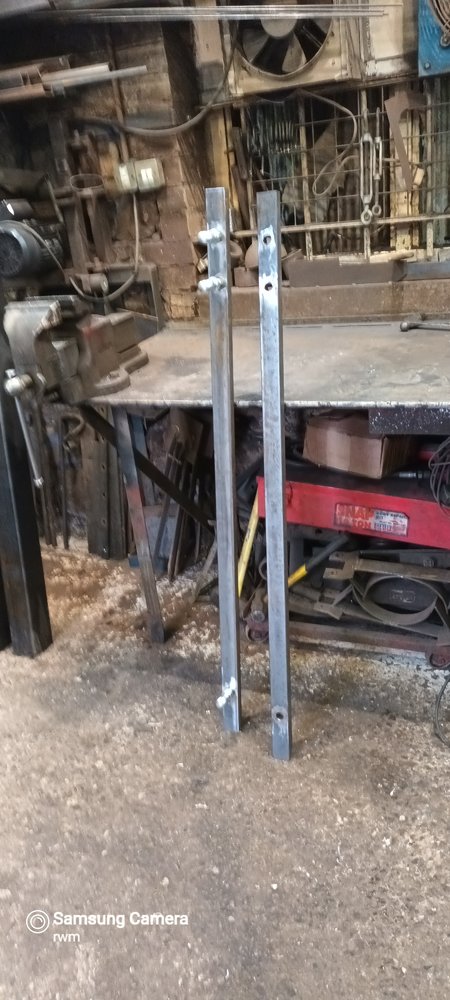

I've just started making a gate for a firm that does a fair bit of automation instalation.
They have specified that it must have 3 hinges on each leaf.
Apparently electric gates now have to have some form of saftey incase the top hinge "lets go". It could also be a wire cable or something along those lines.
First time i've heard of this.
Just something to be aware of if you get involved in this sort of thing.
