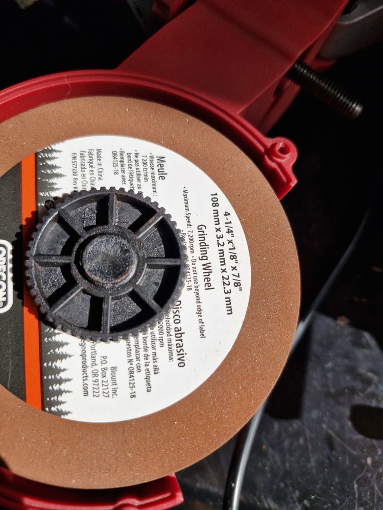

Anyway I never used the Oregon one but I suggest its worth giving it another shot. Feed the wheel very lightly and intermittently to let it take just a little bit at a time as that seems to give best results for mine.
I found if I feed mine hard, it twists and changes the angle and in effect, leaves the tip blunt.
