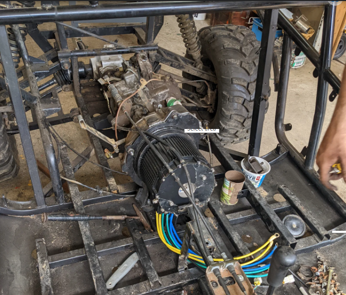

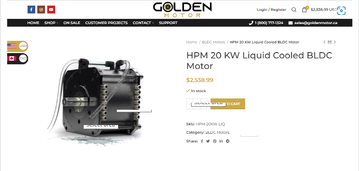

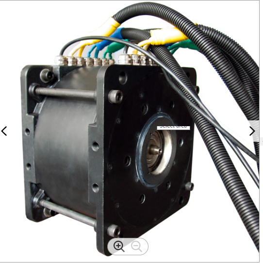

will have a looksy, im being told a 10kw will be enough but i think 10kw is 13 hp which dosent sound enough, but then im told the instant torque will make it feel like 100hp i dunno![]()

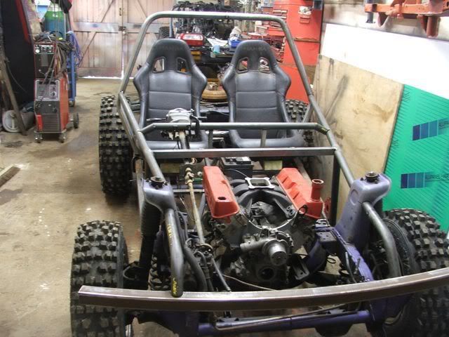

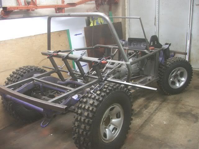

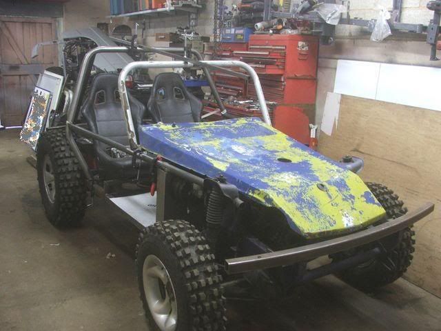

Have A look at some of the batteries from hybrids? Smaller than full EV batteries but may fit your bill. Then Theres cooling and controlling it, just pipes and wires as for the motor maybe take a look at an EDU from a motorbike and run 1 or two, that's the engine which would usually go in there, from a motorbike?are there any conversion buffs on here ? i have a lightweight buggy that requires an engine so was wondering about the viability of going electric...
its very light at 500kg without driver so add 100kg and maybe 100kg for batteries but less a cast iron engine that will be in the skip
my aims are modest no long range required its a quick blast on a sunday and put back in the garage, so its size of the motor and batteries im am trying to figure
out.........

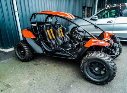

.I'm not sure golf buggies are"I'm looking for an electric side by side utility vehicle, a bit like a John Deer Gator or Kawasaki Mule,"
Oddly enough UTVs seem to have started out as converted golf buggies rather than Quads so maybe coming at your problem by converting an electric golf buggy would be easier than turning a petrol engined machine into an electric one. However if Chinese electric UTVs depreciate at the rate of their diesel engined models, wait two years and you will get one for very little money.
I have been thinking about electric quads, it is time someone came out with a decent one at the same price as a petrol engined models. Chinese seem very low powered (circa 3kw motors) The big US made machine looks good until you notice no mention of 4WD. We have a customer badly wanting an electric Quad as he has acres of solar panels on his farm buildings, but we can't get normal Quads from Honda or Suzuki at the moment, so I suspect they are not going to be making electric ones anytime soon.

Electric motors are rated for continuous duty, car engines state their max output. My Nissan Leaf is three times the weight of your vehicle and in normal granny driving I will be using somewhere around 10kW power.
Your budget and ability to source components will determine the route you go down - old school DC motor and controller with lead acid batteries, modern AC controller with lithium batteries or even using repurposed hybrid components if you are going to a full hands on DIY build and repurpose electronics.
