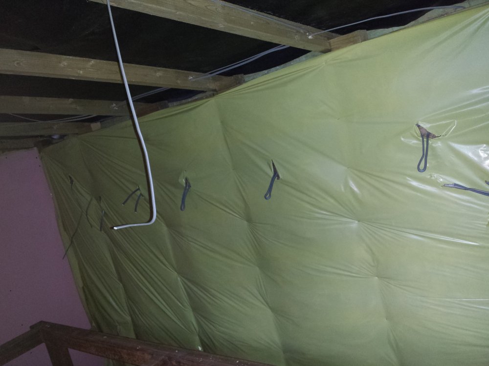

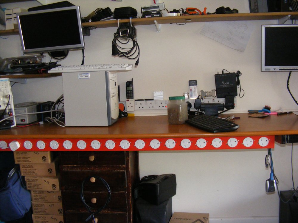

ERRRRR, how on earth are the cable routed for any of those16amp sockets, so the wiring to them is safe? The 4" fan must be directly above the left hand socket. What safe routes did you use for any of the cables feeding those sockets ?????
Horizontal? Vertical? Encased in an earthed conduit, protected by a 30mA RCD ?
Nothing looks like it would comply with 17 Edition, unless you can say why . . . .
I didn't do any of the work (and haven't the faintest clue on electrics) , but the wires pass through holes drilled in the studs, 2 seperate ones for each 16 amp, and 1 circuit for the lights/fan, I'm not sure how the 13amp sockets were done, consumer unit is pictured above.
It all works fine, and the 16 amps (when they were type b's) always tripped on starting my welder up, why wouldn't they if a fault occurred?
Rcd trips before I blow a 13amp fuse too with my welder.
The 16amp sockets used to be those switch ones, wirings just been moved up to that as the socket wouldn't cover the hole left, hence why its not dropped in from the top like the 32amp is.
All this is run on a 10mm armoured cable running to the main consumer unit in the house on a separate breaker .. so im assuming that would also trip if something really f***** up.
it doesnt show up till u put in a new 17 th edition board and trips the pair of them then have to seperate the wires and run a neutral up from the downstairs lights to feed landing light
