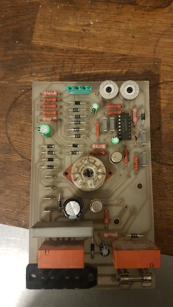

Good progress there.
I have had a similar 'step change' type fault like this ("welds lovely for 1" then goes splashy")
The cause was rectifier diode partial failure. The voltages can test to spec. fine, like yours did.
The diodes too, on the 9 volts from the DV meter's diode test function.
In operation, not so. Try heating the diodes with a hot air gun and then test them?
