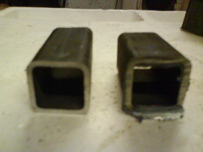

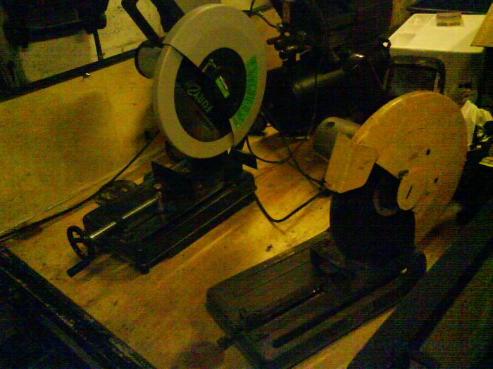

so, finally got the new aldis special evolution fury 2 saw back today and had a shot, the first thing that i noticed was that it was way better built than my normal £50 abrasive saw, it even had a blade guard! so i decided to compare!
so the photos:
1- the saws

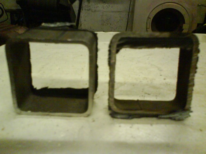

2- 25x2mm box cuts

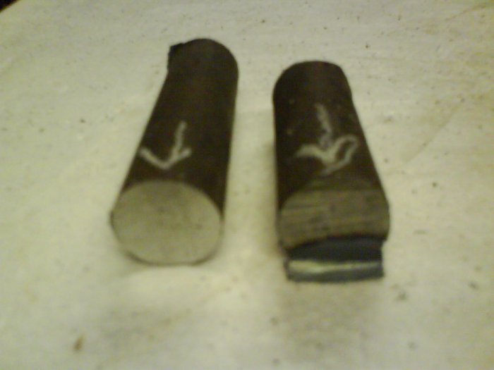

3- 20mm round bar cuts
4- 50x3mm box cuts

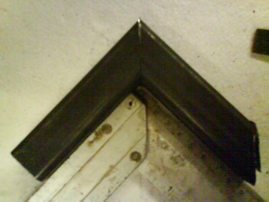

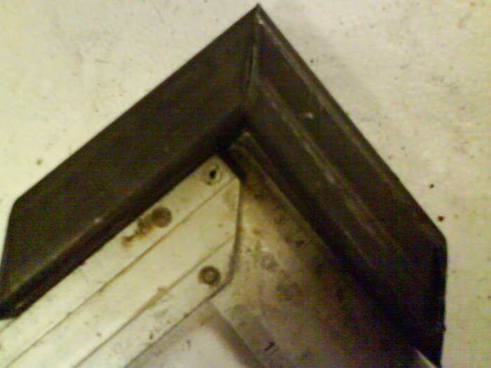

5- 25mm box angle cut with crap saw
not exactly square!
6- angle cut with rage saw
very good angles
also have to say on the photos all the ones on the left are from the evolution saw and on the right from the abrasive saw
