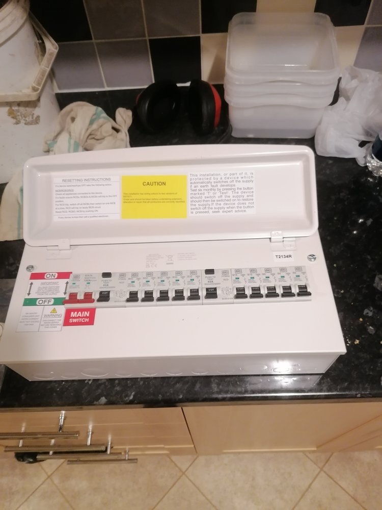

how about this one?yep them and british general .use fusebox if fitting rcbo twin rcd use bg a real good price from screwfix
yea nice unit and good pricehow about this one?
would it matter if I had 4 unused MCB's?yea nice unit and good price
thats a good idea with the 3d printing!Thanks for starting this thread. I have a EICR check on Monday and I had noticed a stray cable in the CU last week so I got a sparks in to check it. He cut the unused wire back out of harms way and spotted two things that would have failed my £240 check. He's swapping a MCB for a RCBO for me and I'm 3d printing a cover for the wires where they come out of the top of the CU.
and cut the excess buzz bar off!You could remove them and fit blanking covers.
just leave then in for further use and dont cut the bar just mark as spareand cut the excess buzz bar off!
great even better!just leave then in for further use and dont cut the bar just mark as spare
ha ha sounds exactly like mine!Mine also has 4 unused mcbs I'll do the same. Right now all the used ones are labelled and the spares are blank
volex are garbage had bother with a few of there rcd units for no reason .swapped the rcd on a few to hager and had no problemsThe mk cu is a beauty. No wonder it failed the report looking at it now...

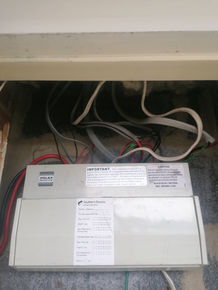

View attachment 442776 View attachment 442777
never had a problem with the actuall board all the years I lived there. that said they are carp! they aint arou nd anymore any way well not as volex!volex are garbage had bother with a few of there rcd units for no reason .swapped the rcd on a few to hager and had no problems
@Onoff
I'd just fit a Fusebox con unit, they are reliable and come with surge protection, their reduced height double pole RCBO,s are only about £17 each!
I saw that SBS had stopped trading, caught a few sparkys out!
