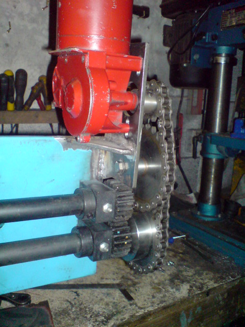

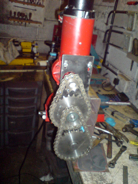

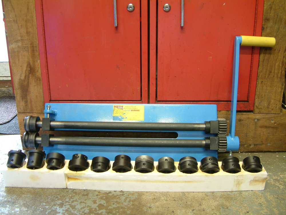

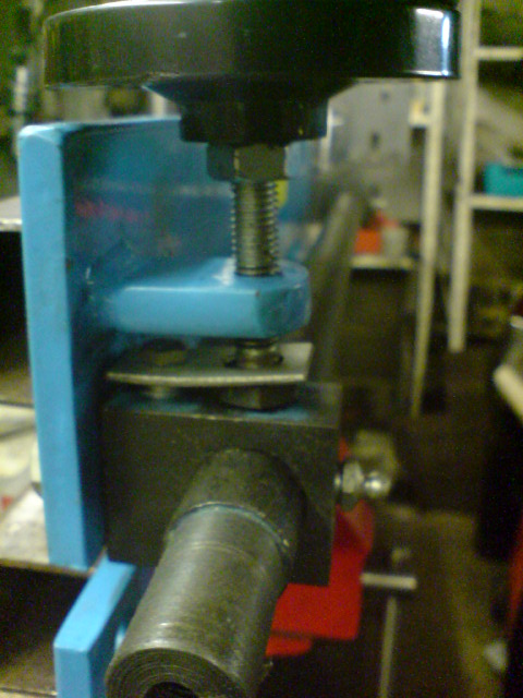

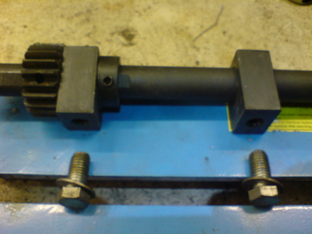

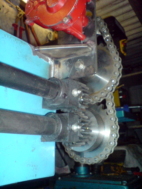

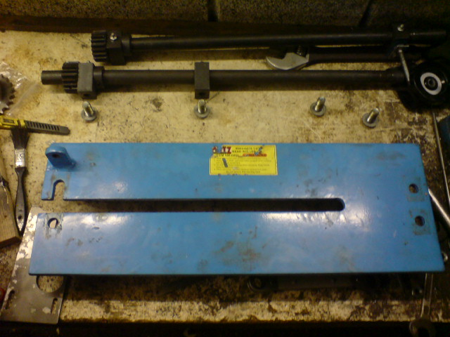

since I've done some more work on mine today, it would be rude not to take it apart and show how simple they really are.
this is as I got it nearly 2 and a half years ago

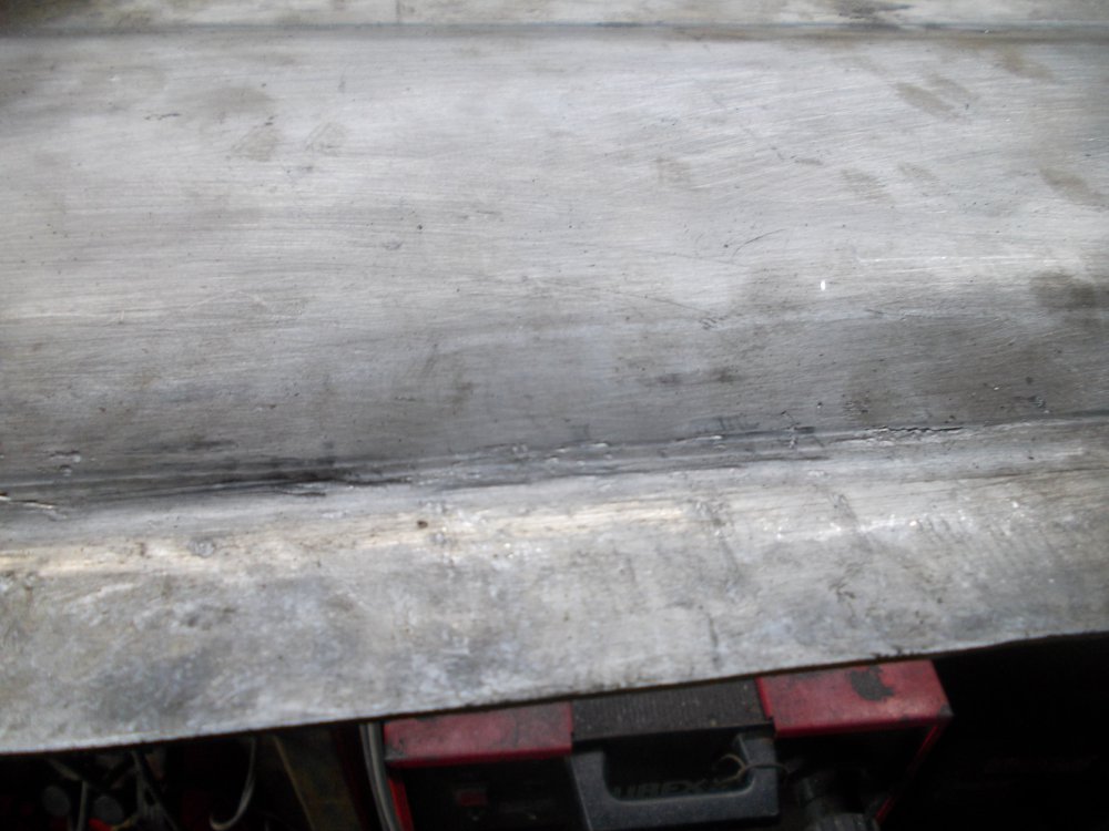

I think what can happen is while you are concentrating on following a line AT THE ROLLER you may not notice that the out feeding metal (what you have rolled) is drooping and your rolling is now reenforcing the tendency to bend down. Think I have seen a feed in and feed out table/guide attached before now to try and stop this.Just used mine and put through 2.5 mil ali to make my water pans all worked fine glad i put a foot control on it though as the ends are radius and i had to stop and start quite often to keep the job against the guide, It has given the part i made not sit flat got to sort that one yet.
To this end is there any chance of posting up some dimensions as a starting point for us to copy, length and diameter of shafts, spigots, gears and frame would be good.
I also spotted this thread about motorising a bead roller and particularly like Wendelspanswick's solution.

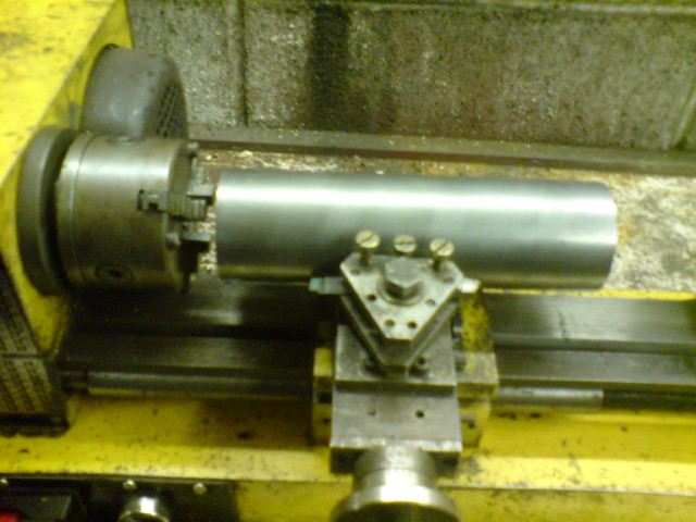

Don't think he nees any of that cos he is making that length of bar float in thin air........Do you have external jaws for the chuck? Or you could turn between centres with a driving dog welded to the job.

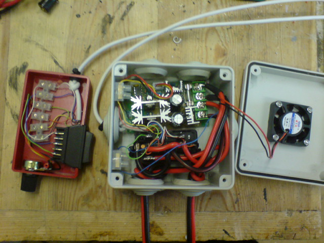

Think you motor is running to fast!!!... Ok on the straight but speed control needed on the curvefailed sorry https://www.youtube.com/channel/UCIv_U4UFf4Eu7nhLksk4ddQ
