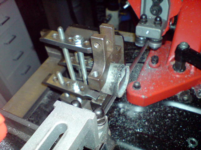

this is the mechanism for adjusting the wheel tension, there are no adjustments for alignment though

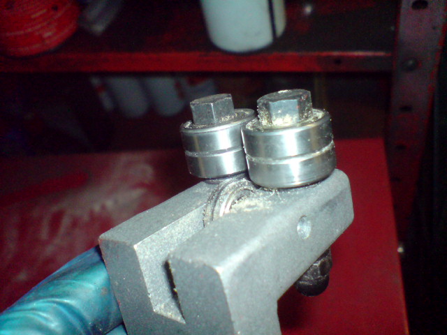

the blade guide by the driven wheel needed a bit of adjustment to run true(run vertically), the other one is non adjustable. the pivots that the bearings run in that support the blade alos needed adjusting to remove slop between the bearings and the blade.but this is easy to do as the pivots are eccentric so just need turning to do this. (don't think this is mentioned in the instructions though)

the bandsaw can cut angles up to 60 degrees,and there is an adjustable stop so its easy enough to change back to cutting at right angles on a bar.

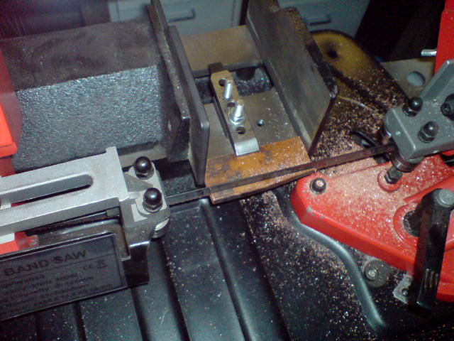

I've finally got round to cutting some metal with it now during the last week. yesterday I was cutting 60mm bar, and it does cut pretty square now
and the finish of the cut using the standard blade

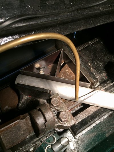

I dont have space for a full sized bandsaw so mine lives here and its about you need a space about 75cm long x 45cm deep x 45cm high to keep it in.
