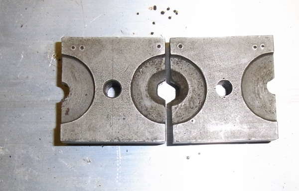

I bought a broken BICC crimper with some dies years ago, still not used it in anger.
The 10mm dies were with it, but they were wrong for my terminals. Eventually I got details
of what a crimp should be like, from one of the terminal makers, seems the crimp should be
85% to 90%[that might be wrong it was years ago I made the the dies]. I made two sets of dies.
Not tried them so no idea if they any good, I might try them tomorrow.
